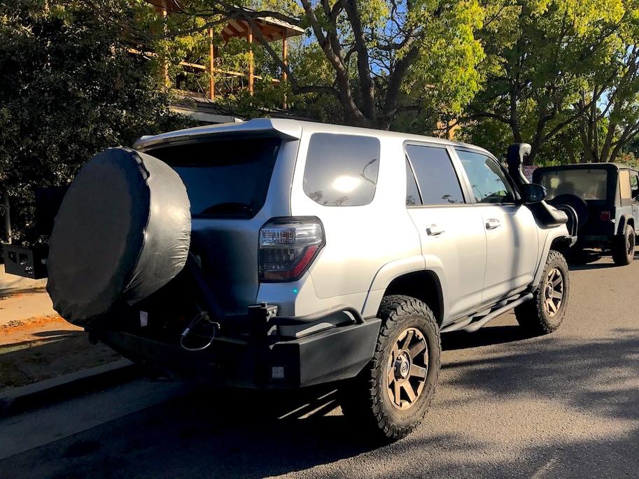

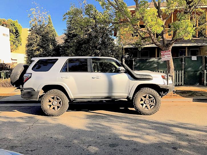

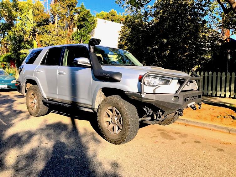

Just got mine. Makes the beast so much beastier.
