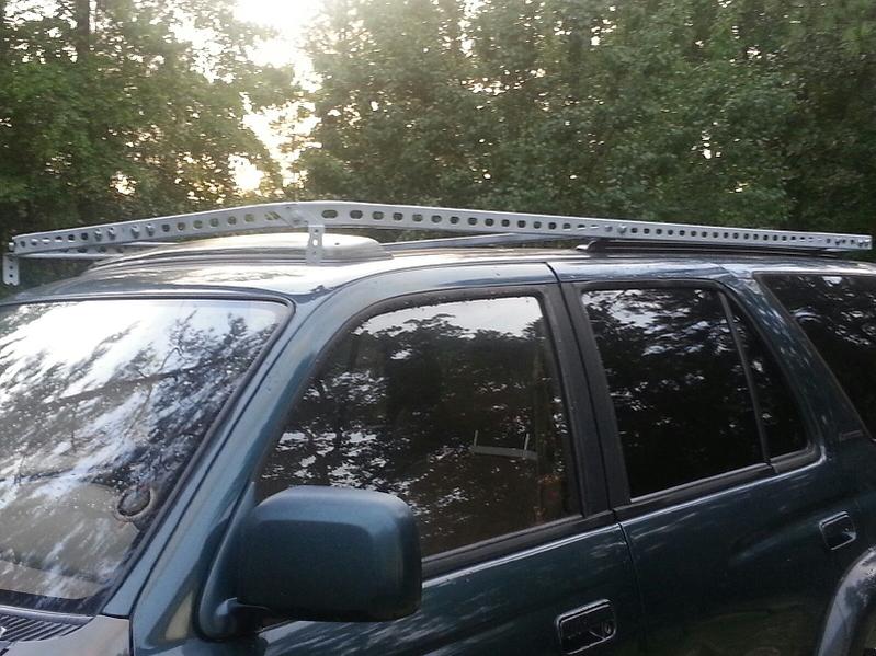

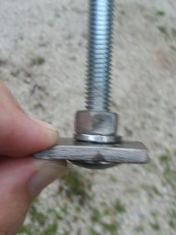

I used superstruts from home depot to make crossbars for my home built roofrack. Also, drilled some holes in flatbar that fit in the roofrack tracks. I used carriage bolts and drilled the holes in the flatbar too small on purpose. Then tapped the head of the bolt so the square shoulders under the bolt head wedged in the flatbar.

I used them for my rola rack to try and get the rack closer to the roof. Then I got rid of the rola rack and built the entire rack from super struts which I plan to have completed this week.
For the front half of the rack I used a couple 5/8" bolts with flanged nuts turned backwards and felt pad stuck on the nut to support the rack from a downward force. I will upgrade to something with a much larger surface area in the future but right now I want something to help support the weight of my lightbar.
I have a few bugs to work through this week but I should be able to wrap it up.

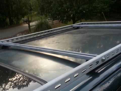

I had some rubber stock lying around that I used to lift the crossbars about 1/2"
above the OEM roof tracks. I tried laying the crossbars on top of the OEM
tracks but I believe it grazed the roof in the center. Also the rubber blocks I
used help distribute weight on the roof besides providing the lift.
These pieces of super strut crossbars will fit between the slats in your rola
rack and catch on the smaller diameter tube running the length of the rola
rack. I think I cut my crossbars to 44" (Just a FYI).
Super struts are about $16 each at home depot however you can only get 2
crossbars per stick. I would probably run about 4 with the rola rack but you
might could get away with just 2 like I have with my current set up. It's still
in the testing stages to see how it performs with some wind resistance.
This is what I have sitting in the track. I did need to grind them down so they
would slide in the track freely.

Does that rack fit in between the roof rails??? From the photo it looks like it does perfectly but its hard to tell. Those carriage bolts that cj80cruiser used look like they would work if you just drilled holes in the rack and mounted it directly to the stock rails. Very interesting.
