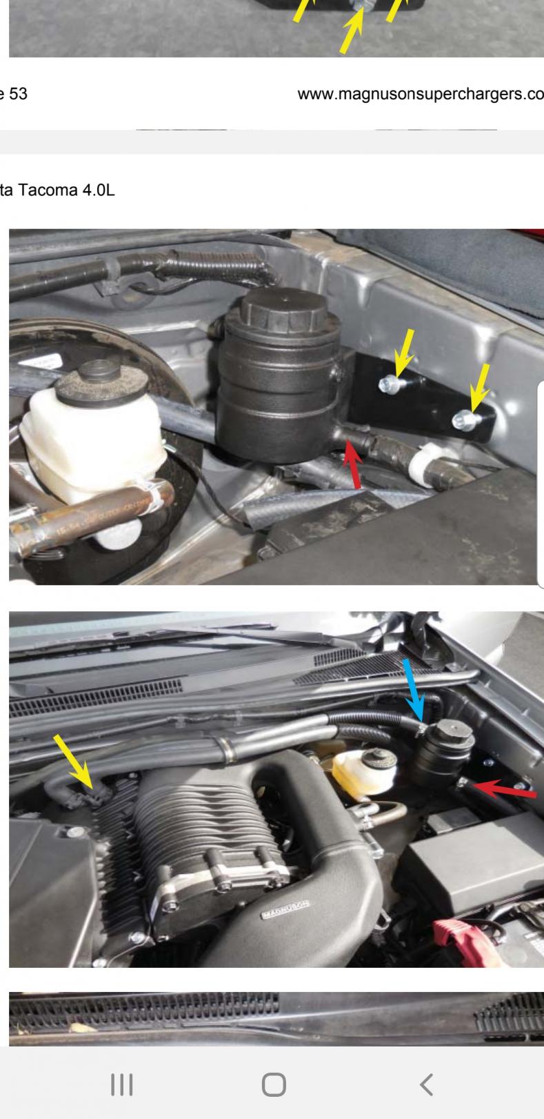

I'm also curious if anyone has ever relocated the intercooler reservoir located on the driver side near the brake fluid reservoir? I want to install a compressor using one of various brackets on the market yet the intercooler reservoir is in the way.

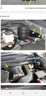

I searched other Toyota SC installation instructions and came across the 2005-2015 Tacoma 4.0L version. This one uses body mount holes instead of the brake lift for the reservoir bracket. I believe the 4runner also has the holes. I can't seem to find the bracket anywhere to buy though.
Try sending an email to Magnuson, they may sell you that mount. I’m gonna do that as well so I have more space in the future for a switch pro. Right now I’m more concerned about the winch and how much clearance I’m gonna have with the C4 Lo Pro :noidea:
Are you trying to relocate the pump or the reservoir??
