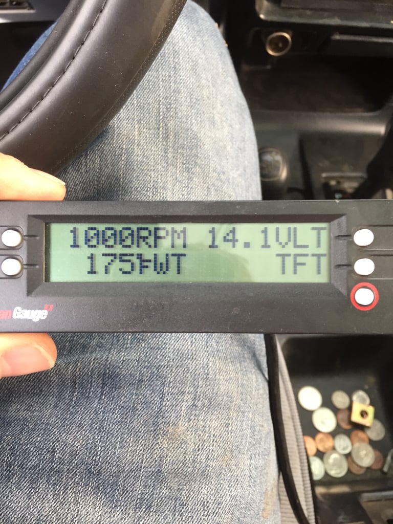

Anyone know why my TFT wouldn’t be working after entering the code?
Oops wrong thread but maybe I’ll get an answer. Could it be becuase the tranny temp isn’t high enough yet? Trucks just idling and hasn’t been driven in a month as it’s in jack stands
Is your truck a '96-'98? If so, it won't report it. What did you enter for the XGauge code?
-Charlie
-Charlie
Yeah, mines a 1996. I put in the codes that are in this thread
Is there a way to get the XGauge to work with a 1996?
Edit: just read alittle in this thread and sounds like I’m sol on getting the XGauge trans temp to work.
Need to figure out a way to get a trans temp gauge in my truck.
Any suggestions?
