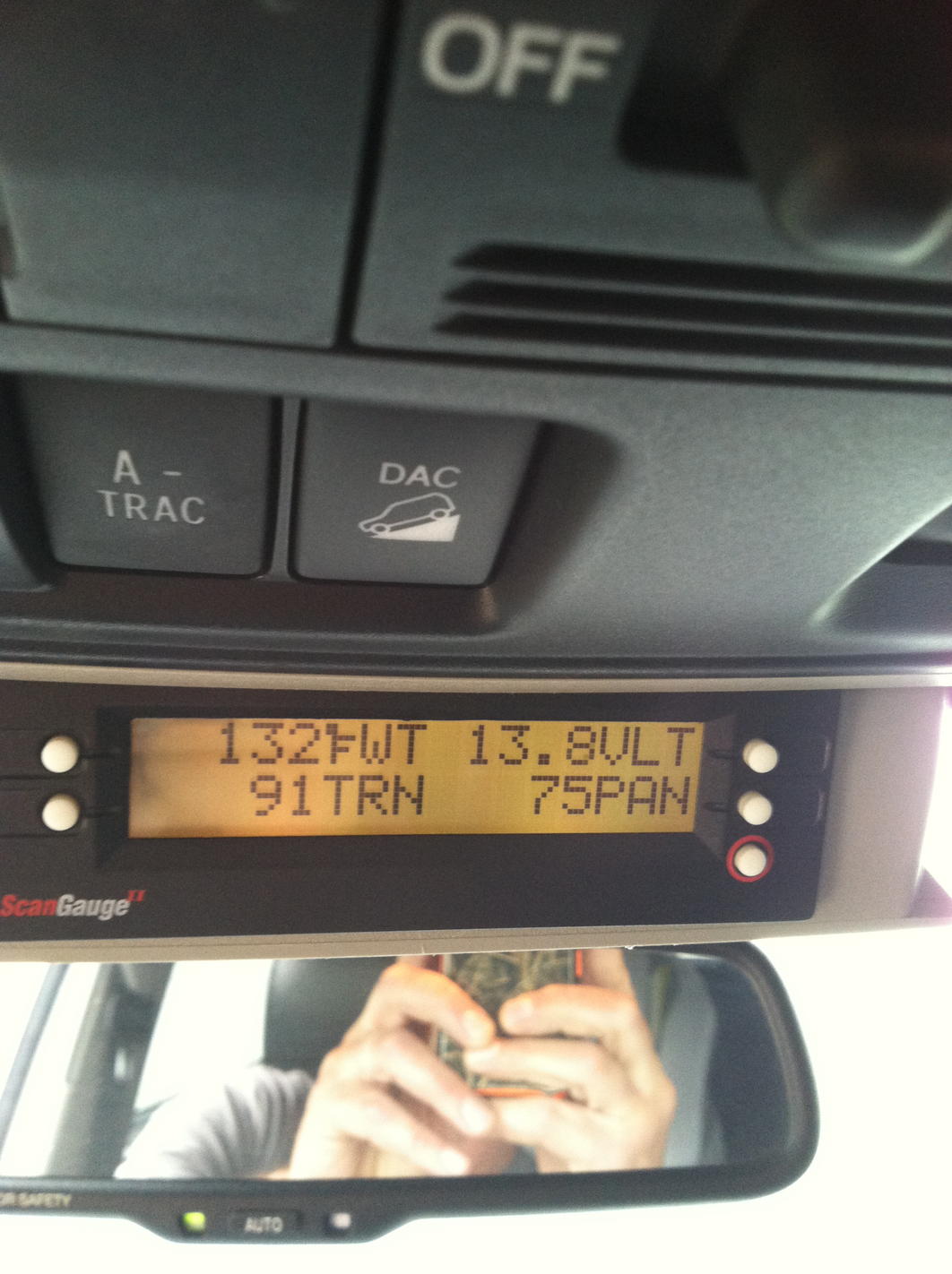

Thanks guys! Here's a pic- bottom number value shows the reading at the converter as I revved the engine in "D" with the brakes on. Notice the temp spike, which went from 75 to 91 in about 3 seconds. Bottom right shows the fluid temp in the pan. Much more consistent.

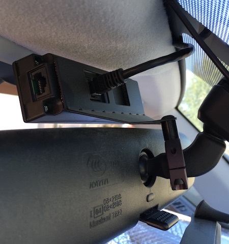

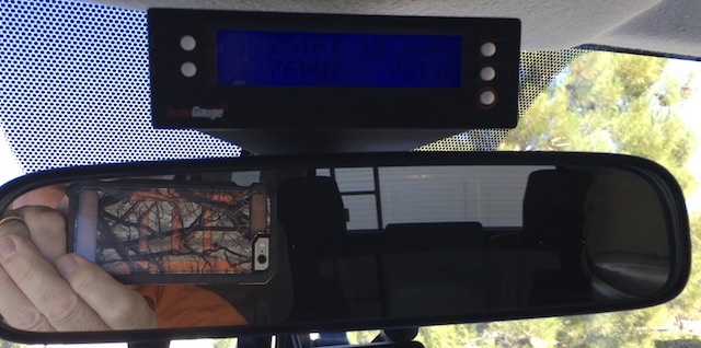

I need a new place to mount mine, where does everyone have theirs?
I had mine velcroed to the headliner above the rearview mirror, the velcro is strong enough but the headliner fabric itself is not enough to hook to and its started to fall off on rough roads
