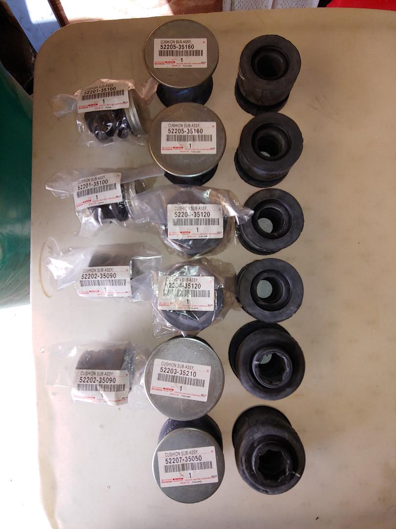

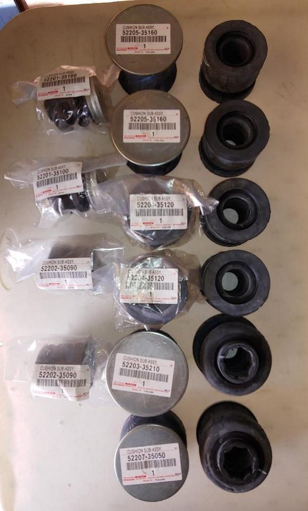

I highly recommend changing out the body mount bushings when you do the BL. They're like having a pair of Dr. Scholls under there. You'd be surprised how much they soak up. Tried to post a picture of them but It's not showing up for some reason. This site has not been friendly to me lately. [MENTION=66389]BlackWorksInc[/MENTION]helped me out with an overseas source he found- Partsouq.com. They were really quick and a good bit cheaper. I think this is the right page.

Was this your pic? I saved for future repairs. Hmmmmm? that thing wont post to the site...Take that you... had to resize it....wtf, worked one time then no... this site SUCKs!

Did you buy OEM's or the Febest alternates?
I'm pretty sure they're OEM. Here is a link to the picture with part #s. I posted it months ago, but the site wouldn't let me repost it on this thread. Post# 30.
