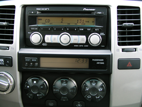

Just finished installing the T1808 in my 2008 SR5 that I picked up off Craigslist for only $35. With the help from this forum, it took well under an hour and some of that time was spent detailing the parts that came off. The sound quality is WAY better than the factory HU (11823). I have the IPod cable on order and will install that once it arrives. Not the best of picture as my camera batteries were dying.

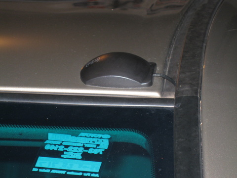

I just installed a T1806 head unit and also installed the Terk XM unit and the iPod connector so I can control everything from the head unt. It is great not having any extra cords! My aux input in the console works as well - didn't have to do anything to it! For the XM antenna, I ran it through the firewall and tucked the cord under the driver's side windshield gasket and mounted the antenna on the front driver's side roof. I'm happy with how it turned out!

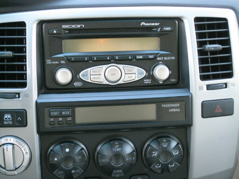

Here is a picture of the T1806 - and no cords even though I have XM satellite and iPod connection!
