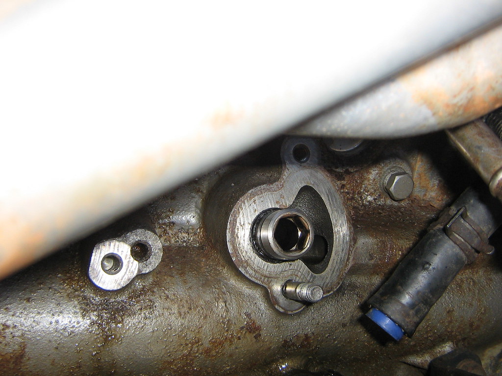

So I'm driving home from work one night around midnight & my oil light comes on for the first time ever & I'm like WTF!? I pull over & check the stick & see no oil. Luckily there's there's a bunch of 24hr gas stations along Rt.17 in N.J. & it took 3.5qts. Nothing was leaking out the bottom so I drove home & put a big piece of cardboard under the engine. The next morning there was nothing on the cardboard, strange? Drove it to & from work for a few days checking the oil level & all looked fine. That Sat morning I got under the truck & noticed that the oil filter was soaking wet, I figured that I didn't tighten it enough or forgot to lube the gasket. I only started doing my own oil changes in 2015 & assumed it was my fault. I tightened the filter, wiped it down clean & drove it for a few more weeks checking my oil level everyday. The level was going down very slowly & the filter was wet again. I decided to change the filter because that looked like the problem plus the oil had 2 burnt qts in there with 3 good ones and what ever I topped off with along the way. I was using Wix filters at the time with whatever name brand was on sale, Quaker State, Valvoline etc. So after a few weeks & my oil level was still going down slowly, my filter was wet & still no drips in the drive way. I guess it was only leaking when driving. I Google searched this site & found nothing, there's not much 3RZ stuff here anyway. Then on a WWW Google search I found one small thread over on Yotatech that lead me to the Oil Filter Housing or Oil Filter Bracket, it's called both. According to the interwebs I was only the 3rd person to have this problem! LOL OEM Toyota parts last! It seems 16 years is around the limit for these o-rings & gasket because more 3RZ's are needing these replaced lately. Googling "Oil Filter Housing" or "Oil Filter Bracket" brought me to some really nice pics over on LCE's page so I could see what I was dealing with. OK, I really wasn't expecting to write a book, sorry. On to the pics.
This is how the housing bolts to the block. I bought an assorted bag of silicone plugs for the coolant lines. They also work for plugging brake line's & are heat resistant enough for powder coating.

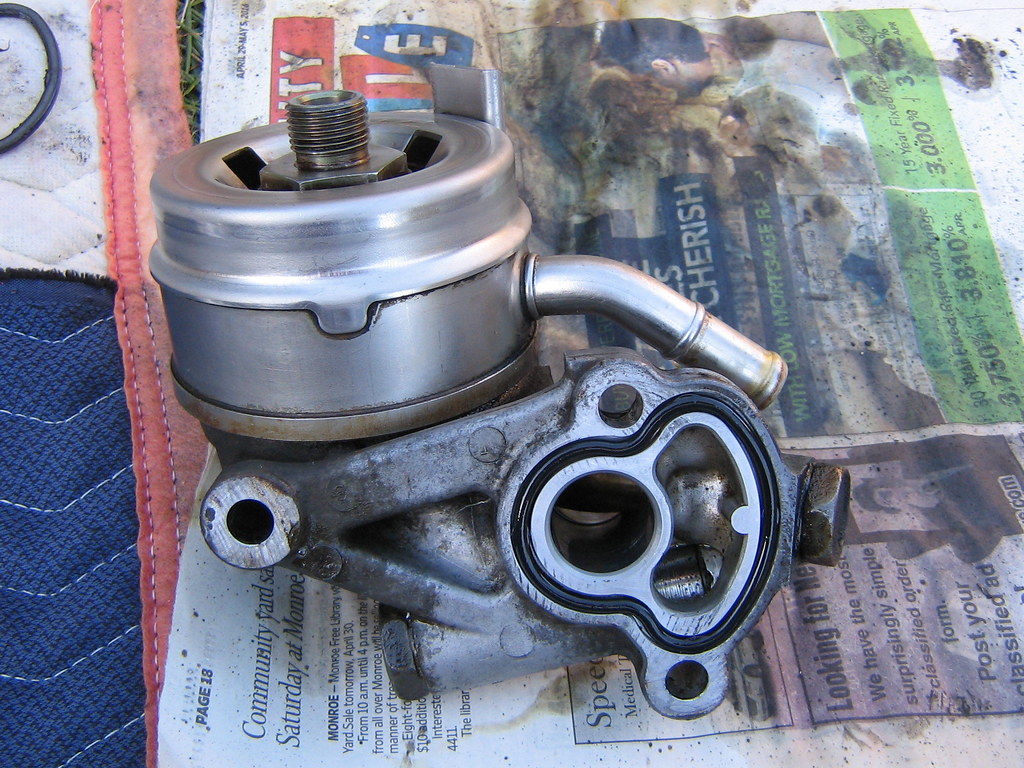

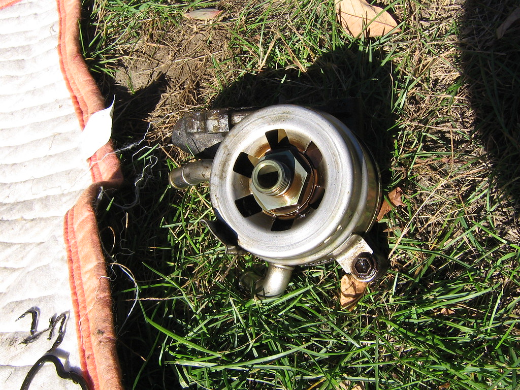

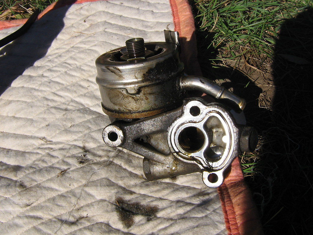

Filthy Housing removed.
117 by Mike Campbell, on Flickr
118 by Mike Campbell, on Flickr

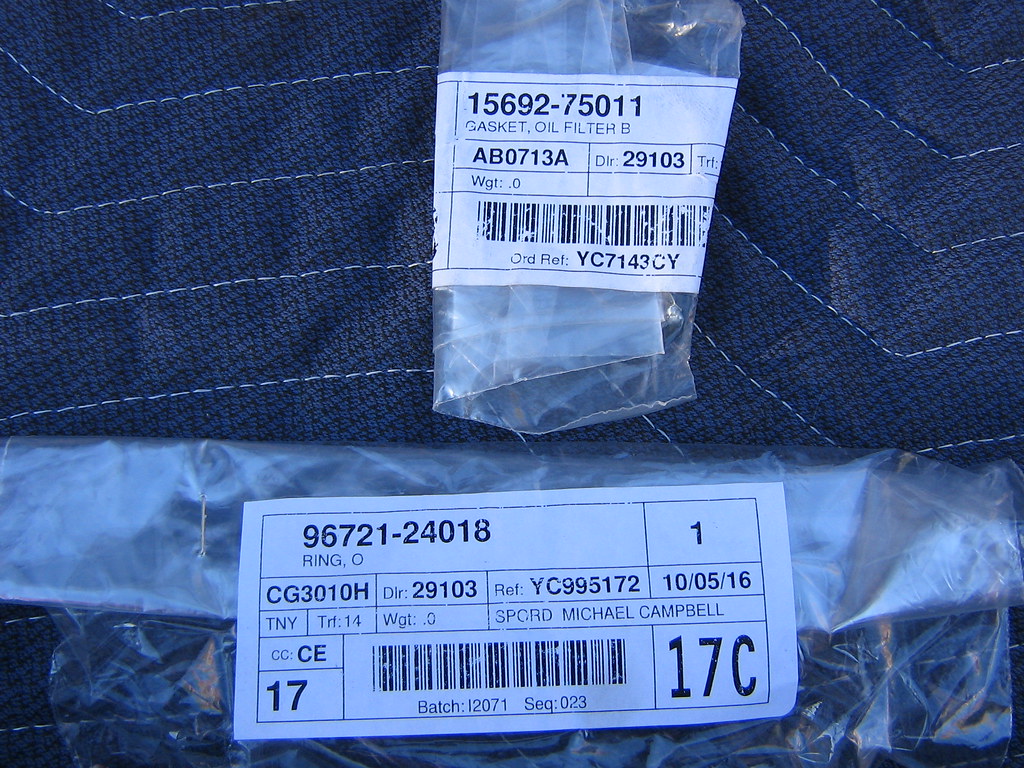

O-ring & Gasket part#'s.
119 by Mike Campbell, on Flickr

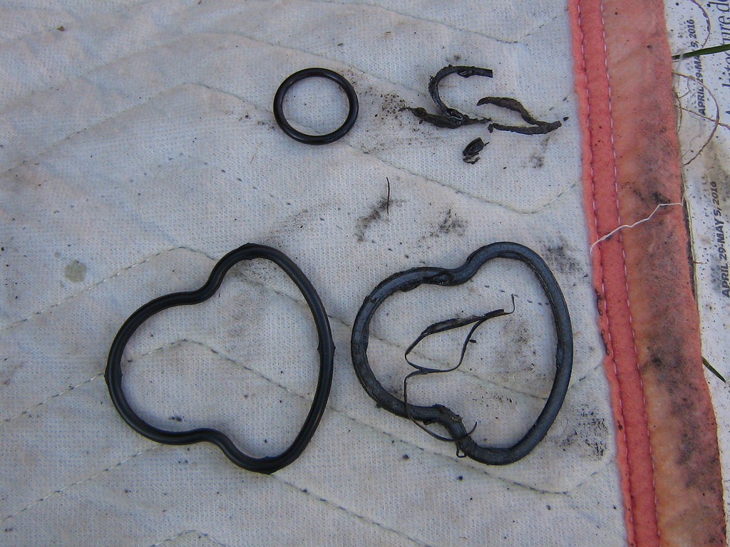

Old vers New.
120 by Mike Campbell, on Flickr
Cleaned up & ready to go back on.
121 by Mike Campbell, on Flickr

Is there any kind of gasket between the cooler (the cylinder) and the cast base it is connected to (that bolts to the block)?
Congrats! You're the first person to quote a bunch of pics in my build! Please delete.
I'm not sure, I didn't take it apart. See that big nut where the oil filter screws on? Loosen that & they should come apart. I would crack that nut while the housing is still on the block. I tried to do it in my hands but it was too tight. Or you could stick it in a vice.

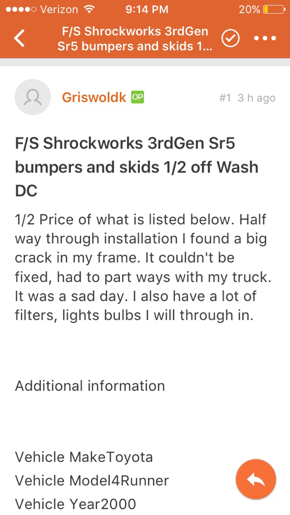

If he is serious about half price, that is a $450 rear bumper.
I would ask shrockworks if they would sell just the swingout since you are a previous customer as well

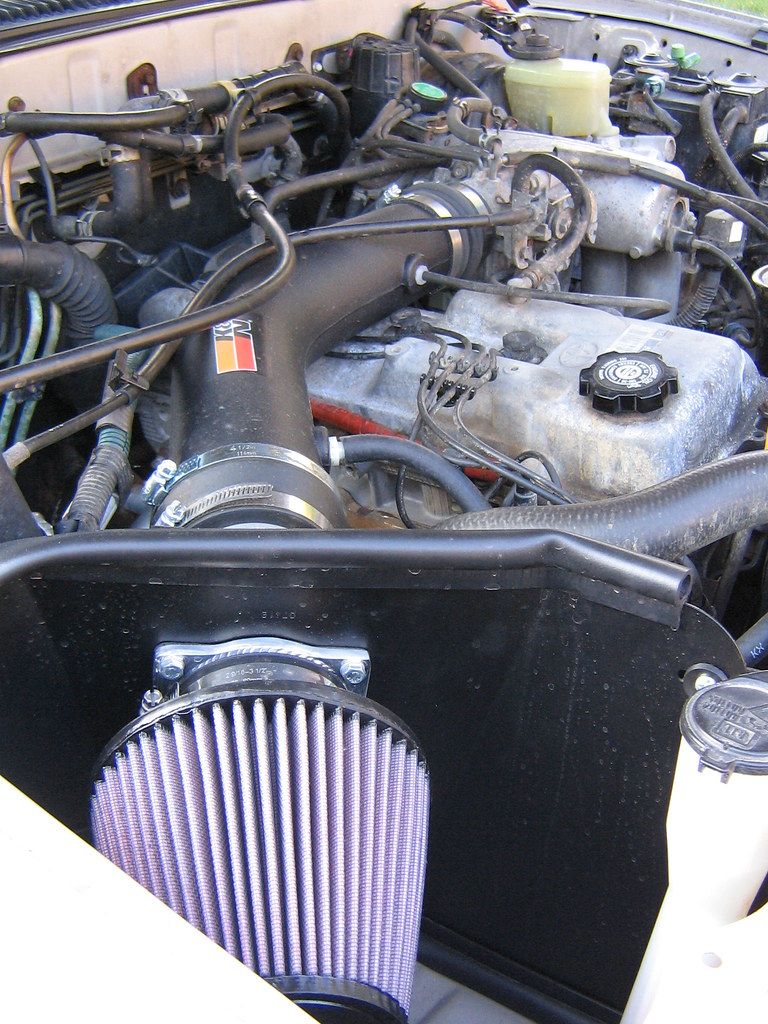

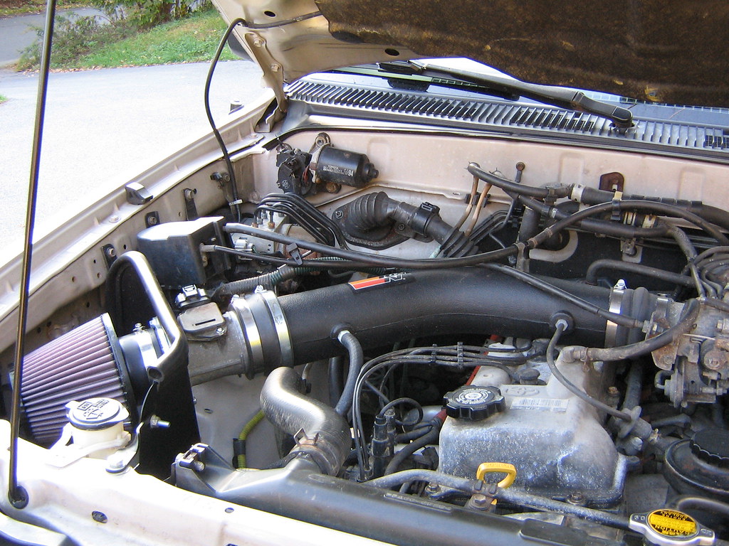

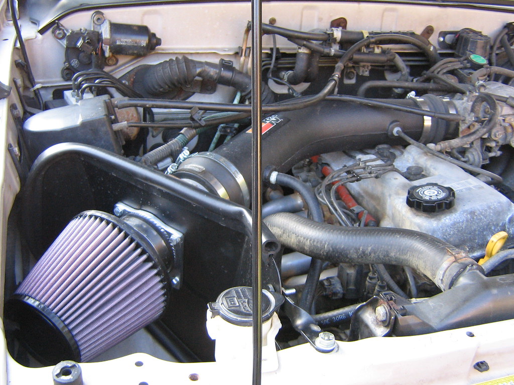

I picked up a K&N cold air intake from [MENTION=86041]Mc1337sauce[/MENTION] for a very good price. It was missing a few parts because he used them for his Turbo build but he was very specific on what was missing & was easily picked up at the hardware & auto parts stores. I also cleaned my MAF & Throttle body for the first time.
123 by Mike Campbell, on Flickr
124 by Mike Campbell, on Flickr
125 by Mike Campbell, on Flickr

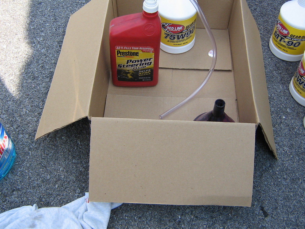

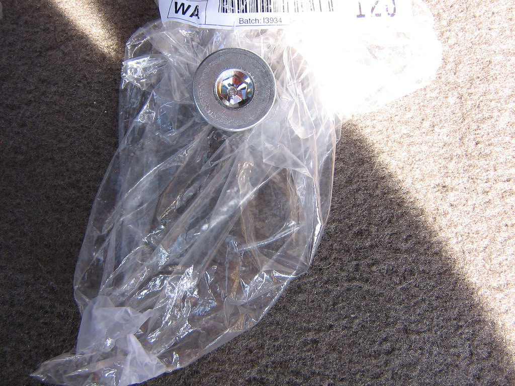

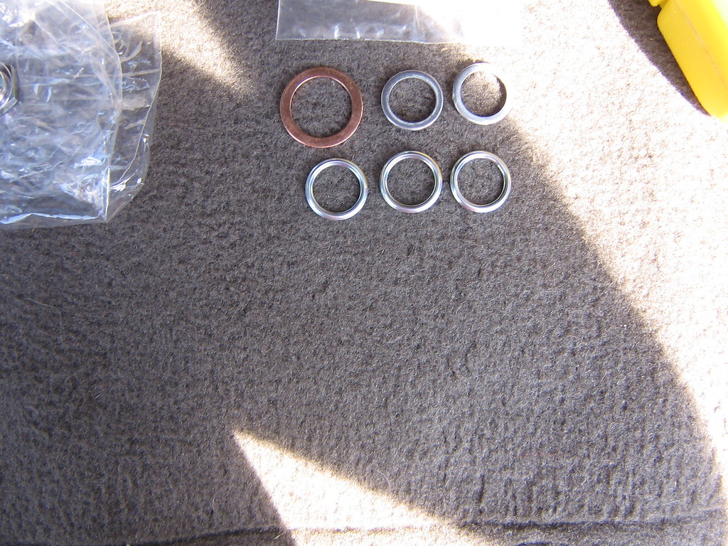

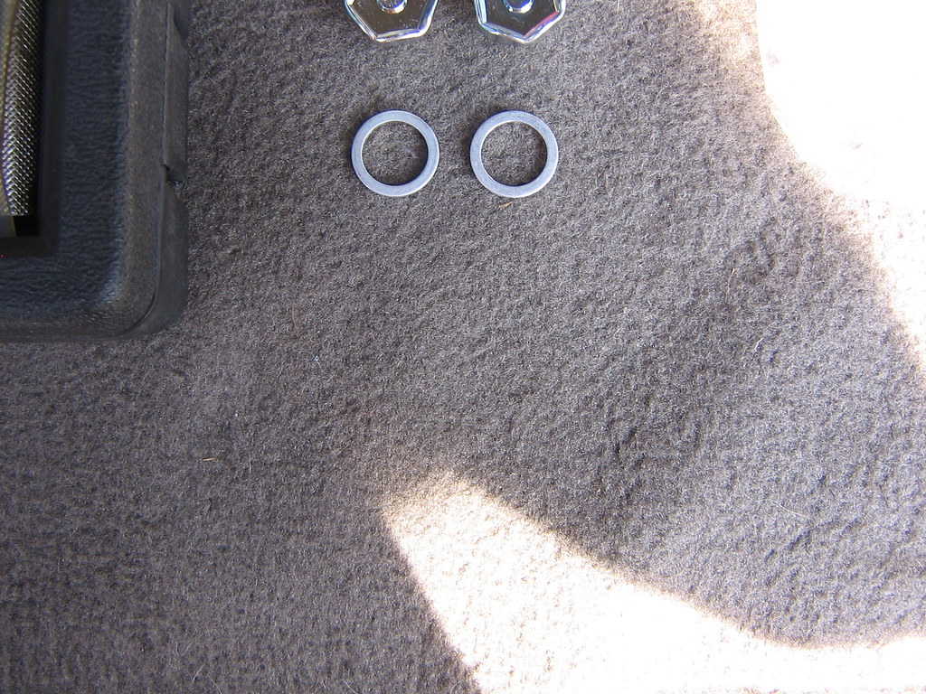

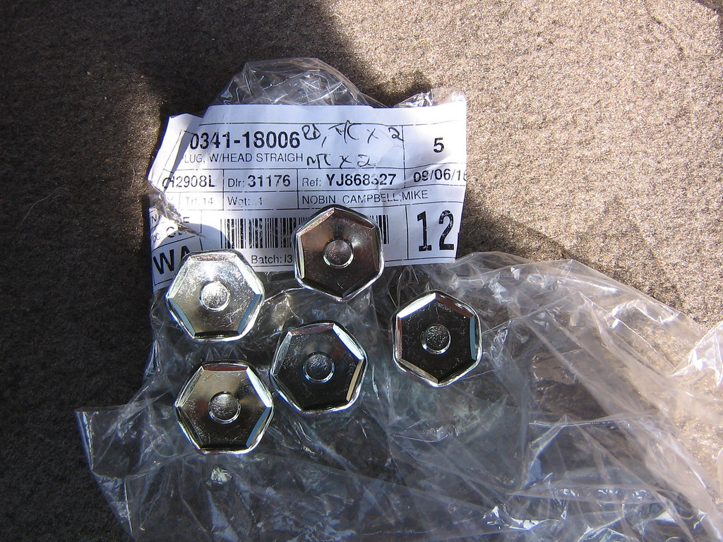

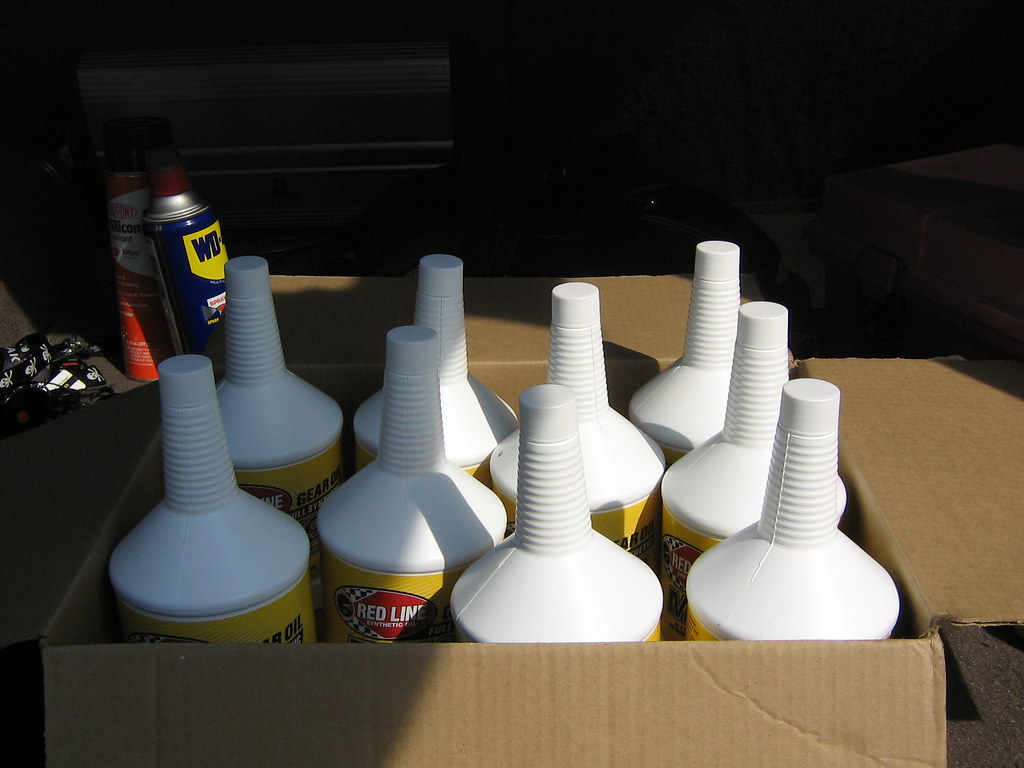

Shifting into 1st gear was getting a little sticky so after reading a few threads on the subject I decided that switching to RedLine MT 90 would be my first shot at fixing this. And it worked, it's been shifting fine ever since. Smooth as butter. I also checked my maintenance records & realized it's been a while since I did the TC & diffs too. Around 60K miles over due. Had them done at 30, 60 & 90K. Life was a lot easier when I lived on Long Island. I had a good mechanic down the block from work & would drop it off my on my lunch break & then pick it up at 5pm. I gave him the Toyota book & he would perform all the scheduled maintenance. When I bought a house upstate & had a long commute into Manhattan life just wasn't as easy or organized. LOL But now my job is a shorter commute & you fu@kers have me doing all of the maintenance myself!

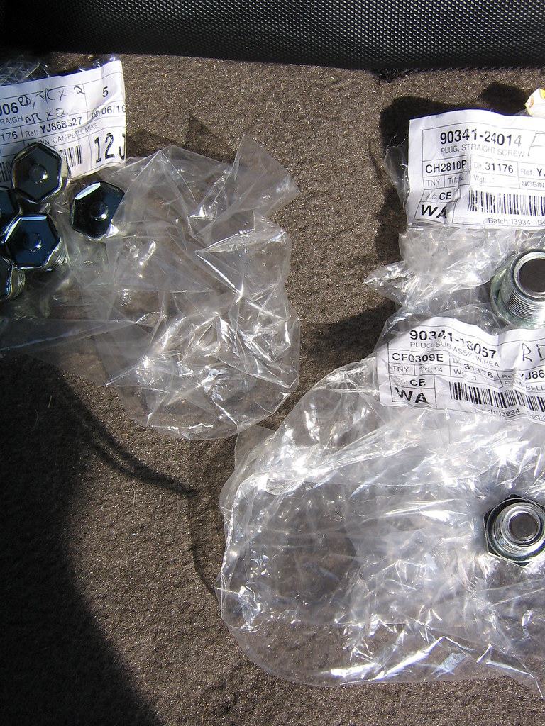

Almost everything you need is on Amazon except for the 2 MT crush washers & the fill & drain plugs. I bought all new drain & fill plugs because of the rust horror stories I've read on here but they all came off easily. The only one that was a little difficult was the front diff drain plug but a breaker bar took care of that. I did hit them all with WD40 a week before I started & then again the night before.
6 qts RedLine 75-90: https://www.amazon.com/gp/product/B000CPCBF0/ref=oh_aui_detailpage_o05_s00?ie=UTF8&psc=1
1 Metric Hex Bit Socket Set: https://www.amazon.com/gp/product/B00431HNWA/ref=oh_aui_detailpage_o05_s01?ie=UTF8&psc=1
3 qts RedLine MT 90: https://www.amazon.com/gp/product/B000CPCBEQ/ref=oh_aui_detailpage_o05_s02?ie=UTF8&psc=1

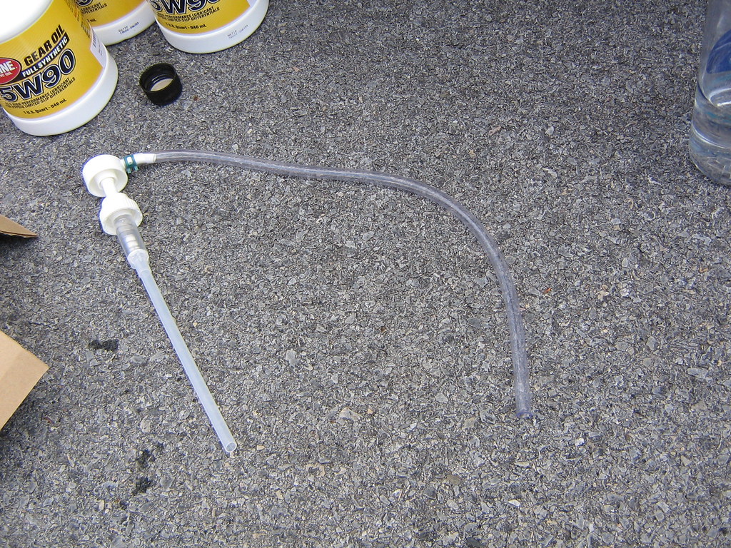

1 fluid pump: https://www.amazon.com/gp/product/B000BQW5LK/ref=oh_aui_detailpage_o05_s02?ie=UTF8&psc=1
1 GENUINE TOYOTA GASKET KIT FOR TRANSFER AND DIFFERENTIAL SERVICE https://www.amazon.com/gp/product/B017V4BAXI/ref=oh_aui_detailpage_o05_s02?ie=UTF8&psc=1
091 by Mike Campbell, on Flickr
The RedLine screw top isn't the standard size so I used an old PS fluid bottle.
Sorry about some of the pics below that aren't centered. I like to take pics of the bags so people can see the part#'s but it was really sunny that day & couldn't see the screen on my camera.
