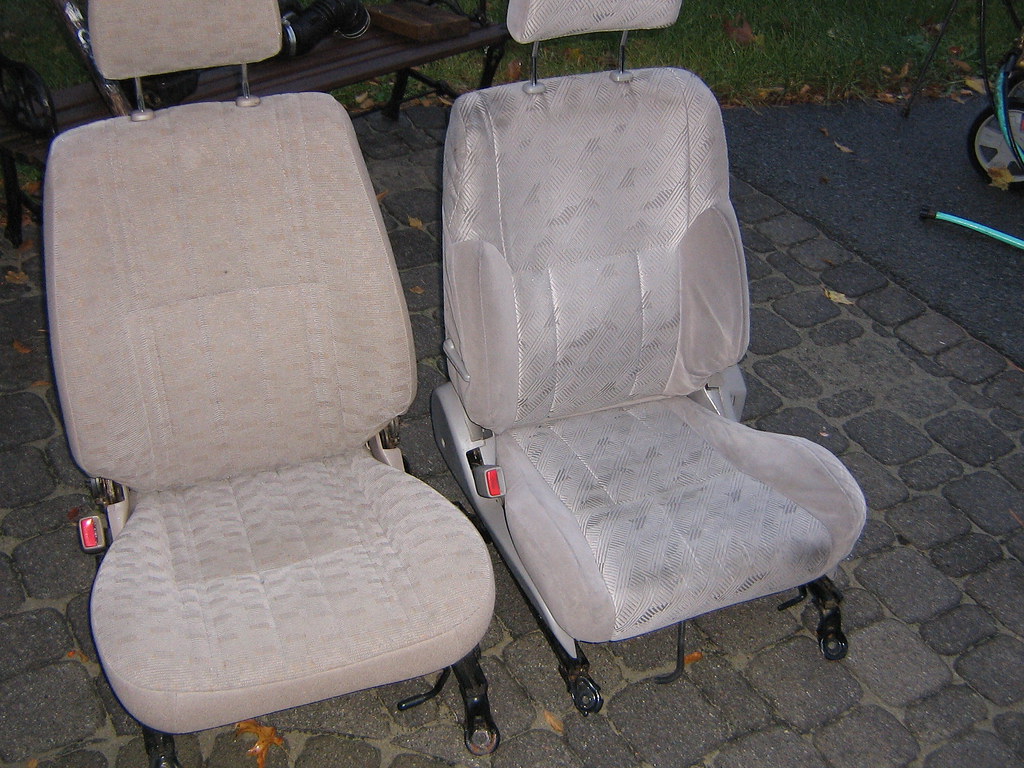

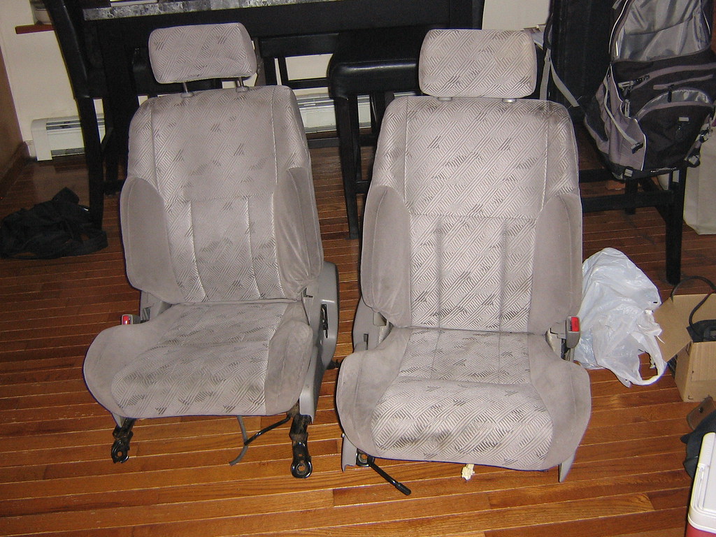

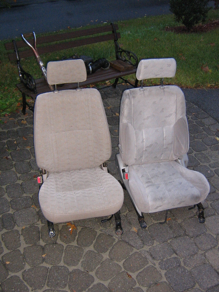

We all know 4Runner seats aren't that comfortable, especially if you have base model cloth. I wasn't sure if I wanted to go all out on PRP seats or just upgrade to Limited Leather or 01-02 Sport seats but when I saw [MENTION=144287]Hardizzy[/MENTION] selling a pair of Sport seats for $100 I had to take them. Even if they were Grey & my interior is Oak. I spent the coin on Tan & Black Coverking NeoSurpreme custom covers & will switch over the Oak side pieces & the Grey should dissapear. No pics of that. I have just the one Grey DS seat in right now. I like that they have the lumbar adjustment which the 99 base seats dont. I'll take pics of everything after I clean up the frames & put the covers on.
I live close the highway where Hardizzy commuted between school & home so we met at a gas station & made the exchange. He even gave me a working clock for nothing too. He grabs them every time he goes to a pick & pull. LOL Real nice guy.
1542 by Mike Campbell, on Flickr
1543 by Mike Campbell, on Flickr
These seats aren't as clean as mine but I'll shampoo them before I put the Coverkings on. My OG seats have had covers on them since new so they're probably the cleanest 99's on the planet.

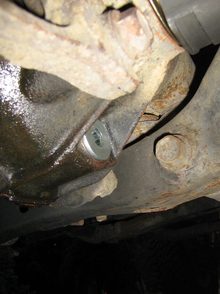

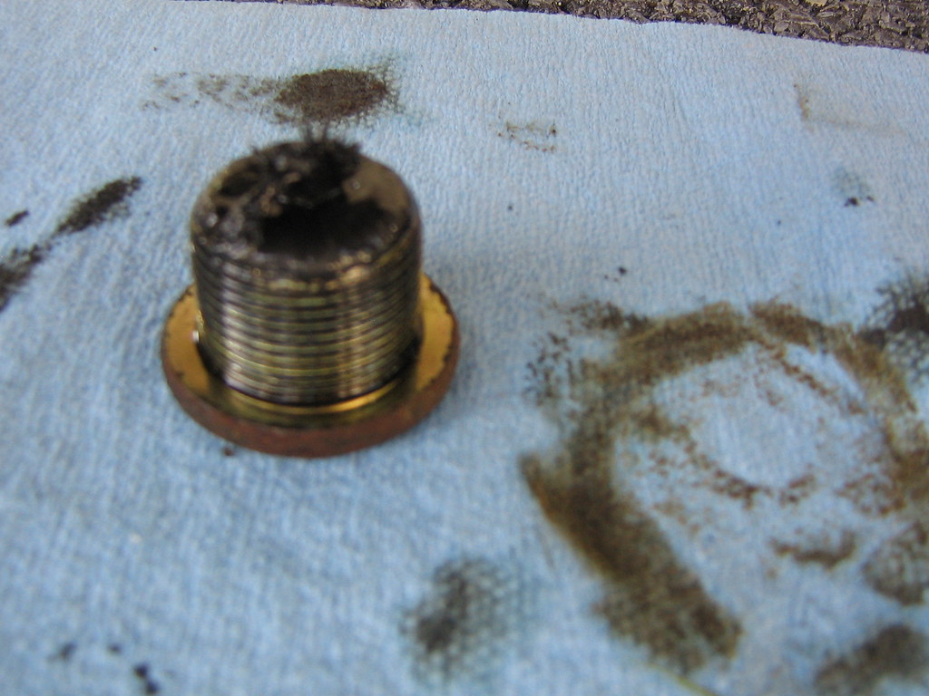

After driving for a few weeks with new Red Line 75-90 in the rear diff I had a small axle seal leak. I was pretty bummed. I checked my breather first & it was clogged/rusted so I decided to do the extended breather mod while I was at it. Well that fixed the leak. I dodged a bullet with that one!

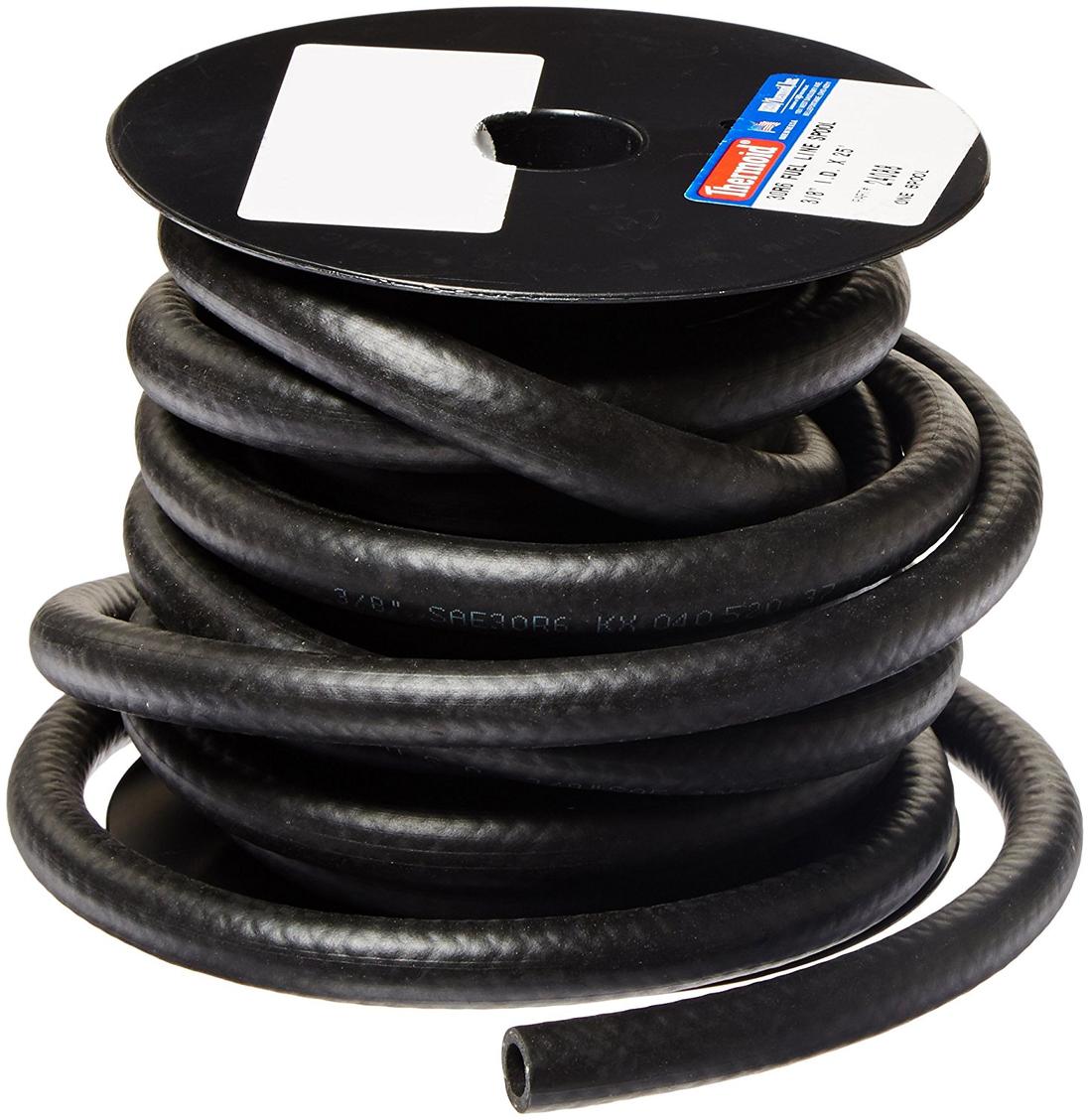

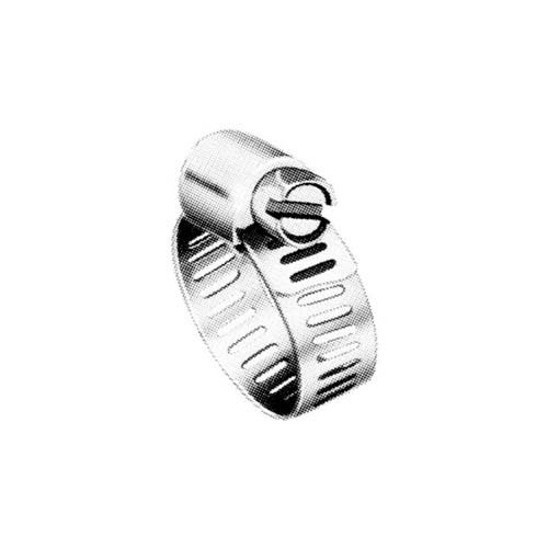

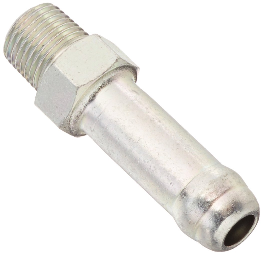

I've seen write ups where people remove the fuel filler neck cover in the wheel well & say this mod can be done in an hour. LOL It took no more than 15min. I made a small X with a utility knife in the plastic next to the gas cap & fed the line in that way. Dont feed the line in from the bottom, 2 hose clamps & 2 zip ties & you're done. It takes longer to air up 4 tires. I didn't take any picks because it went so fast but I grabbed all of the items from Amazon except for the new OEM breather that I got from the dealer.
A 10 pack of hose clamps. $3.85
https://www.amazon.com/gp/product/B001HWGMBG/ref=oh_aui_detailpage_o04_s00?ie=UTF8&psc=1
Fuel line. $19.69
https://www.amazon.com/gp/product/B00PLKV6C0/ref=oh_aui_detailpage_o04_s00?ie=UTF8&psc=1
OEM Union. $11.71
https://www.amazon.com/gp/product/B00P2S0TKQ/ref=oh_aui_detailpage_o04_s00?ie=UTF8&psc=1

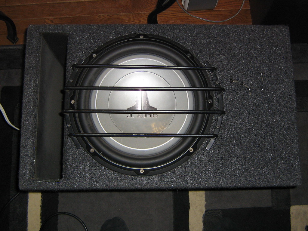

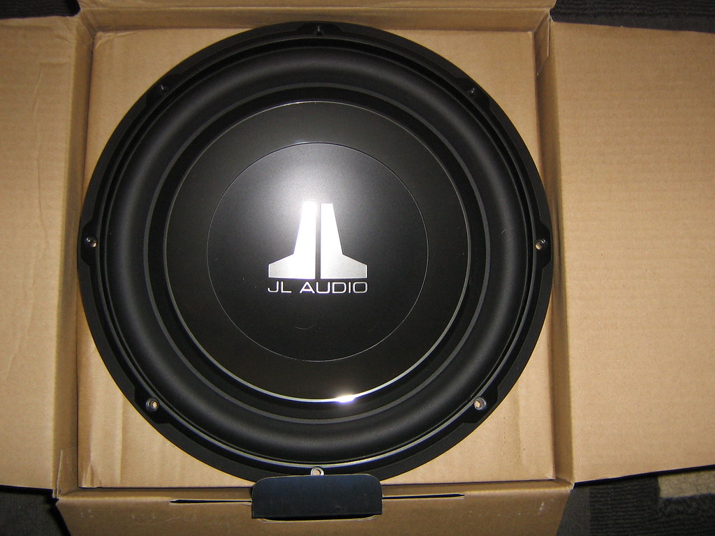

The rubber surround on my JL Audio 12" W0 finally started to tear. I installed it back in 2006 when I moved the JL 10" W0 into my Corolla's trunk. It has survived major punishment from old school hip-hop & true Heavy Metal. I figured an upgrade was necessary! Behold the JL Audio 12 W1V3-4. Got it off Amazon for $149.94 which was a good deal. Now they're around $180.
Old 12 W0
147 by Mike Campbell, on Flickr
NIB 12 W1v3-4
148 by Mike Campbell, on Flickr

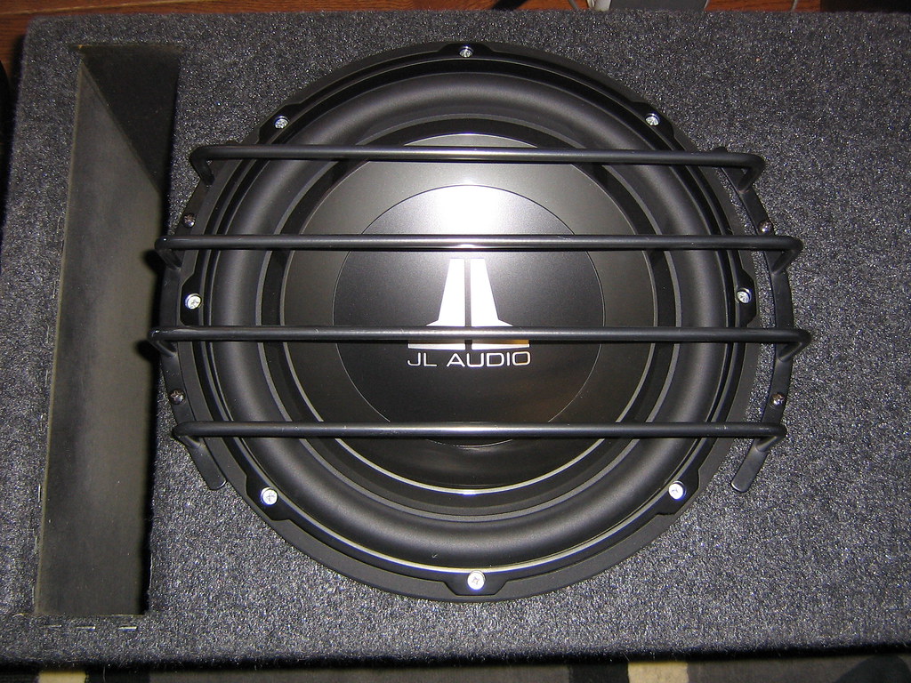

Installed in ported box. I love the all Black over the old Silver cone. I used zink deck screws that I had laying around because the old plain screws got rusty.
152 by Mike Campbell, on Flickr

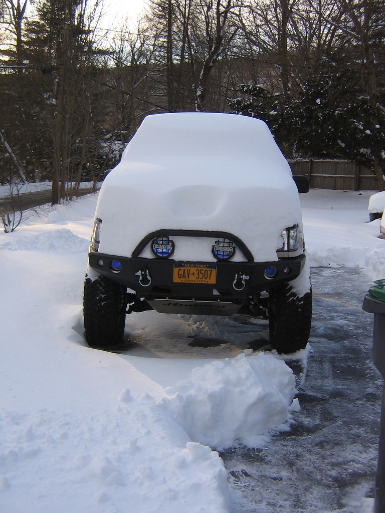

11" of snow on 2/11/17:
208 by Mike Campbell, on Flickr
211 by Mike Campbell, on Flickr
Out at night to do some snow wheelin'!

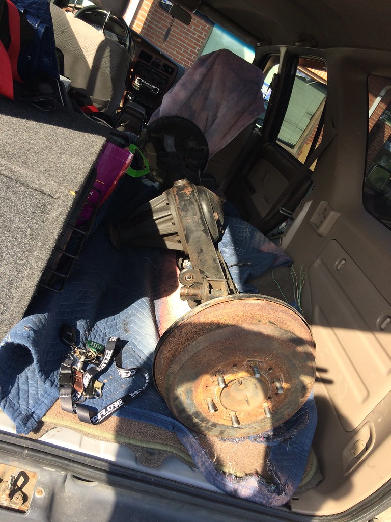

I've been looking for an e-locker axle housing for a while now. I'm in a few Toyota Northeast FB groups & everything up here is crusty. I don't even bother with junkyards. The only junkyards I deal with are from the Southwest on E-Bay. But anyway, I was cruisin' the T4R "Items for sale" forum & found [MENTION=80933]4x4runner2002[/MENTION] selling a drum to drum housing. He was actually parting out a 2000 Limited. Me & my GF drove the 8hrs to West Virginia on a Sat & picked it up. Here's the only shot I got bringing it back to NY.
I'm on my way to finishing up this rig now with the big 3, 5-speed (factory), e-locker (installed) & S/C (purchased-need to install) . :guitar2:

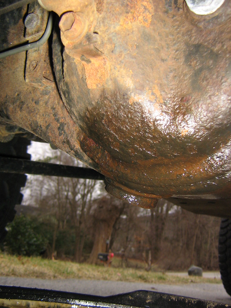

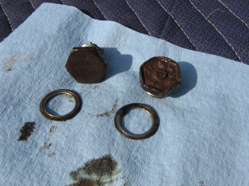

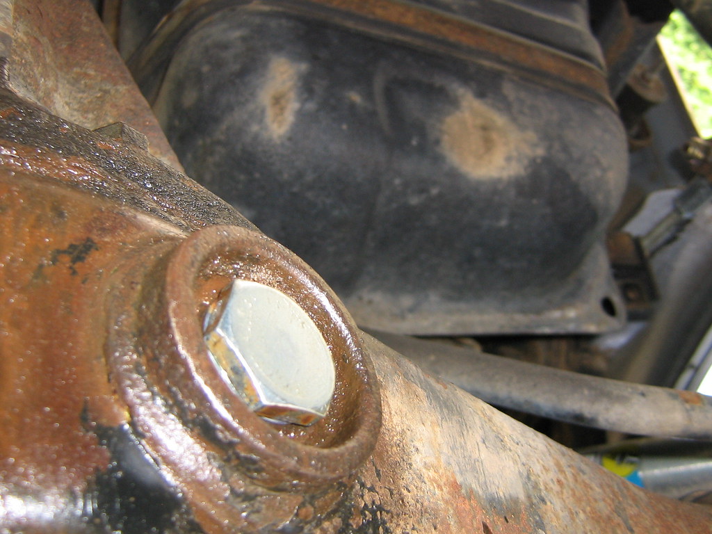

I've been checking my axle seals every few days since I had the leak but the new breather and extension has been working. A few days after I got back from picking up the e-locker axle in W.V. I found that the Diff was leaking. WTF? I think the RedLine fluid is thinner or finer than conventional even though the weight is the same. I never had any leaks until I put this stuff in. I thought maybe my housing rusted through but I checked it & it's fine. I tap on it at least once a year & it's still solid due to my anal ways of washing the salt off after every snowstorm.
I find it weird that I drove 16hrs round trip to get a used axle & a few days after I get back it the old one starts leaking. I guess that's called good luck or good timing or lucky timing! LOL

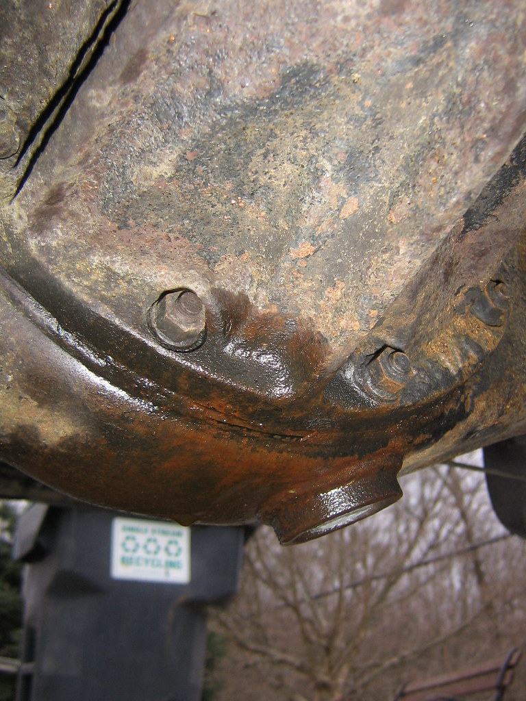

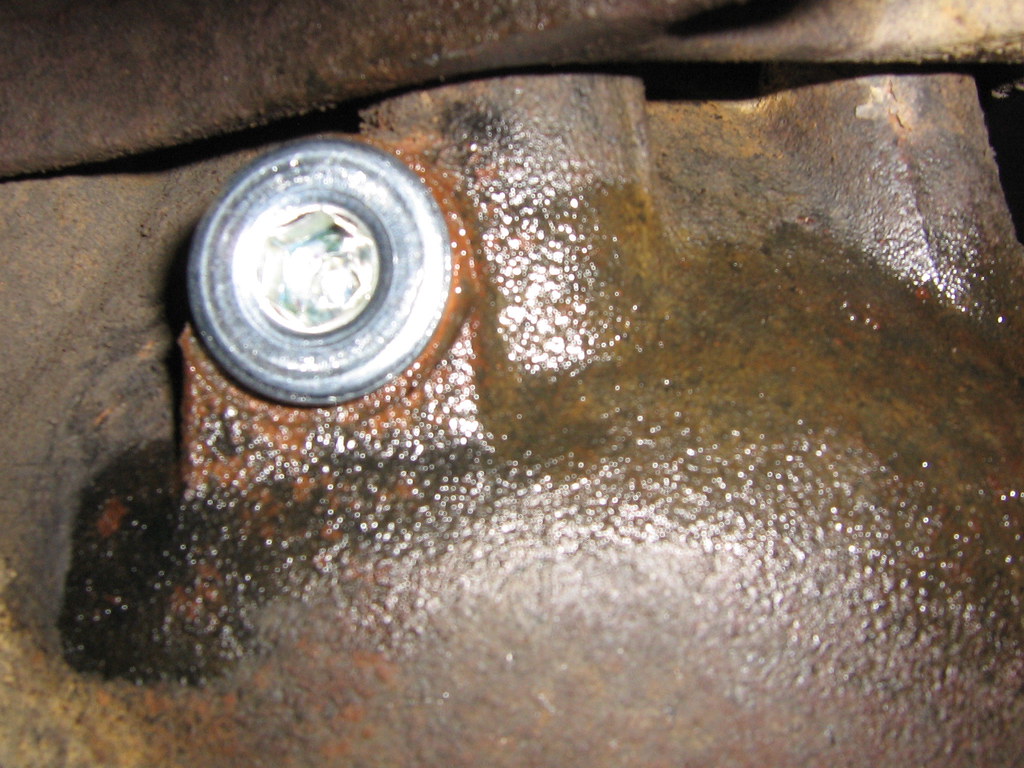

Here's what I first saw.
IMG_1851 by Mike Campbell, on Flickr

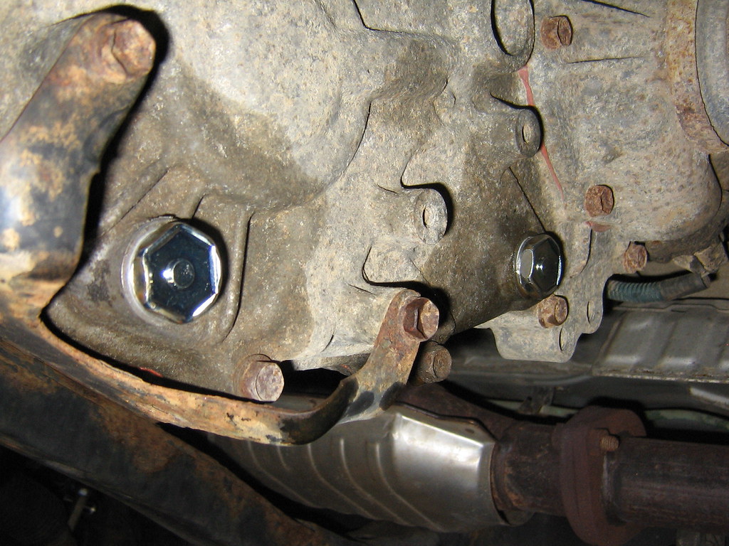

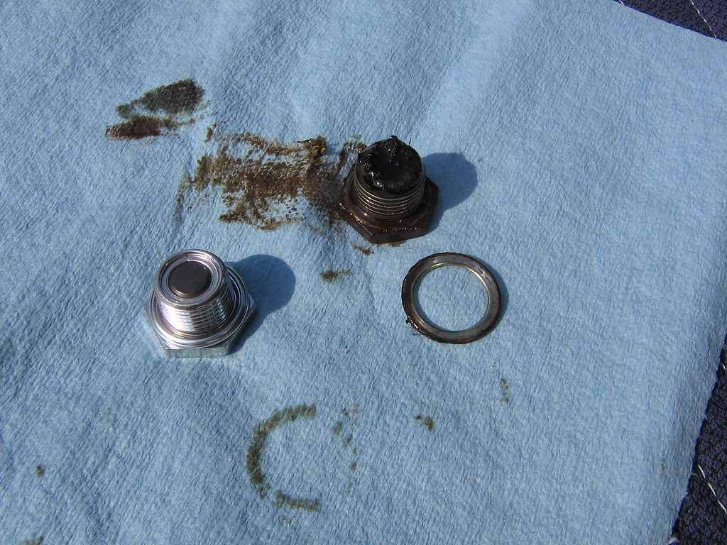

After further inspection I realized that it was coming from between the housing & 3rd member. The gasket must have disintegrated right there at the bottom.
IMG_1852 by Mike Campbell, on Flickr
Rather than drive it & risk running the diff low I stuck her in that garage I bought but haven't used yet. I plan on swapping my stock 4.56 gears into the new 4.30 e-locker carrier & dont want to f*ck them up.

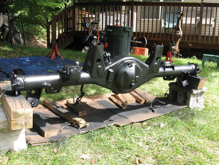

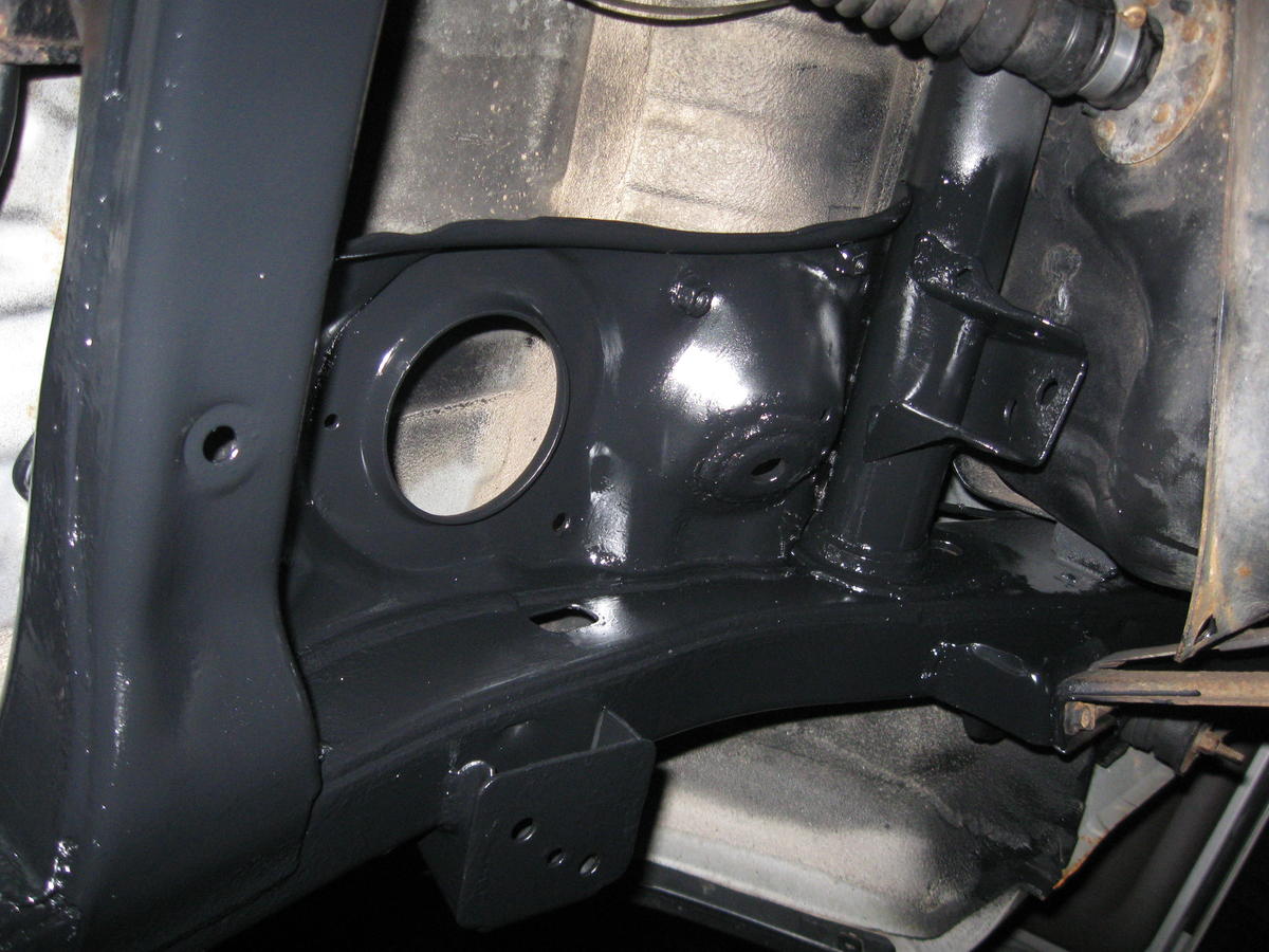

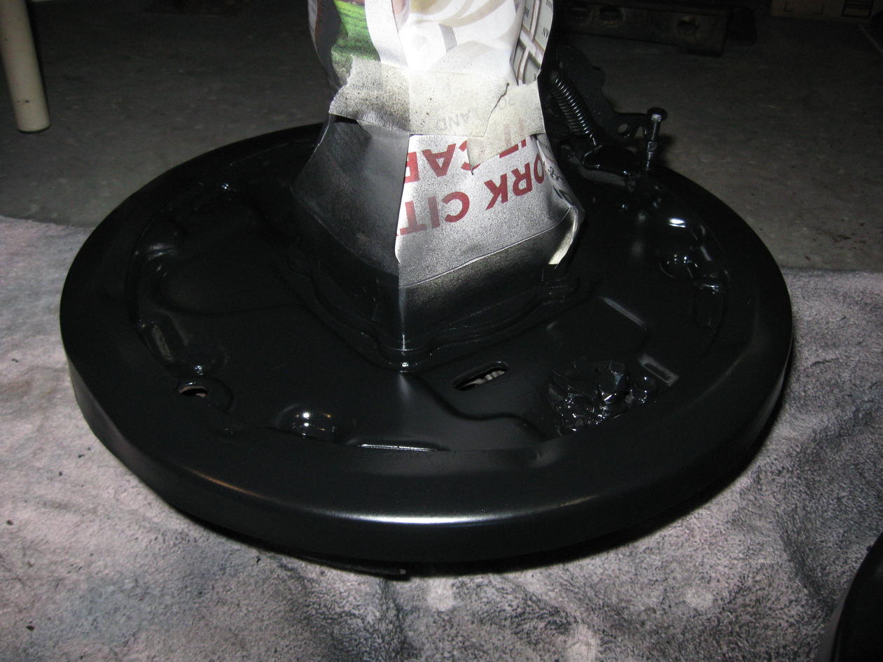

Here's how she looks now beeotch.:p More pics to come soon. Two coats of Eastwood & two coats of VHT chassis paint.

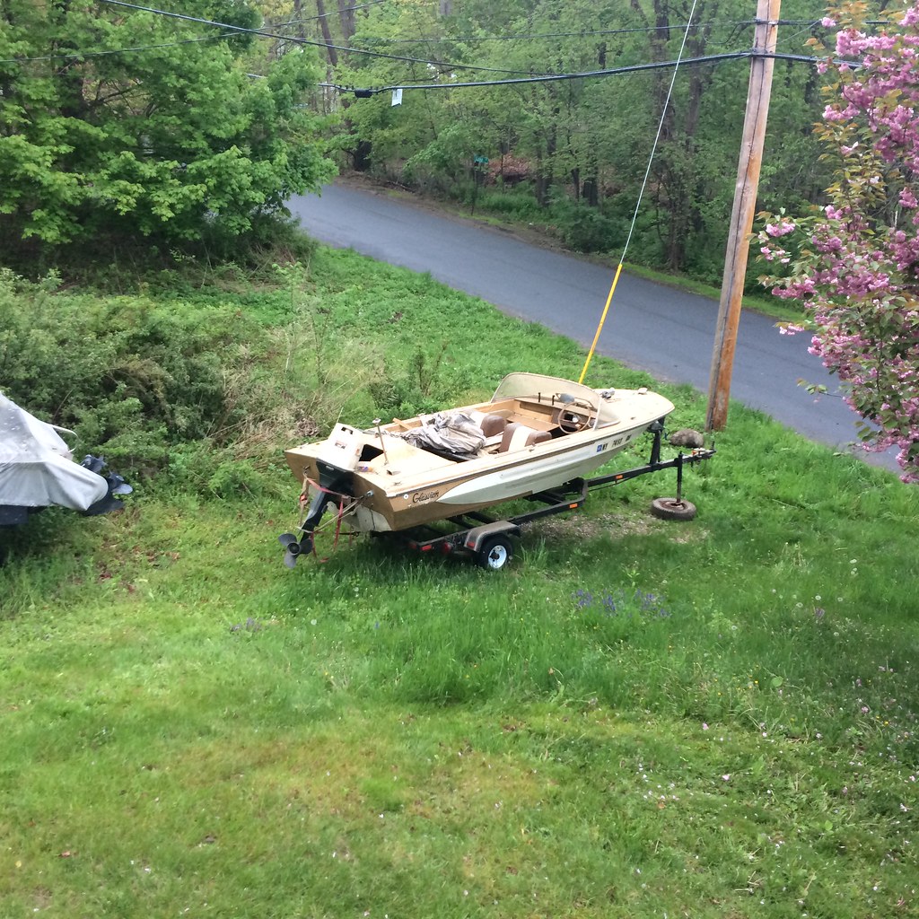

For those that dont know I bought the property next to my house that has a big garage on it. My friend John own's a landscaping company that does clean-outs & other odd jobs. He said he'll clean it out & just charge me the dump fee's as long as he can store his Harley & Audi convertible in there for the winters. No problem! It was 6 dumpsters full of junk @ around $300 a pop at the dump. It goes by weight. Imagine if I had to pay his labor?
So here are some pics of me pulling the previous owners boat out of the garage. I got it in the sale.
img0903-b by Mike Campbell, on Flickr
This is the view from my porch. Top left is the jungle I was trying to cut back. You can see how bad the grass is getting because of my lawn tractor issues.

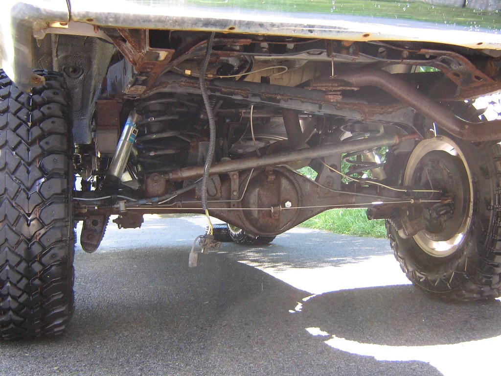

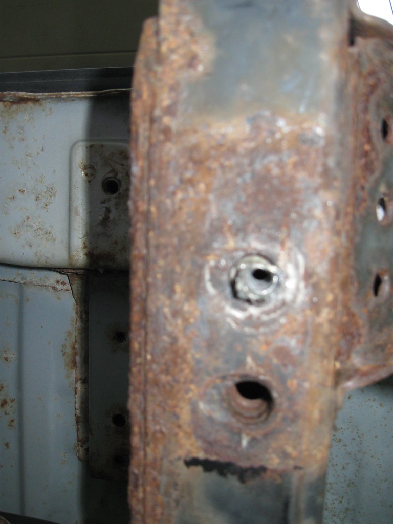

This whole thing started by wanting to do an e-locker axle housing swap. As I got deeper into it I realized that I had better address the rust issues on the frame, cross-members & under the body. With the axle, springs, shocks & rear links out I had to do it. Figured I might as well pull the bumpers off too. The rear brackets are really bad & the inside of the Shrockworks bumper was staring to rust only after 3 NY winters.

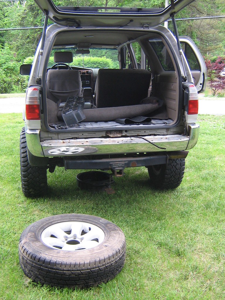

Started with getting the spare out.
IMG_1930 by Mike Campbell, on Flickr

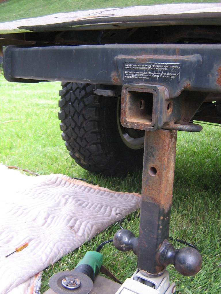

Trailer hitch was good for holding up the hitch while I tried to unbolt it. I almost always work alone.
IMG_1936 by Mike Campbell, on Flickr

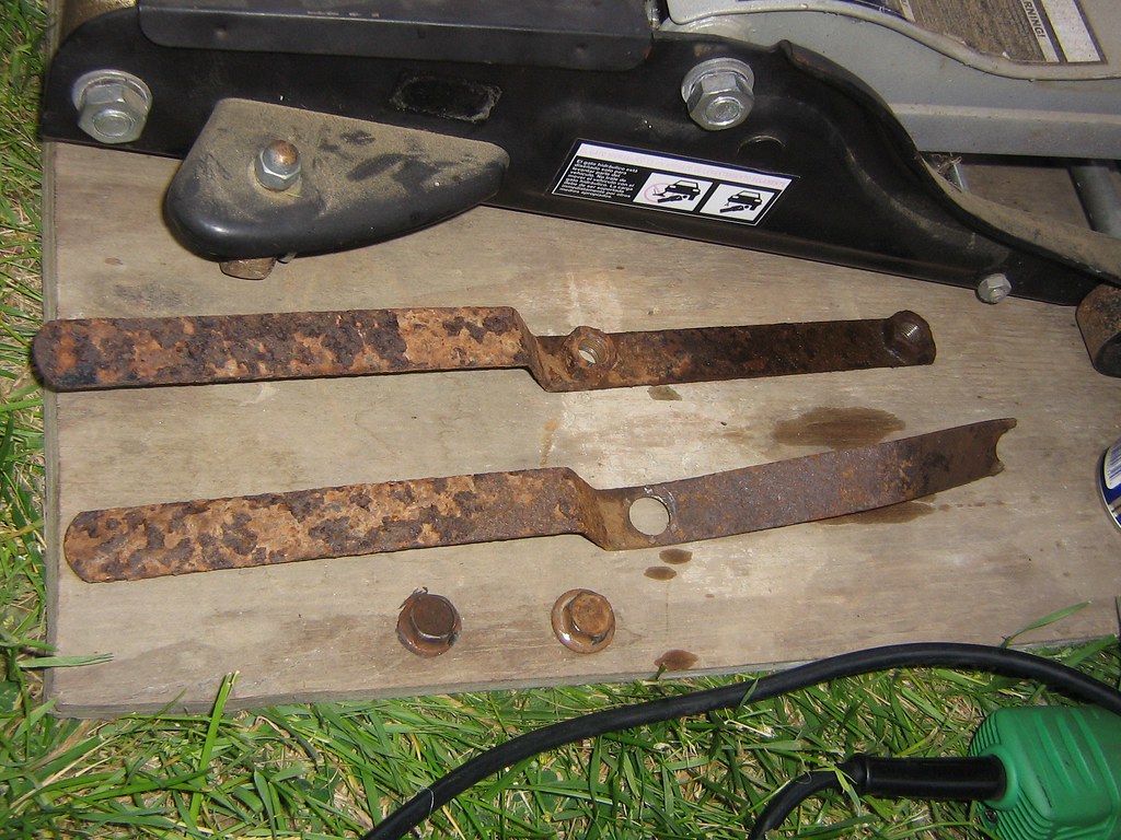

WD 40, the impact & angle grinder were needed & shit got mangled. These bolts were never off before.
IMG_1938 by Mike Campbell, on Flickr
IMG_1937 by Mike Campbell, on Flickr
This bolt is still in there almost a year later. Spent way too many hours trying to get it out.
