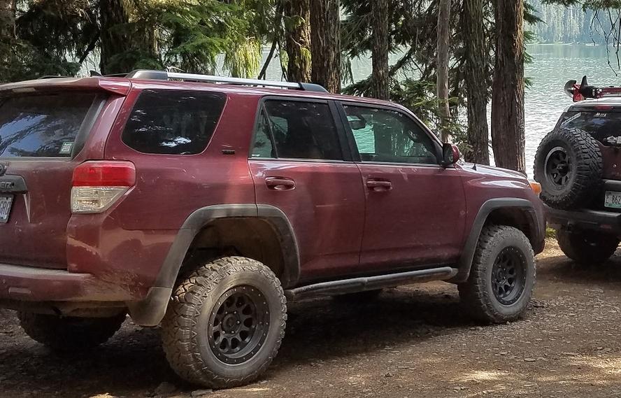

I'm currently running Ray10s with 265/70R17 Goodyear Fierce Attitudes and Icon Stage 5 3" lift. Prior to the lift install they rubbed at full lock.
I have about a year left on these tires but when they are done I plan on moving up to 285/70R17. I expect that they will rub again and I will need to do the whole "cutting of the mud flaps/bumper" thing.
