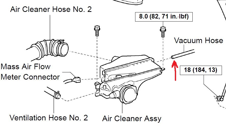

Hi,
Sorry for reviving a dead thread but I want to try seafoaming the my 2003 toyota 4runner as its due for oil change in about 400 miles. I bought a pint of seafoam and i know to add 1/3 to gas tank and 1/3 to oil and 1/3 to (Brake booster line?) I dont know where this vacuum line is located. I found diagram online and my guess is that is the one but i want to make sure before i do anything. Can someone guide me? thanks.
