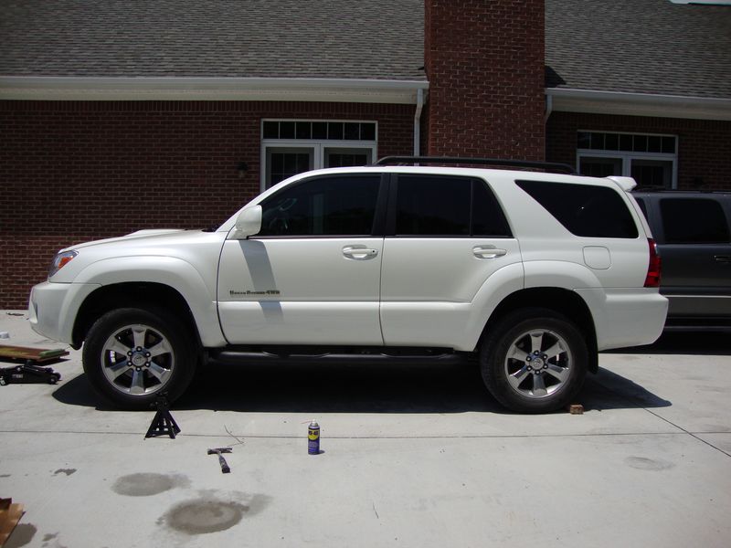

It seems you are yet again correct. a V6 with the 1/2'' spacer looks a bit nose high: (attachment 1)

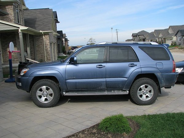

yet, a v8 with the 1/2'' spacer looks just right. (attachment 2)
I shall order the larger one. thanks!
