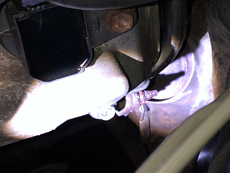

Anyone ever run into the issue where you couldn't install the block-off plates because the bolts were too rusty? I can't even put a 10mm wrench on them. The wrench just spins. If they were easy to get to, I'd just cut them. But that's not possible given their location. My 08 left me sit earlier this week with a valve stuck open. It looks like I'll be unloading about $2,100 at the dealer soon :(
No, but heat followed by PB etc, Gatorgrip socket, pounding on next size down (10mm or 3/8"), Vice Grips, etc have gotten out bolts in worse shape than that for me
