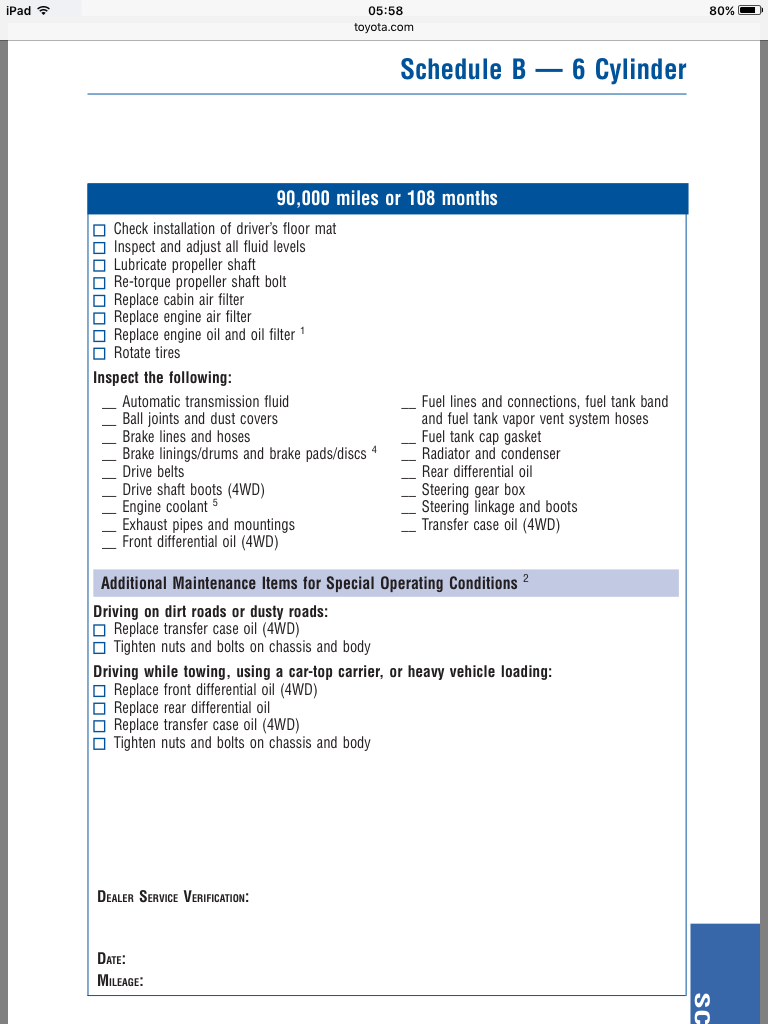

The 2011 maintneance schedule is available at Toyota Owners website, as stated earlier. You may not be scrolling down the page far enough to see it.
2011 Service Manual

There is no maint schedule info in the owners manual. It's in a separate maint schedule manual that is also available at that site. Once you drill down to where the manuals are at, you'll see a number of selections you can download and save to your machine.
Arlendsee provided a screen shot of what it looks like
