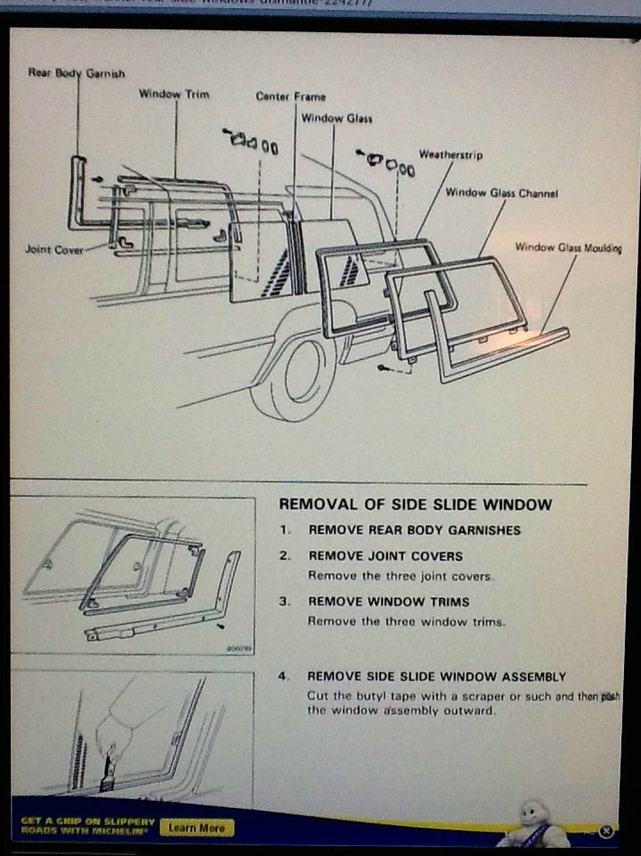

From inside remove the weatherstrip around the window.Get a razor to cut the glue from the frame and fibergalss. Once most of the glue is off push the window or use flat blade to pry or have someone help pull from outside. There are screws on the L trim to remove seen in the exploded pdf diagram. TRANSLATION: As stated already.. TEAR IT APART!:beer:

Tear it apart like the diagram shows.

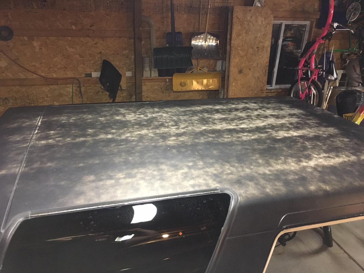

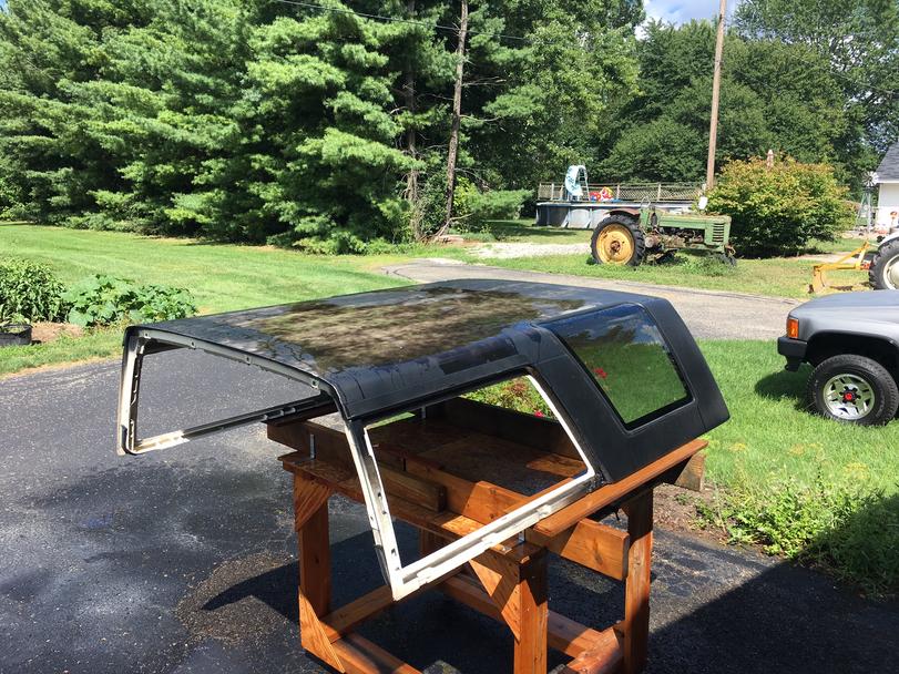

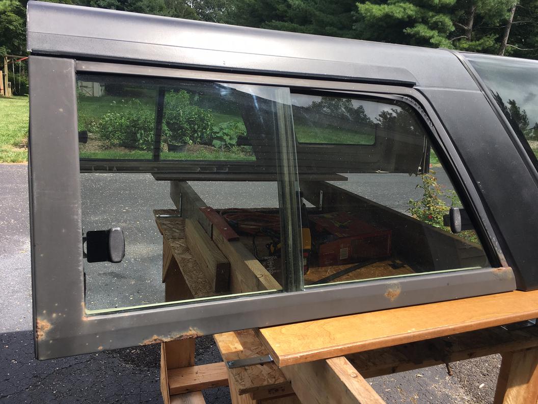

This was a helpful thread, so I thought I would add some pictures. Wanted to paint the shell top on my 1987, as well as replace one of the sliding windows due to rust. Here's the top, and why it needs a paint job.

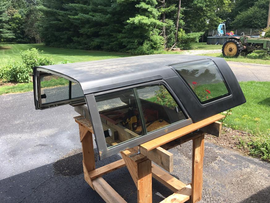

I was able to find a driver's-side sliding window on eBay to replace my rusted one. This vehicle spent its early years in British Columbia, so the the rust is up top (also had rust around the windshield) instead of around the fenders and rocker panels like a Midwest vehicle.

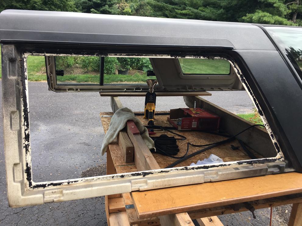

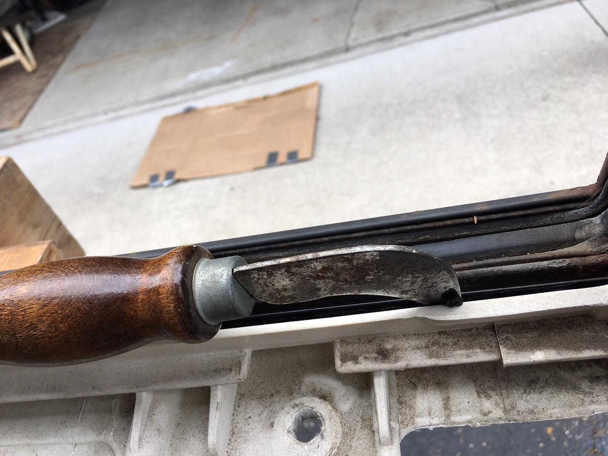

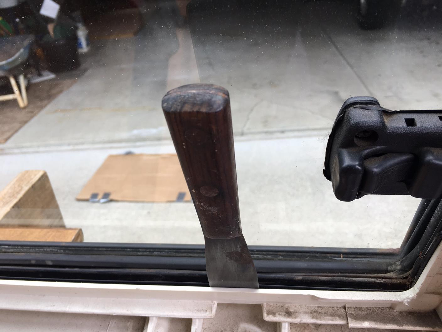

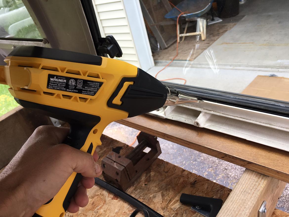

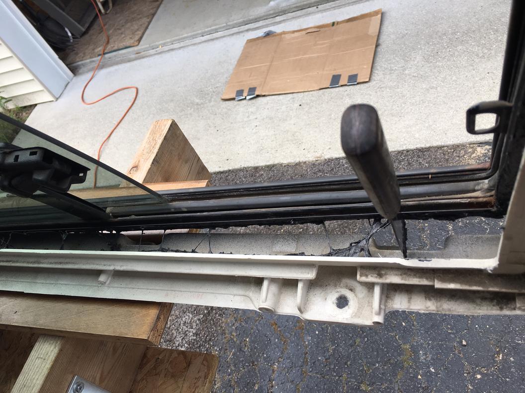

Started with a very light application of the heat gun to soften the butyl tape. Be careful, too high a setting you'll melt the fiberglass! Then worked the scraper between the window and the shell. Did this all the way around the window and then it was easy to remove the window by hand.

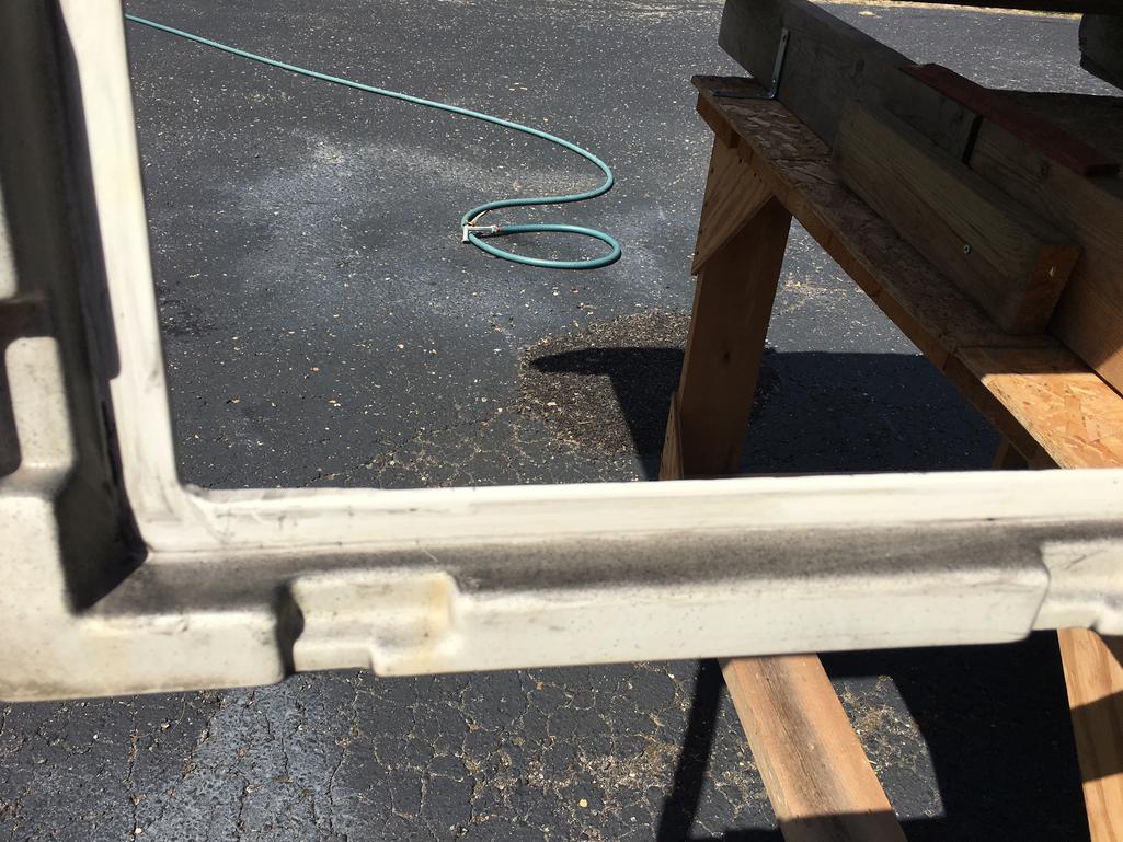

With the window removed, used the heat gun and scraper to get rid of the largest remaining chunks of butyl, then applied paint thinner with a cloth to clean the rest. After that, gave it a wash and it's ready for primer!
