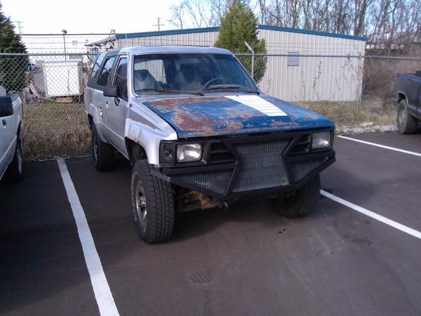

I welded that sweet ass exhaust the day after i brought it home. When i got it, the exhaust had rusted off at the bottom collector, and was held up with a bungee cord and a coat hanger. The decibal level was pretty extreme. A buddy gave me the muffler and tip off his mustang. His 3" pipe on the muffler was way to big, so with a few pieces of scrap and turning it almost 90* i had a weldable gap. It's not pretty, but it gets the job done. Getting a new set of tires on it this week. I might put some fender flares I made before. Used rubber cove base, sheet metal screws, and zip ties to make flexible fender flares. They worked like a dream, and cost about $20 Heres a picture.
I'm definitely form over function, and free above all :-P That bumper was all free scrap metal. And square tubing is so much easier to mount things to. But anyways, i'll build some simple bumpers for the Runner, make the interior atleast decent enough to take one of these southern belle's out for a nice seafood dinner. Here it is after a bath.
I'm on vacation all week with nothing to do, so I'll post pictures as I continue to add a touch of class to this old beauty.

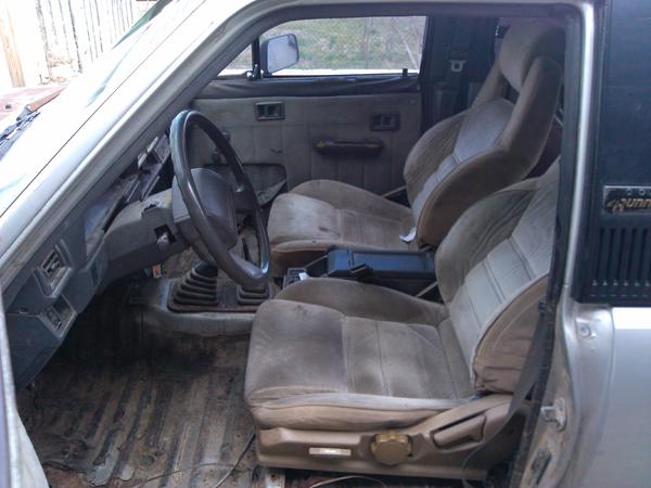

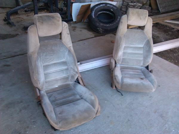

Picked up some seats out of an old supra, and some steel tubing to build a front bumper. Hopefully since they're both toyota seats, and similiar years, it wont be too much of a pain to swap the tracks.
Got the seats mounted up today. A few bolts, a few welds, and its perfect. I mounted them a couple inches behind the factory locations, i'm 6'2 and need some legroom. They are awesome. The cushions are still firm, the side bolsters still hold you in the center. $25 a piece, well worth the money for the comfort.
I'm putting a set of gray and black seat covers to match my interior tonight! I believe these seats are beyond a carpet cleaner :P

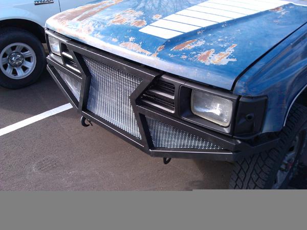

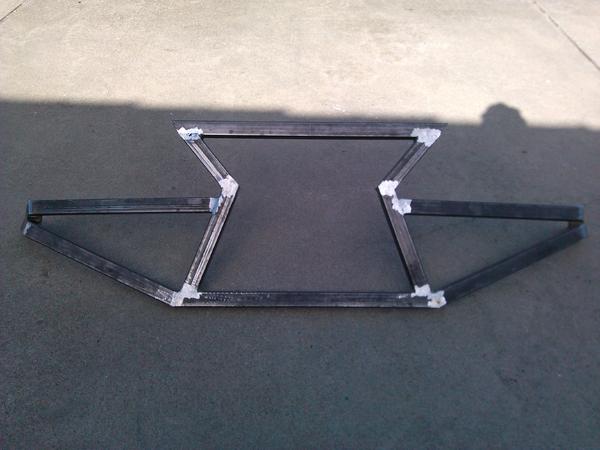

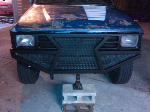

Got the grill/bumper fabbed up today. Painted the grill pieces with the headlight trim black, mounted them, now im waiting on the paint to dry so i can mount the mesh behind the openings. I'll have to post more pictures tomorrow when its daylight.

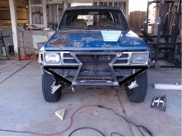

Got the main frame of the new bumper/grill painted and mounted. I like the front profile, although I think I need to paint the main hourglass opening frame a bright color, maybe red, or lime green. From the side it's a little flat, it needs some dimension. I'm thinking about possibly angling pieces out slightly from the edges under the headlights, and using 1.5" flat stock at an angle to bring the main hourglass frame out some. Add some dimension, a couple Trek Lights, some tow hooks, and a couple emblems, this thing should be ready to go.

Well my uncle threw a wrench in my plans. He used to have an '80s model Landcruiser, which he unwillingly sold a few years back. I guess he took some parts off, one including a 6K lb winch. He offered it for my 4runner, for free. Number 1, I have trouble turning down anything free, and 2, I've always wanted a winch on my woods truck. Anyways, now i've got a winch, and what i think is a new sweet ass bumper. :whoo: The winch won't fit behind the bumper, and I'm not a fan of having it visible on the front. I dont like how they look, and i dont want it stolen. I was wanting a little more dimension to this bumper, but i dont want to obstruct the middle hourglass shape. I'm thinking of bringing that main peice out far enough to mount and tuck the winch behind it, and just have the fairlead roller visible. Right now im thinking i'll cut 3 sides of the triangle tubes on each side, which will allow me to angle them back. Should give me the dimension im looking for, keep the big open mouth front end, and have a winch. It should also offer a reasonable angle to fab my own skidplate, and run it from the bottom of the hourglass to where the original skidplate is mounted. I dont have much faith in what that flattened tin can of a skid plate will offer in terms of protection. Can anyone with experience with mounting/operating a winch give me some tips on what to consider, what to look for, etc... I really appreciate the help!
I've never run a winch, but from what I understand you'll want to brace/plate that front crossmember or risk tacoing it. 4xInnovations sells a kit for that.
My biggest beef with your bumper design is how much it kills your approach angle. It's too low, it'll hit a ledge well before your tires do.
Are you sure? Maybe the angles of the pictures make it look lower than it is. The lowest bar in the center is about 1/4" above the very front perforated crossmember. For example, if I didnt have any bumper period, my approach angle should be the exact same as it is now. Am I missing something? I'm not trying to disagree, maybe theres something im not factoring in. Thanks for the heads up though!
