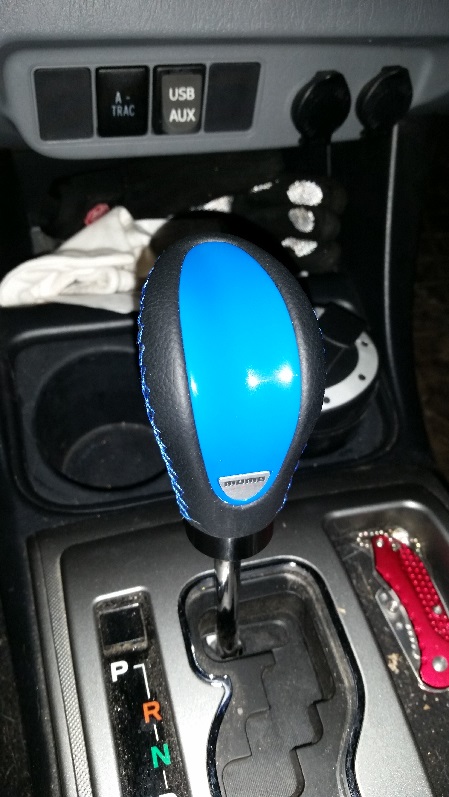

if its any consolation, I tested the warden's V-day gift on mine before I installed it in her 12 Tacoma.
picked this color since it will a closer match to her new Tacoma when it comes out.
the momo kit has a universal adapters (make sure you dry fit everything. once you install the adapter inside the handle its a royal pita to get out if its the wrong one.
luckily the shaft is the same on the 4runner as the 12 Tacoma, pretty much all Toyotas I think.
pic installed in the Tacoma :
