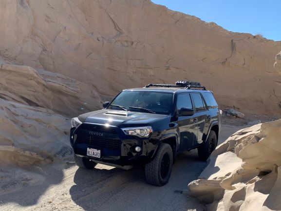

I throw on my Maxtrax Xtreme boards and Diode Dynamics 42 inch light bar on when expecting to go where I may need them.
Smaller mounts by the base of the rack is for scene lighting which I run a pair of Selective Yellow Diode Dynamic SS3 Pro's with a clear flood lens for scene lighting.
GZila 1.75 tube mounts and KC Hilites mount for the light bar.

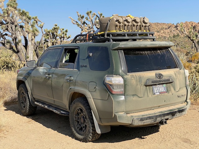

What rack mounts did you use for the Scepters?
No mounts. I used four Rhino USA soft loops and two ratchet straps to secure them. Also snugged up one of the factory load bars on the top rung of the rack against one side of the cans. I effectively created a small tight basket for the cans and then strapped them in.
Worked great in that config, did over 200 miles in mixed offroad terrain and about the same number of freeway miles back and forth to the trail from home. On another trip where I only needed 10 gallons, I did similar but laid two cans flat on their sides in the same space.
No issues at all, just have to loosen and tighten the straps as needed to allow for swelling of full cans or shrinkage of empties.

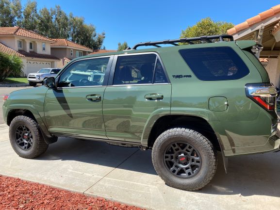

I made a kit to remove the top rail.
Lower profile (I think looks better) and now things can mount further back like Recovery Boards, Cargo Boxes, ect.

I custom machined a tube that replaces the plastic piece at the rear of the rack.
I also machined some custom caps for the front mount where the top rail used to reside.
I have produced a few kits and I am thinking of selling them if there is enough interest.
PM me if you are interested.
Wow! That's awesome. I carry kayaks and I literally have to throw them into the J racks because I have to attach them to the cross bars on the top of the rack. They sit so high. Being able to carry them on the lower section would be great. With your modification, can you add the top section back at a later date if you were trading it in or is it a permanent mod?
The modification is completely reversible. You can change back to the stock configuration at anytime.
