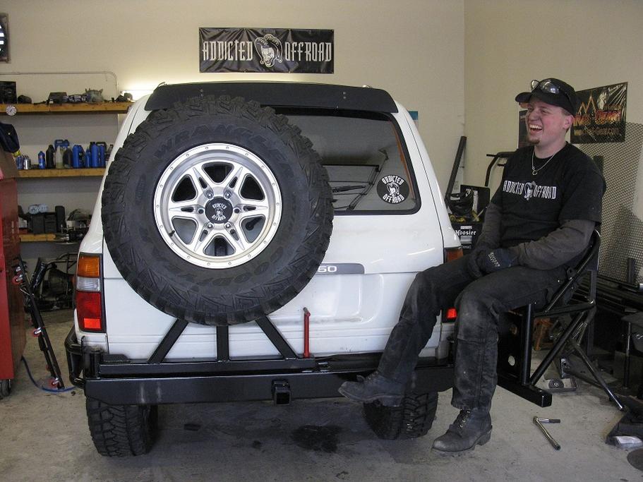

Showing off a new tire carrier

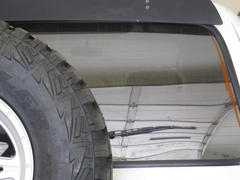

Overall, it looks really nice. But it looks like the tire is up too high, and completely blocks the rear window. There appears to be room beneath the tire to lower it some. That could improve the rear visibility. Just a suggestion.
That will kill departure angle too though. The tire is offset enough where view is only partially blocked. If you want a tire carrier, there is no easy way to keep your view without killing departure angle

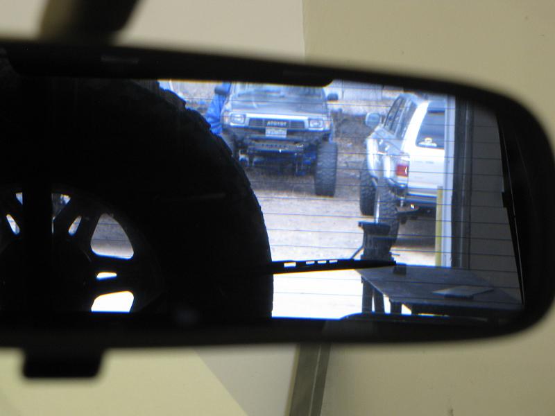

No offense, but "partially blocked" appears a bit generous, it looks mostly blocked. Can you take a pic from the drivers view looking back? Maybe the view from inside isn't as bad is the outside makes it look.
That does make sense about the departure angle though, especially with larger tires. I hadn't thought about that with these rear mounts.

Here is one pic from inside. Rigs behind it are directly behind it.
2nd pic is from outside where the rear view mirror is in plain view.

Oh, and just for reference, take a look at the CBI for the 4th gen. It blocks just as much. And is actually mounted HIGHER than our tire even though the tire is much smaller. Departure angle is key. You don't want to land on it and have it pushed into the body.

Nelson if you are so worried about losing rear visibility just install a backup camera, that'll solve that problem. I'll take rear departure angle and sacrifice some visibility any day.
The rear window being blocked is really not a big deal.....I just use my side mirrors more, and turn my head to see through my rear cargo area windows....when making lane changes and such. I back out of my garage / driveway with no issues.

I had the tire on my Jeep as high as I could get it without it looking re****ed and still hit it on drop offs. Since I had OBA, I'd wheel with it flat just to gain that several more inches of clearance. If I were going to run a tire carrier on my rig, I'd have the tire as high or higher than the one pictured. I personally am fully capable of using only side mirrors (didn't even have a rearview in my Jeep) so departure angle to me is much more important than what I can see from my rear view mirror. Especially when I consider that fact that 4runners have much more hanging off the ass end than a Jeep.
The plan for mine is to make a carrier that slides in the hitch receiver so that I only have to deal with it when I want to and I guarantee you won't be able to see out my rear view.
+1 for driving with side view mirrors, a couple months driving a work van did that for me. Really like the bumper, hoping this will be available to order and not just in shop. Glad a rear tire carrier came out to match to the tube up front, I really like the tube front bumper but was worried about lack of matching rears with a tire carrier.

Looks good finished. I didn't mean anything by my comment, I am really just curious about the loss of visibility, and you seemed to brush it off as not a big deal. I don't wheel yet, and likely will never wheel more than I DD in this thing, so I think for me, the loss of rearview mirror visibility would be a big deal. I wish it wasn't, because I love the look of the rear mount spare.
