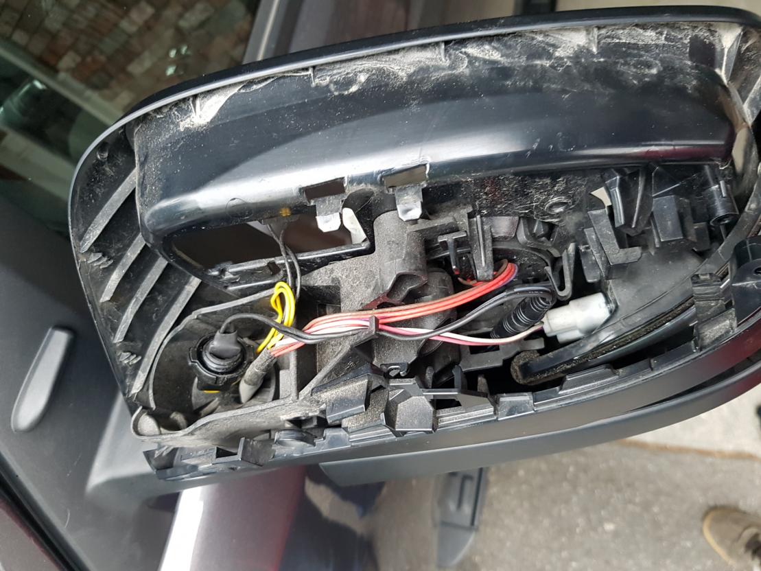

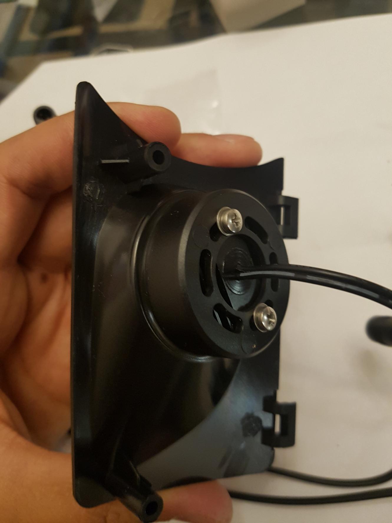

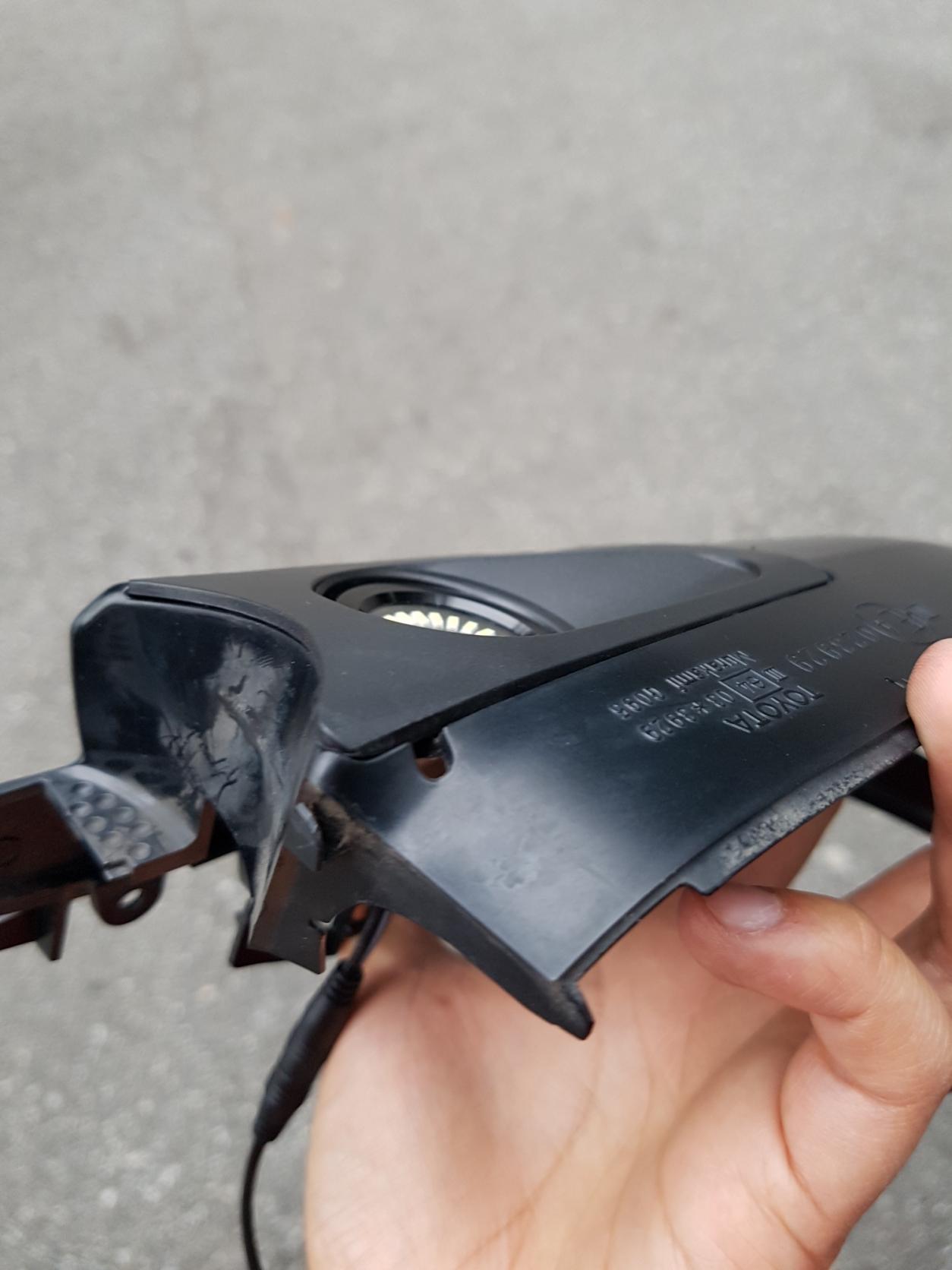

Adding pre install pics for reference.

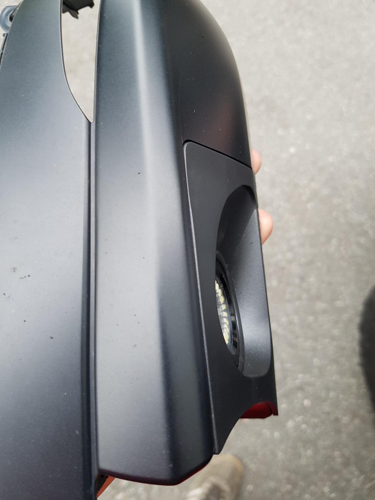

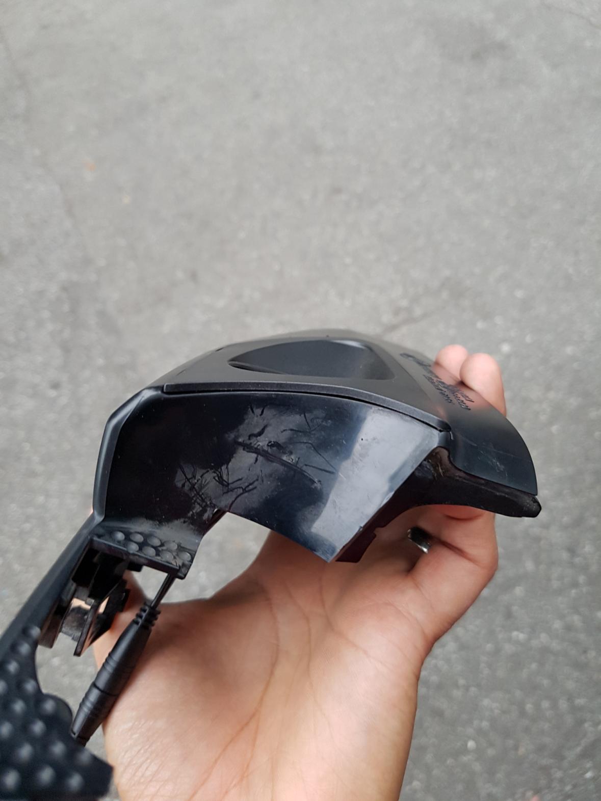

Before putting on the cover. I tucked the socket to the very left of the housing. Black wire is from the MESO puddle lights.
So with aftermarket fitment is not so great...also looks like mounting for mirror itself is different than OEM
Not sure if will go with aftermarket.it was cheap enough to try and play with.might have to find some used OEM
im also running the rav4 mirror and it looks like it will not fit the aftermarket housing

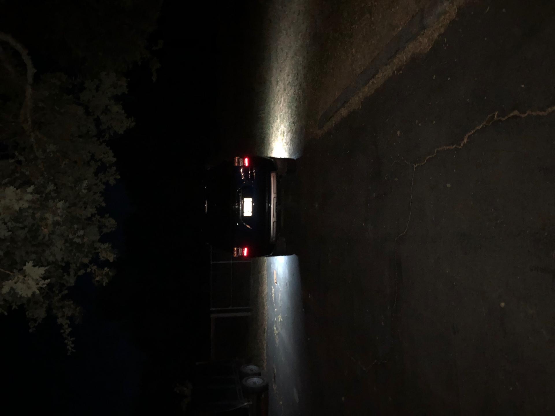

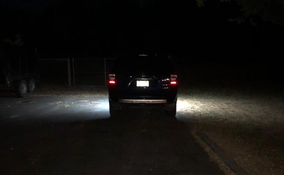

Got my MESO puddle pods installed. Pitch black night, the light throw is impressive. It lights up the entire side of the truck. What is cool is that the lights come on when you unlock the doors, even if the truck is running. Of course a switch will be killer when it comes out.
I have no idea why the photo loaded sideways, it was taken landscape, and the forum flipped it to portrait and put it on it's side.

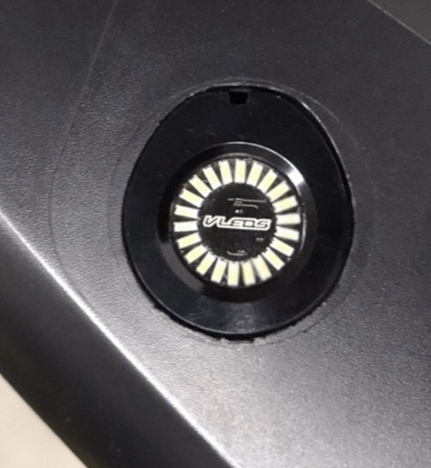

I found the specs on what may be the vLEDs module used in the Meso pods
400 Lumens
Waterproof IP68
All Aluminum Thermal Design
22x 4014 5K or 6K Chips
VLEDS
400 Lumens
Waterproof IP68
VLEDS
It might be too big overall and the forum is flipping it to stay within some maximum limit on width. If you can easily resize it try uploading something no more than 1000 pixels wide and high. Cropping can also help
400 Lumens
Waterproof IP68
VLEDS

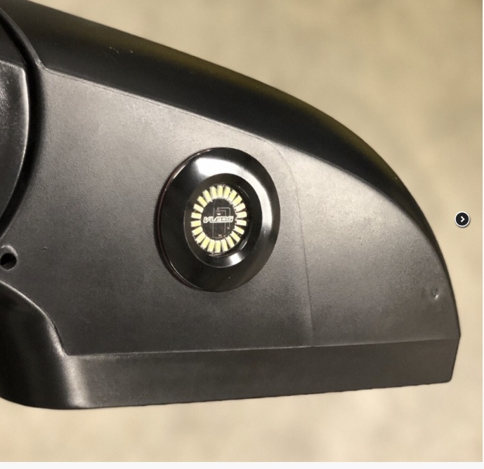

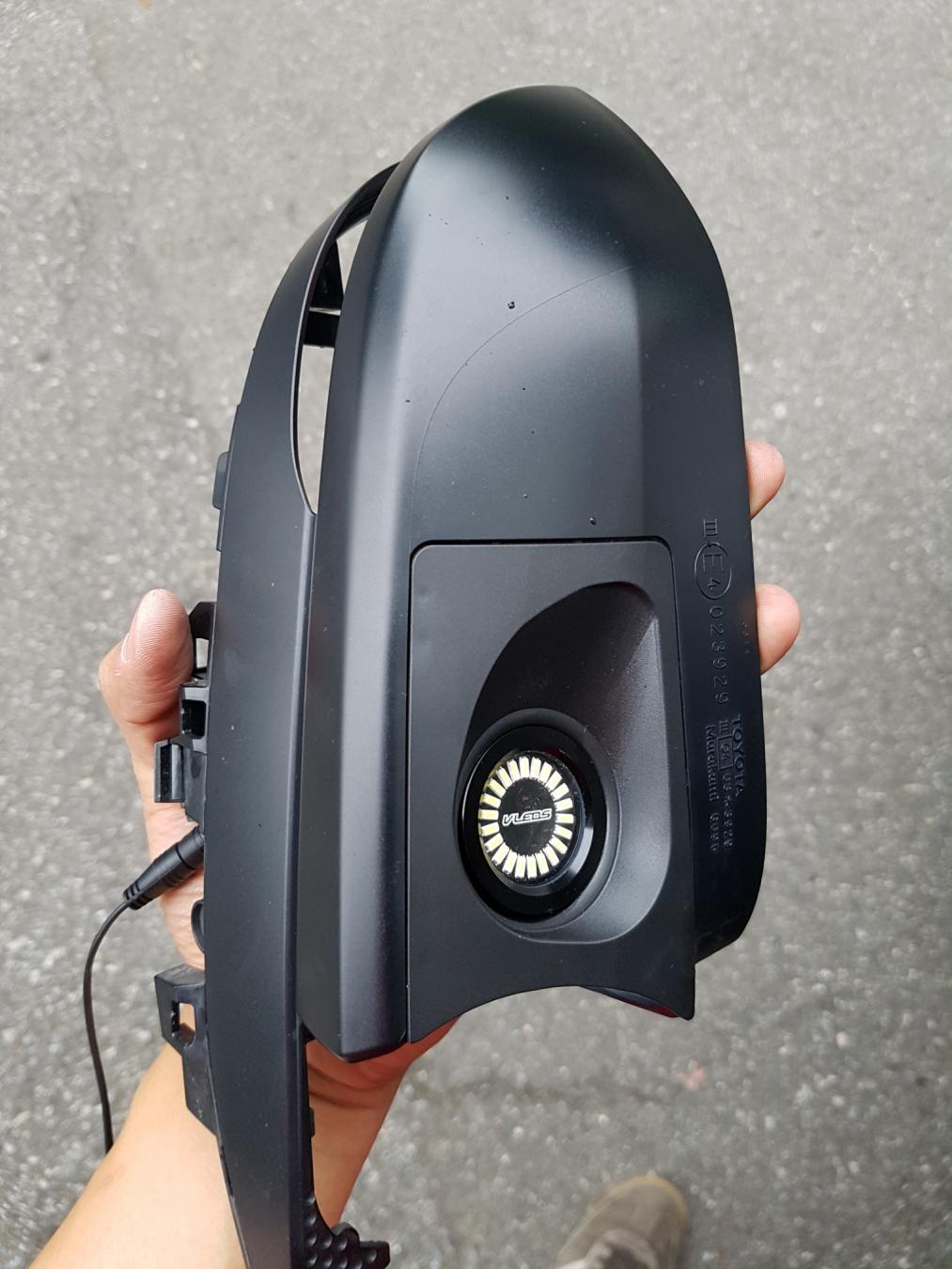

Yes, that’s the LED module in the MESO Pods. Minus the bezel that is shown in the three versions. Cost is $60 for a pair. There’s no direct replacement for the 4R though. It looks like the 5th gen OEM insert that holds the light fixture could be modded by carefully cutting it out and dremeling the proper diameter hole. The bezel with 3M tape would cover the rough edges. Might need the LED array to be tack glued in place.
Hmmm... who’s gonna be the first to try this?
