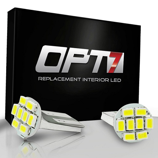

Right now the Last fit T10/194/168 at 400 Lumens are at the top of my list for the puddle lights however still waiting on a Lumen number on these ( see below).... being that the emitters are all on the same plane and would all be directly pointed to the opening on the bottom of the side mirror this may turn out to have even more light.
2 Pcs - Advanced Bright LEDs - T10/194/168 - 180 T-Shape 8-SMD White Light - OPT7
