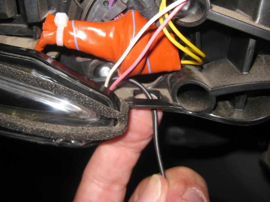

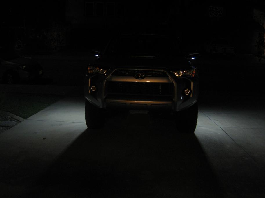

I installed mine tonight and I have to thank everyone who posted pictures, advice, useful links and videos for mirror housing disassembly.
The vLED units are really bright, like little arc reactors from Iron Man's suit. :biggrin1:
Once I plugged the Meso wires into the bulb socket I wrapped it in Fusion tape to make it more water resistant. I also pushed the round Meso power connector through the square hole in the plastic so as to help keep things from rattling around
Doesnt the OEM bulb somewhat exposed to the connector as well? Just like the meso connector? I see alot of people concerned with the connector getting wet
Sent from my ONEPLUS A6013 using Tapatalk
I used a length of heat shrink tubing to cover the connector and factory connectors. I pulled the plastic bulb holder away from the wire/connectors, put heat shrink over the wires, connected the tabs to the plug base shaped LED adapter connection and heated the heat shrink up around the connection. Once it was all secured in place, the plastic bulb base slid back down over the heat shrink and held everything in place. I do not anticipate any problems.

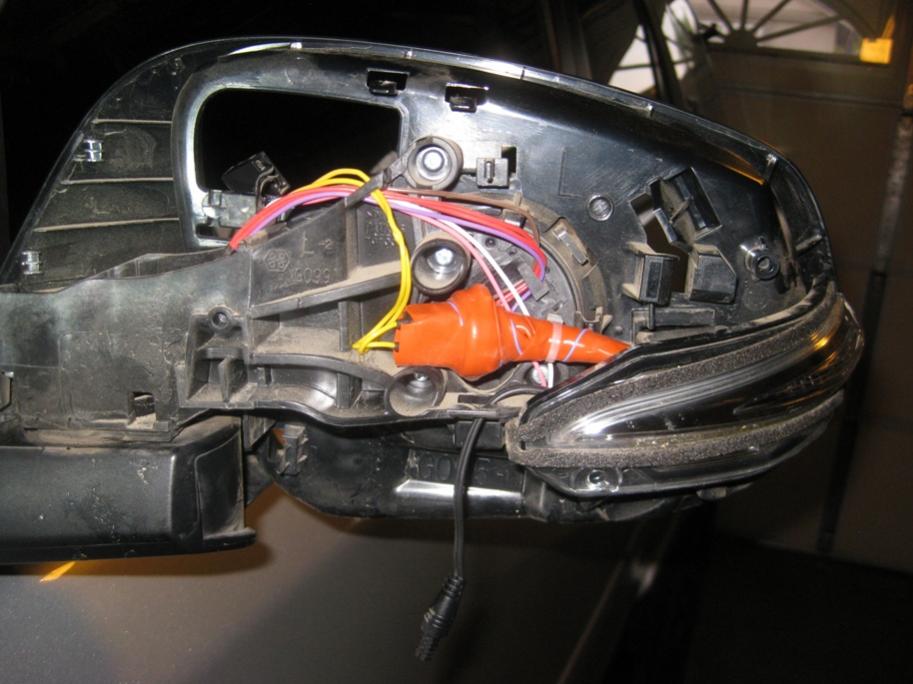

Test fit on the mesos as i refurb my mirrors to have the puddles. This is on OEM mirror housing. Ignore the color mismatch as the housing has been sanded

Got mine in today and once in place it clips in and screws hold it tight and secure. The wiring was easy, plenty of room up top to use the supplied connector high and dry.
Many have said the bottom mounting plate is not flush. Same here and had a slight gap. It was no big deal as its next to the drain hole but just the same used some black pipe wrap like silly putty and filled in the micro small gap.

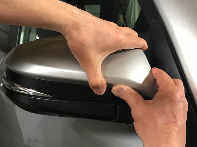

[MENTION=148968]Bill_Sanderson[/MENTION], I have had my side mirrors apart many times, and have yet to break a clip or part. The key is to go slow and not blindly yank on parts.
Once you remove the glass and have access to the clip on the painted mirror cap, release it. Then start along the top outermost edge/corner of the cap and slowly separate it from the side mirror assembly and work your way towards the edge closest to the cab.
The write up's you found are pretty good. Just follow those and you should be fine. :thumb:
Yes, very good advice. As with so many other clipped-in pieces inside and outside the 4R, if you know where to grab and pull, and you go slow and deliberately you will be OK. But the first time attempt is kind of nerve wracking, with all the noise of clips releasing.
What I found daunting was the idea of pulling off the mirror. I didn’t trust myself to not break something. I was more comfortable with the painted cover removal method. I’ve used this method four times with no problems. (The main grab point to start is the pointy section toward the window). It gets easier each time. See post 20 below for more info.
