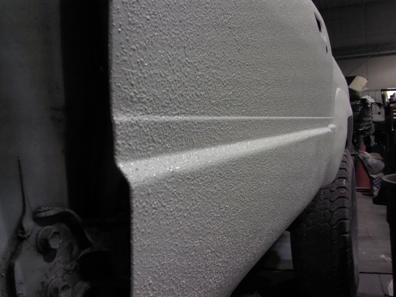

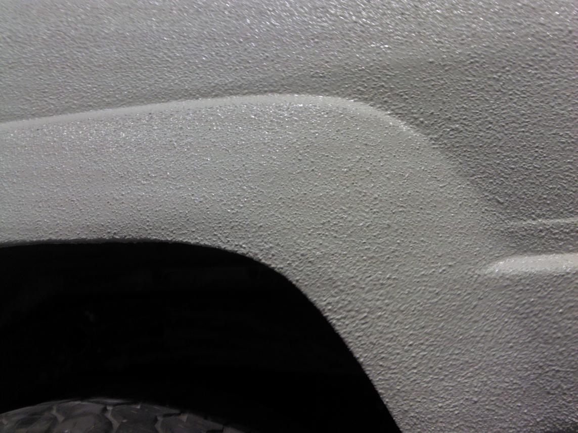

i did my hole truck in 1 gallon of hurculiner white the kit cost 127 shipped
i can say its not heavy at all it
the reason people think its heavy is because its typically seen in truck beds, in truck beds they recommend 4-5 coats. i put 1 coat on the body of my truck and got a nice look and tough exterior
