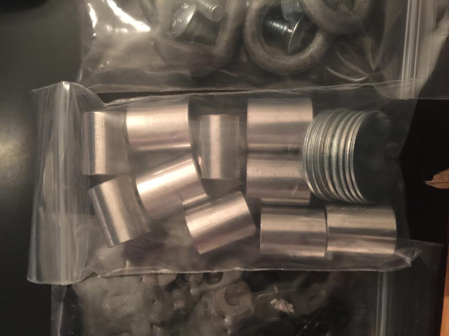

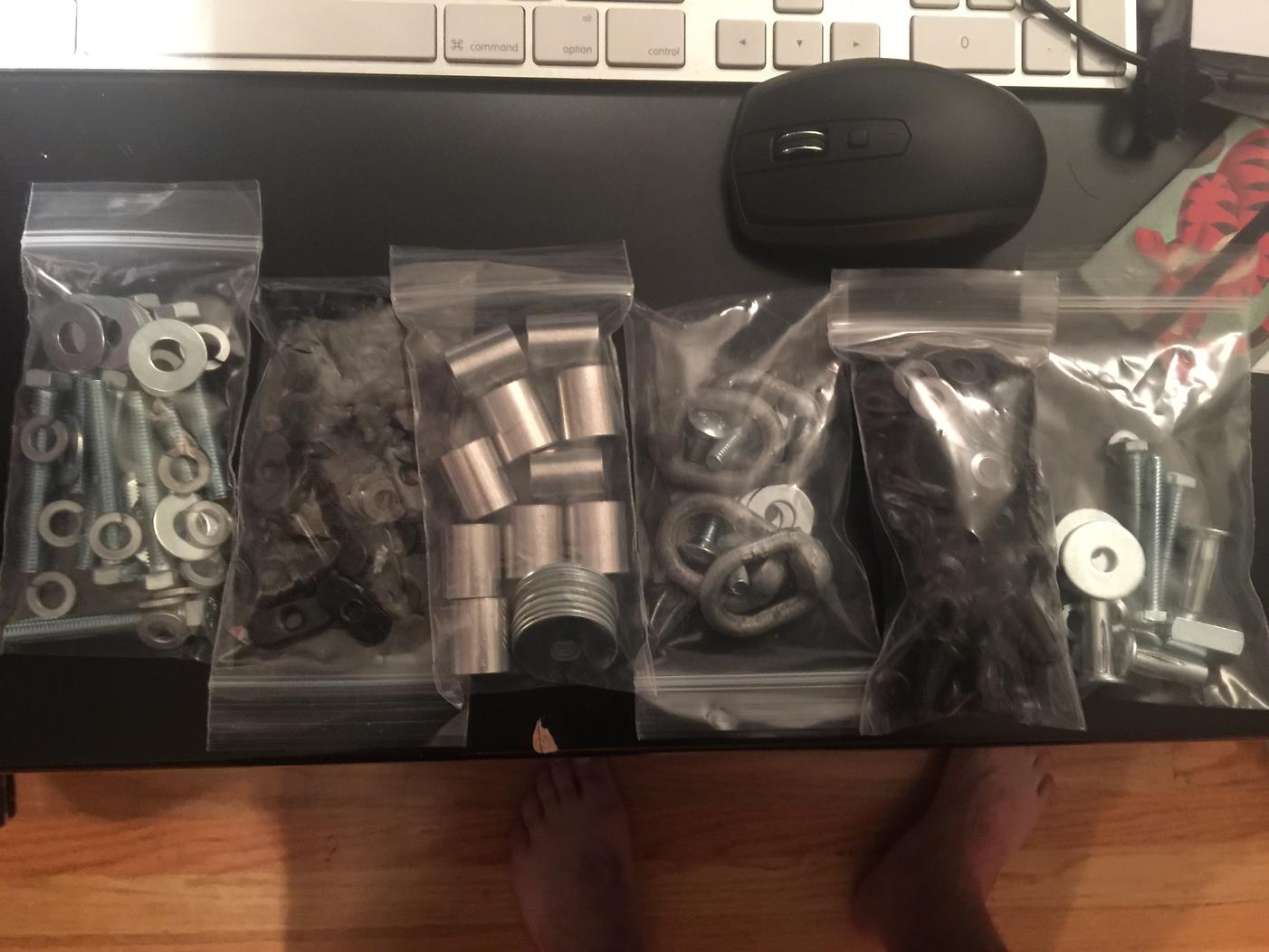

Hey guys, running into a slight problem. This question is for anyone who has installed a full length Prinsu rack. I seem to be missing a spacer and hoped someone could verify my parts that came in today.
Seems I have most of the parts, but I'm counting 7x 22mm spacers for the factory 8 mounts (so missing one). Also, I'm counting 4x 25mm spacers for what I assume are the front 2 plusnuts. Can anyone confirm how they set up their racks?

These are all the parts that came with my rack (have t measured any of them or even considered if I have the right stuff yet though haha) if you need more info, let me know

Thanks soo much, it does look like I'm missing one.

Haha sorry, mine came in 2 separate bags so it was easier to tell. Here are the notes from Zach...he emailed me back earlier today. Hope it helps with the install.
"The shorter spacers go in the back factory holes (2 per side) and the front holes you will drill (1 per side) so you should have 1 extra. The 4 taller spacers go in the middle holes (front factory, 2 per side)."

i thought the same thing when i got mine, but he stuck them in separate bags. just wait till you put the cross bars together - you're going to shit on the number of split rings you have left over. i think he measures it by the weight when he fills the bags

Thanks for the info; I may email him as well, because all of my spacers are one size and short.
