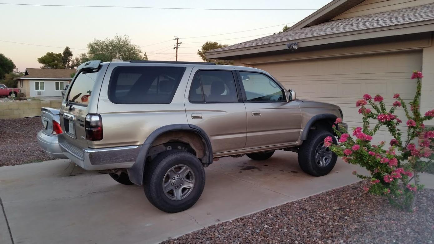

ive got about a 5.5" lift in the back and maybe 3.5" in the front, mostly it would bring the front up and give more clearance in the front for wheels.

I can't really think of a reason why it couldn't be done, there's no critical alignment between the body and frame that has to be kept parallel. The only tricky part would be in making all the spacers front to back the correct heights. The angle is probably flat enough that they don't need to be slanted, but you'd still need to drop the height from 2 to 0 (well, that's one's easy lol) in 4 or 5 steps, based on their position between the front and rear mounts.
Well I could cut a set on the mill. And the only thing I could think of not lining up would be the sliders and bumpers, but since I'll probably be making my own it probably would not even matter.
Front bumper is mounted to the frame, you'd need to move that up 2" either way (the slight difference between 2" at the front body mounts and the bumper is meaningless). The rear bumper mounts to the body, so no issues there until you get a cooler looking bumper that mounts to the frame. But even then, 2 inches over 15 feet is a very slight angle, you're probably not going to notice it even if it fit fairly snugly around the rear quarters like the stock one does (and frame mounted rear bumpers can't fit as closely anyhow).
It does seem to be a case of the tail wagging the dog, though. Raking the body to make up for a difference in the front and rear suspension ride heights.
Once you're able to upgrade to larger tires that rake won't look nearly as bad.
I would do the tires, and revisit your idea later if you think it's still needed.
That said, if I were to do it I would cut the pucks at angles to be sure they'd still line up and sit flush.
I haven't seen it on a 4runner, but I have on a Jeep. I know a couple people that did it on some YJ's to help even everything out. You just to to taper to pucks in the middle. Install your front and rear most pucks, and then cut the middle ones to fit. There's nothing to it, and it's just as safe as a normal body lift.

I can see body mounts distorting if the entire body is at an angle.

The only issue I can see is that the bolts won't be exactly straight but they will only be off by about one degree.

Not sure what "then" you're referring to that would make them straight up and down if the pucks at one end are thicker than the other end. The body where the pucks mount should to be parallel to the mounts on the frame.
They are some led lights I made from scratch. Yeah thats the point, right now the body and frame are sitting on a slant, the pucks will level the body.
Yes the body will be level with the ground, but the frame still won't be and the body won't be parallel to the frame. That's the issue. The body and frame mounting surfaces should be parallel to each other.
Well that's how it came from the factory, the body is mounted directly to the frame, with the factory spacers. Just because it didn't come from the factory slanted doesn't mean it won't work, at the factory if they wanted to level out the suspension they would just move the suspension mounts, I can't do that so I'm going to use angled body lift pucks to level the body to the way its meant to sit. I'm still unsure of why you think this won't work.
