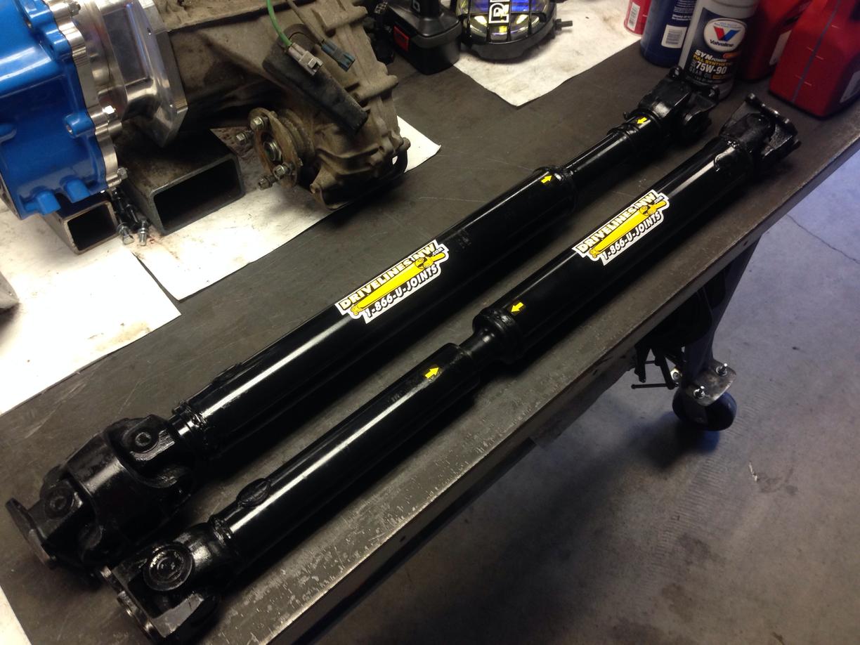

No real progress but I got my shafts back from the driveline shop today. Had them re-lengthened +8.5"/front and -8.5"/rear for the dual cases. Now if my crossmember ever shows up I might actually be able to get my runner done. :redbrick:

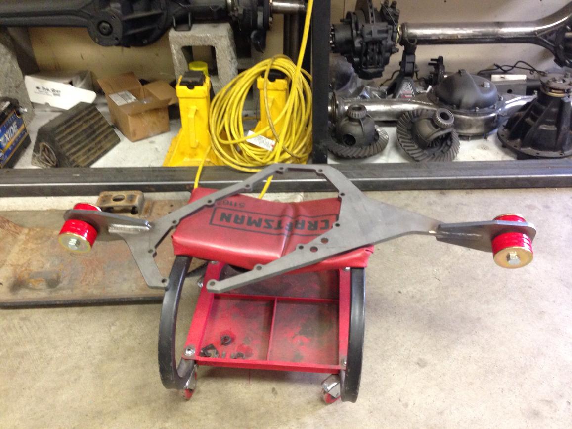

The final piece of the puzzle arrived today! Got my t-case crossmember from front range. Finally gonna get my rig back on the road...I mean trail:clap2:. I'll be posting install pics as I go.

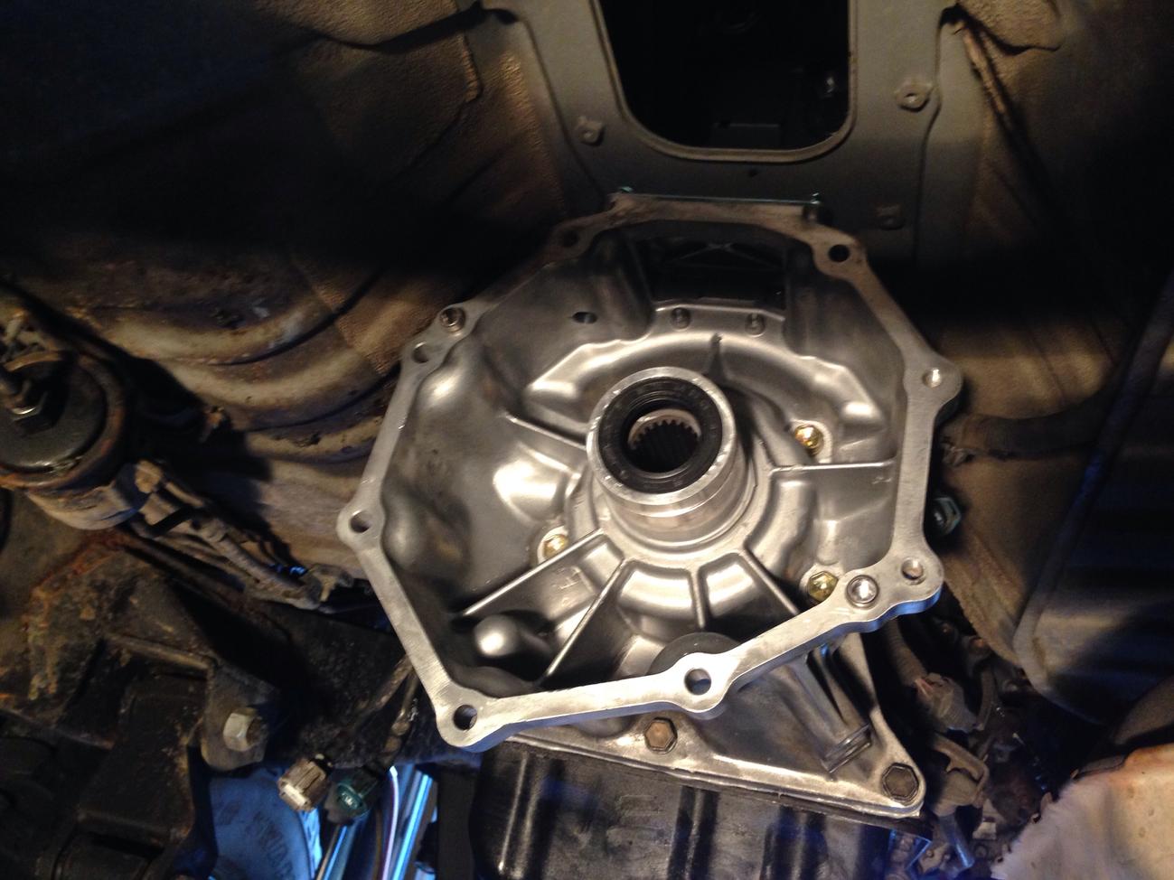

Just a little update. Been gone the last couple of weekends so I haven't had much of a chance to put in any major time into the runner. Everything that I've done since the last post has been last minute trips out to the shop in the evening when I have nothing else to do to work on it for an hour or two here and there. I did get the duals in. Have to hack the factory mount for the front of the fuel tank to mount the crossmember then fab a new mount for the tank. It was a really tight fit but I should be able to make it work.
Here's the tail housing for the tranny installed with the seal adapter and 23 spline coupler.
