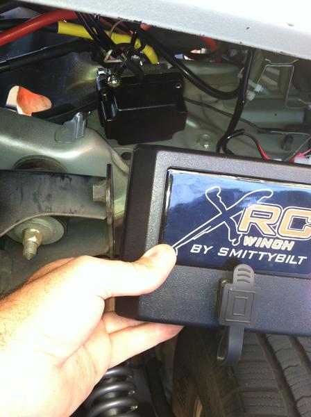

I decided to take apart the 'control box' that came with the winch. Really it is just an over-sized relay with a plug-in for the 'switch'.
I mounted the solenoid/relay here...
It's in the driver front bumper area on the other side of a 'vacuum canister'. Had to use some nylon washers and longer bolts, but it's sturdy.
Since I was dissecting the 'control' box, I decided to mount the receptacle for the 12' control lead in the cab.
Don't know why they make those boxes so big, it just makes things difficult.
Any thoughts on how to waterproof the relay in the first pic?
