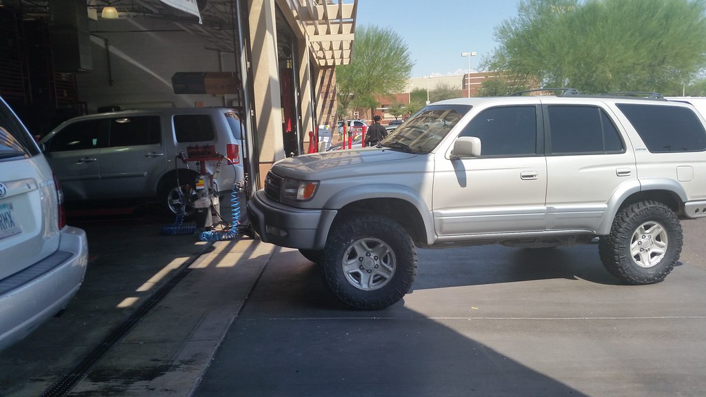

decision has been made...
Just put in my order for Nitto 285/70r16... monday will be installed...
excited... finally I get my meats back... miss my 75 bronco...

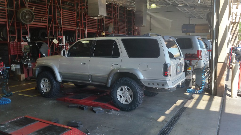

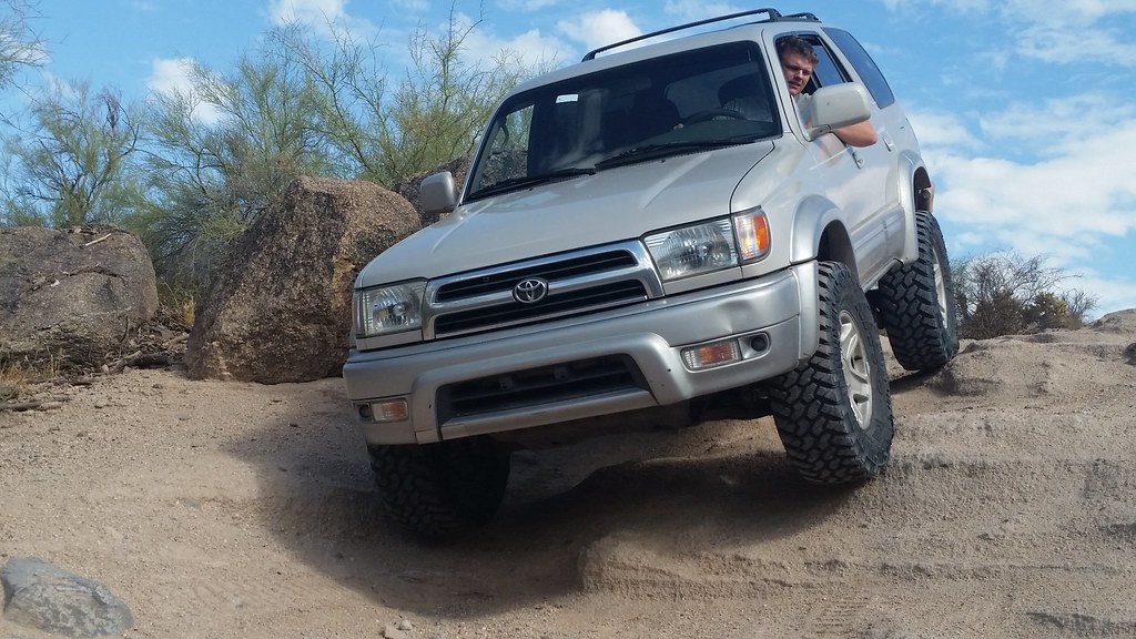

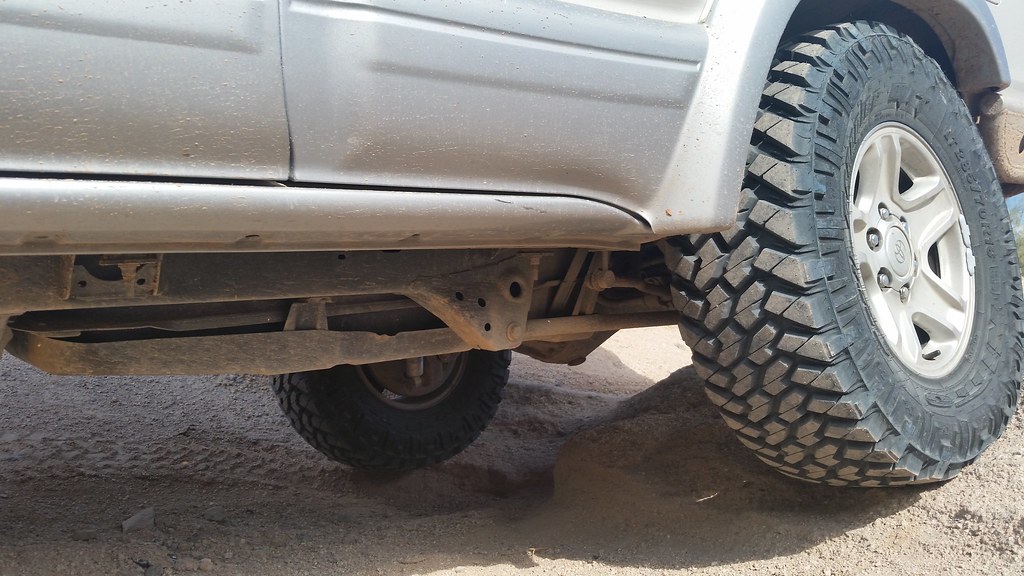

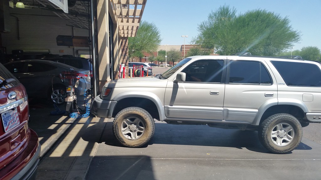

Getting Tires.........

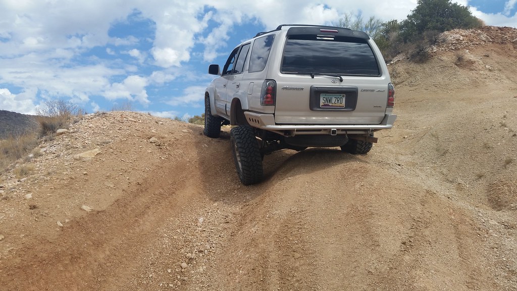

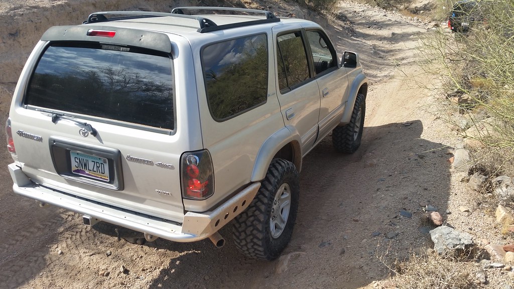

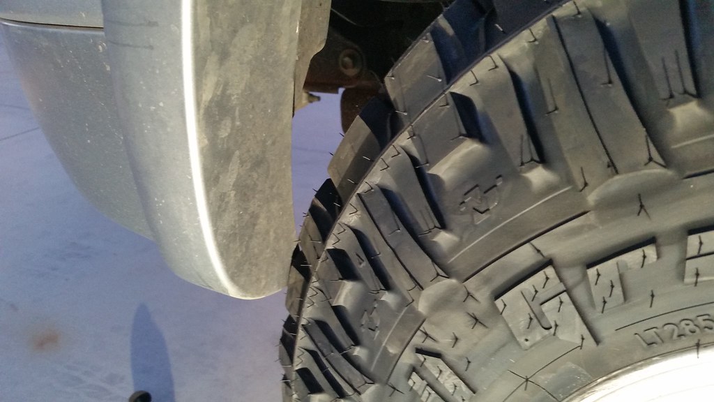

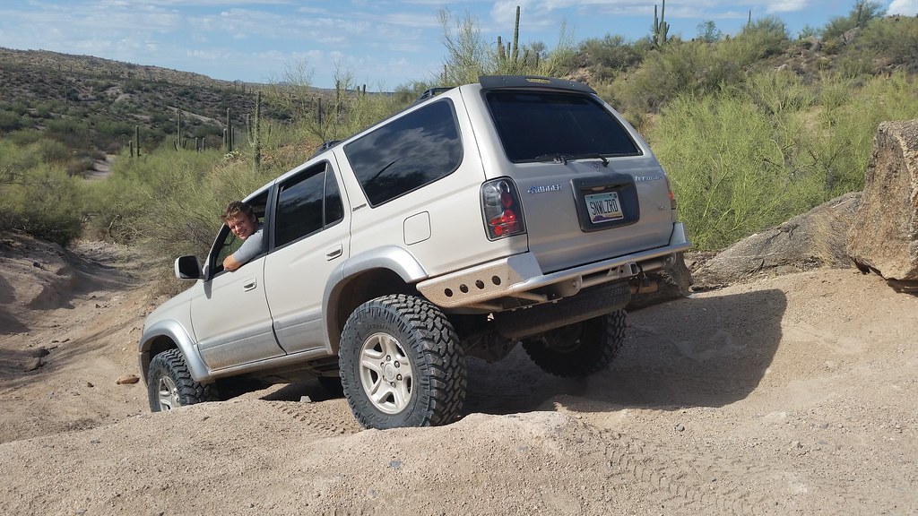

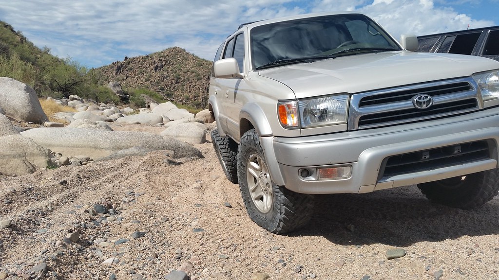

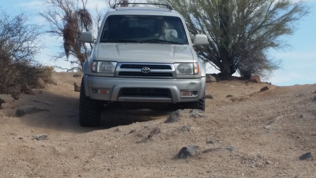

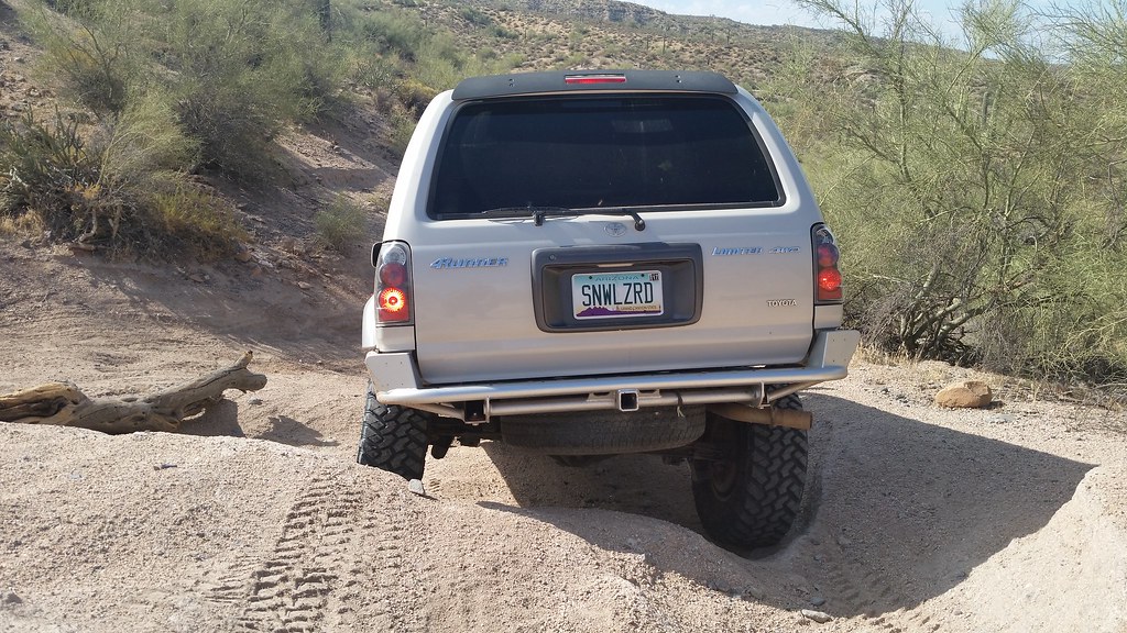

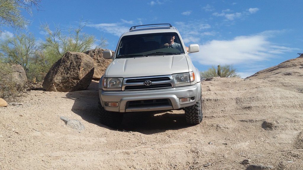

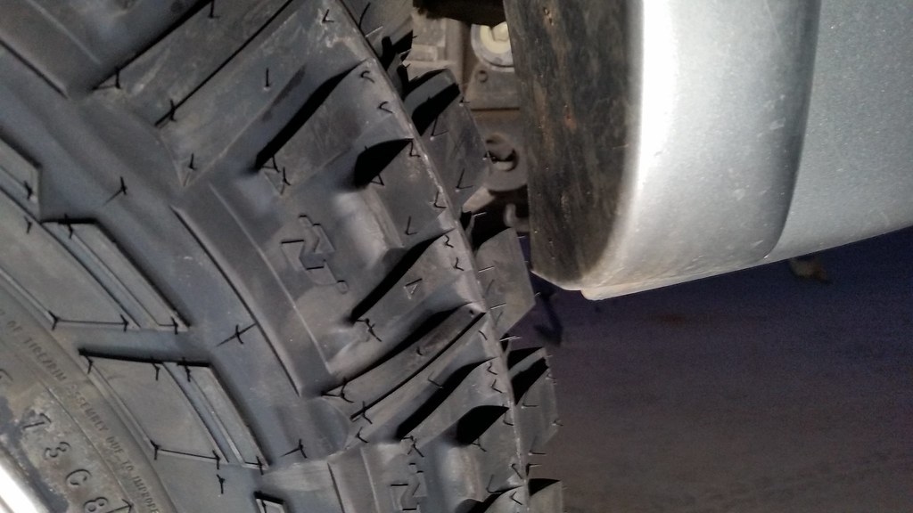

Front rubs like expected... I'll need to snap a few pics of the clearance I made.
Rear clears in the parking lot... not so much in the desert. still need to clearance.

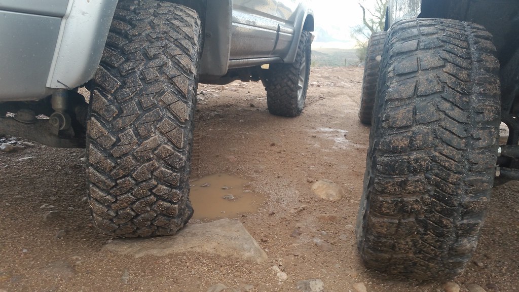

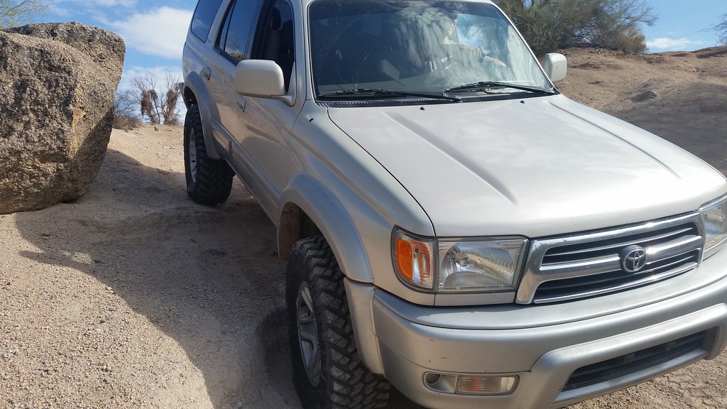

After tires.......
So I've been busy lately, and I have alot more pics... but oh well...

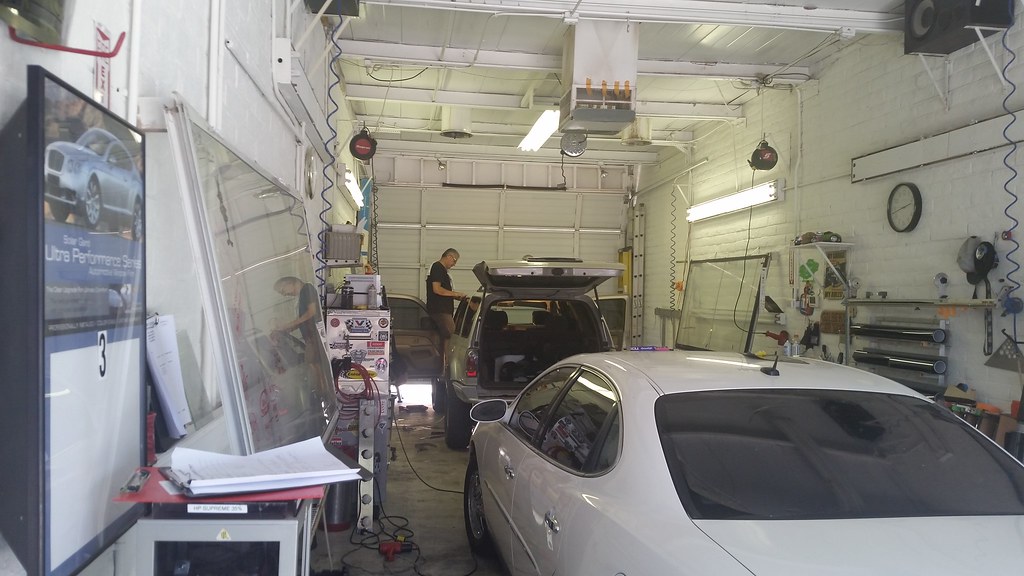

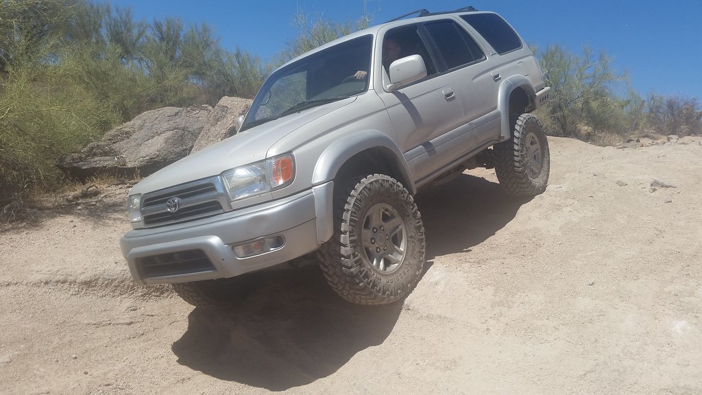

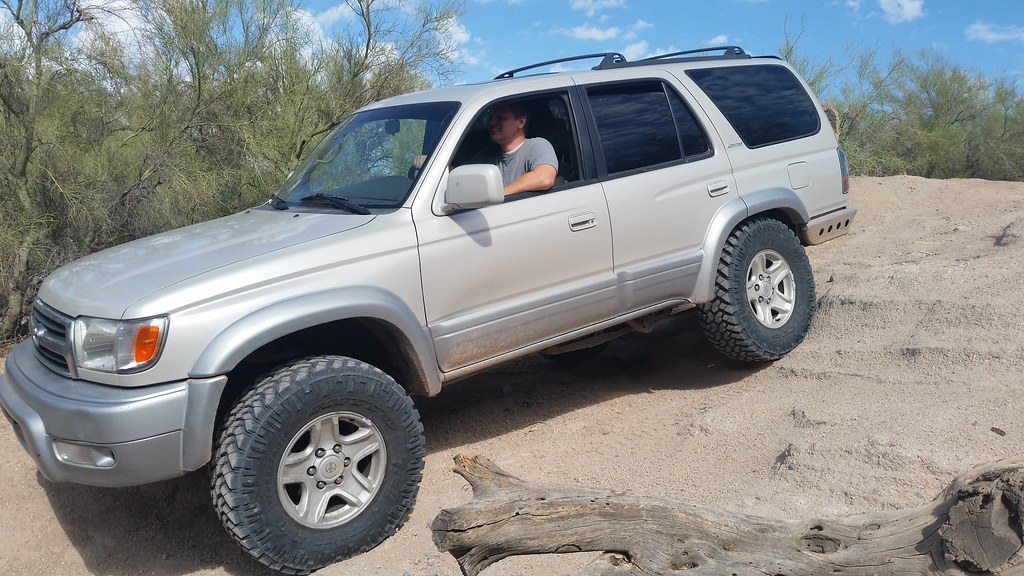

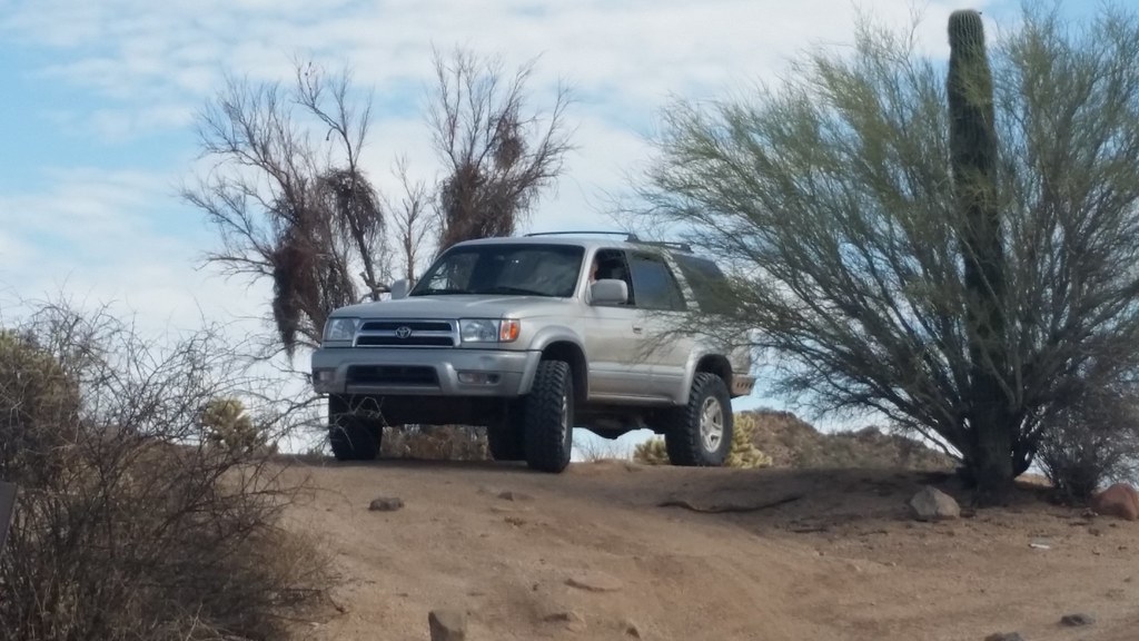

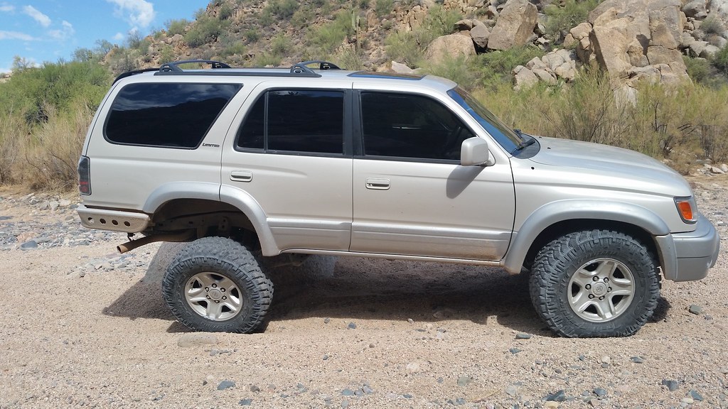

got a new job and decided I'm getting tires and window tint. the tires I went with is the Nitto Trail Grapplers, 285/70r16 it's a 32x11.5 on 16" rim... I wanted the 285 aspect, but knew I don't want the 33inch tall tire. I'm very happy with the purchase.
the tint is nice, but i didn't know the rear windows weren't tinted, just colored glass, so I pulled the trigger and did it all, it's effectiveness is crazy, it did make the rear windows more tinted, but I really like the AC now, it actually uses the 'auto' temp and gets there at least 75% faster. worth it.

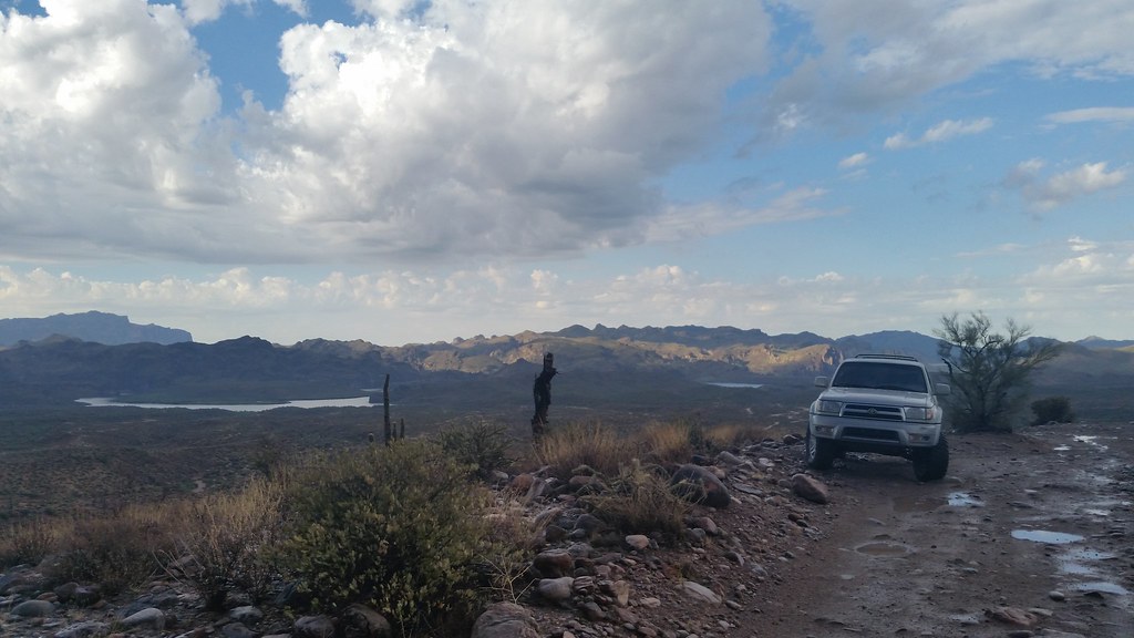

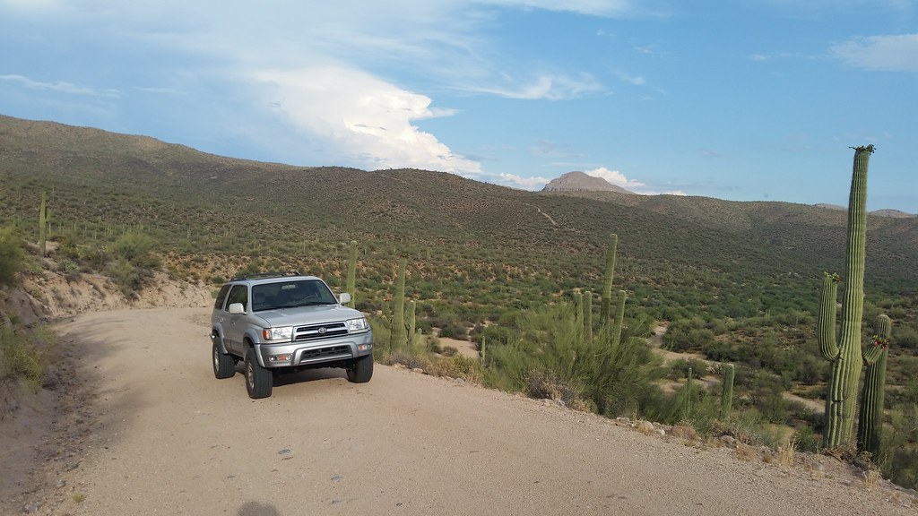

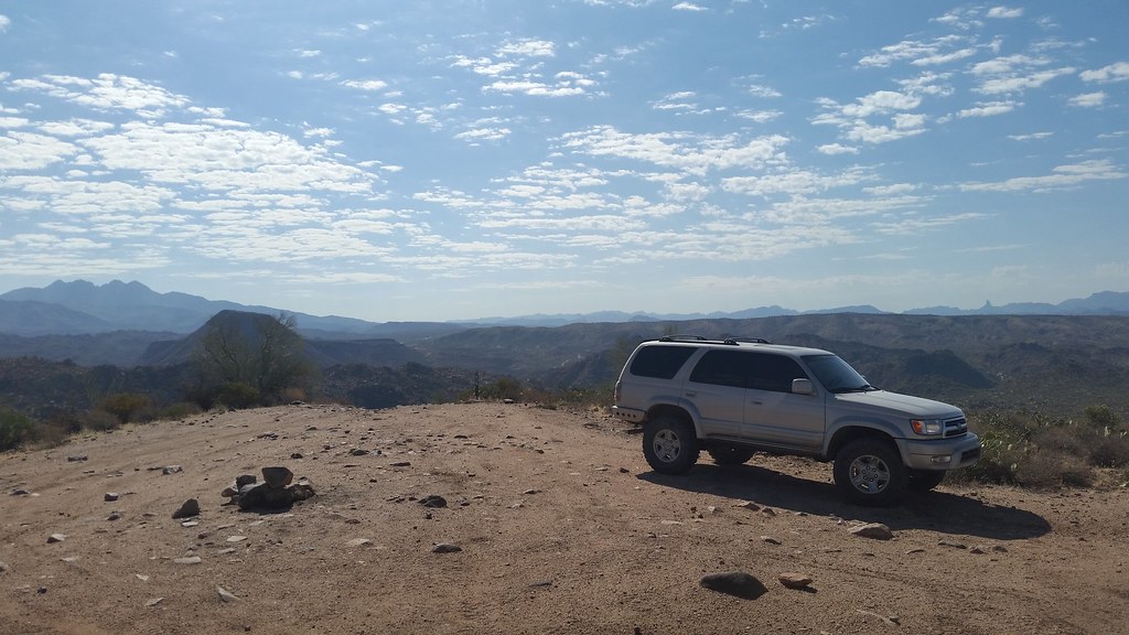

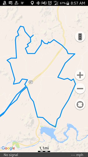

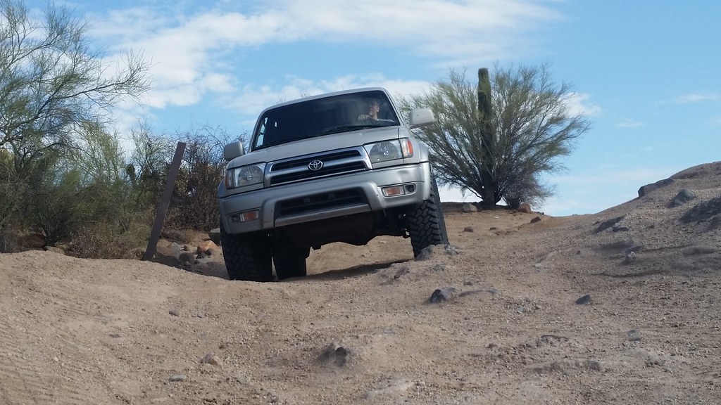

the trails were fun, I've tried to keep them in order, oh well. in here is mostly AZ desert, some utah mtn's and more az desert...
I need some more tree's where I live, or just need to get to the tree's...
