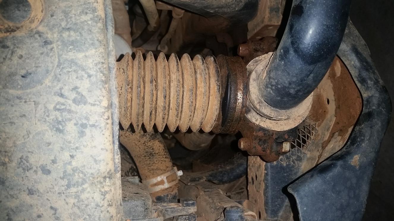

I walked out to the truck today at work and noticed this... then threw up a little in my mouth...
As you can guess, that is directly under the front KDSS cylinder.

Did you have any other fluids changed recently, could be residue from that.
The Hydraulic fluid utilized by the KDSS system is almost a clear-yellow fluid, the picture you show of the blackish fluid looks as though it may have come from somewhere else.
Interesting. No, nothing changed too recently. You can't see it in the pic, but since the fluid was (literally) dripping off of the bottom of the KDSS reseviour, I made a quick judgement on it. And yes, it is definitely a black/dark colored fluid. If that truly is the case, perhaps there's another issue. When I get home today, I'll climb under and look around (and pop the hood to snoop around the engine bay too).

oah how ironic this is.... I'm going in tomorrow for the attached. ONly mistake i made was i cleaned it off in the hopes to monitor it so they may call BS on it.
Anyhow, my beef is that everytime I go into the dealership it is 2x to fix what they said they did like not putting all the skidplate bolts in or doing all the Techstream updates that i PAID for.
This trip is for a creak/ bushin noise after the 30k service and i noticed the oil on the KDSS. Maybe its in my head and they are super sloppy draining oil as it is about 10" away from the filter but who knows...

Dumb question but did the KDSS light come on? Would imagine there's a pressure sensor somewhere in the system to keep an eye on these kind of things..

No light for me.... yet but as im at 31k this is the last thing that i want to get stuck with.... I have had 5 T4Rs but this is the only "fancy" one with the KDSS.

Not a dumb question at all, at least not to me... No, no light for me (anywhere for anything). I am just REALLY OCD/ANAL... every time I walk up to my truck, I’m always looking for something. I.e. fluid leaks, dents, low air, cracks/nicks in the windshield, paint scratches, etc., etc. I’ll be curious to see if there are any drip markings on the garage floor... have to take a gander when I get back later.

Well, should be interesting for both of us. Same truck, same year, same exact suspension set-up (almost), 38K miles for me. Tho, if [MENTION=144093]tpetsch[/MENTION] is correct, I’ll be very interested in seeing what’s up with mine... cuz mine is definitely dark fluid, not clear/yellowish... but like you said, KDSS cylinder isn’t anywhere near the (oil) filter, so WTF?....

It's easy to jump to conclusions... Take a deep breath. There's been next to zero design defect related issues reported since it was deployed in 2008 on the lc200 and gx and that's a lot of vehicles in service. If you have a lift installed or have altered the suspension kdss will not be covered since you've changed the vehicles suspension geometry.
