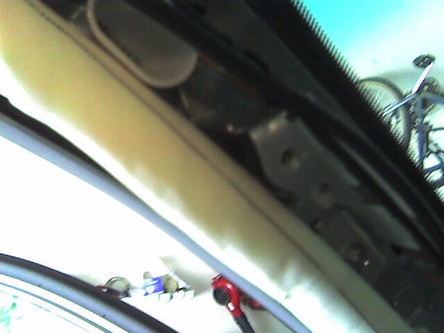

I have the SRS airbags and the bag is right there in the A pillar as Rando suspected (see picture if I attached it correctly).
It is not a problem, however, the keep the wires routed where they need to be.
