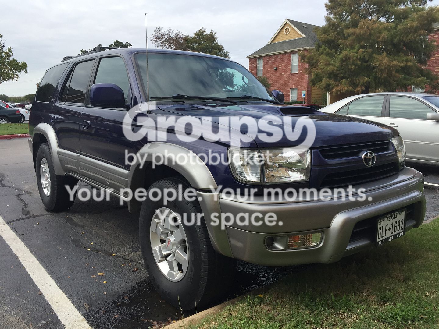

So since I have acquired SURF RUNNER 2.0 I have done a little more research on brake fluids. I am going to use Redline fluids all around including their new brake fluid. The Redline brake fluid has slighly better numbers than the ATE Typ 200 that I was going to use. The Redline is rated at 604 degrees dry and 400 degrees wet.
