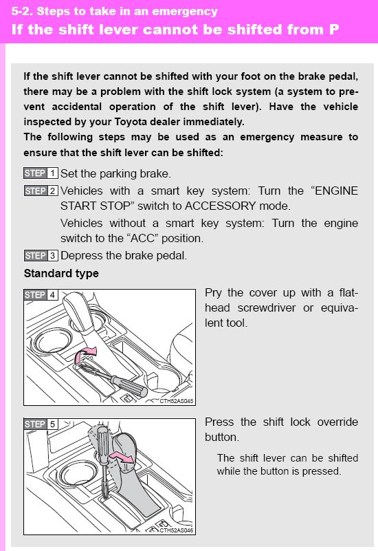

You are talking about the matching blank that is just above the "P" indicator of the shift lever housing? If you haven't done so yet, I would scour under the seats, etc trying to locate where it may have fallen after popping out. Looking at an online parts manual, it appears you would have to order the entire shift housing (a $328 part) to get the cover. It does not look like it is a separate item that you can order. I would confirm this with your local dealer.
From Nashman's uploaded manual.

the cover is what I'm missing. Its blowing my mind. I've never touched it, I cant imagine how it popped out, I've only got 340 miles on the 4Runner! I'm going to call up the dealer tomorrow and see what they can do about it.
Not having looked under the cover to see the override switch, is it possible the cover could have fallen into the override switch area?

That's possible, I might look into trying to get under there. I wonder if it popped out while I was driving?
It's not really a big deal that I don't have it, but it looks a bit odd without it.
Cover for the "shift lock override button" is what it's called if you want to call the dealer to find out if they sell it separate and it's just cosmetic or to keep crap from falling down in there.
