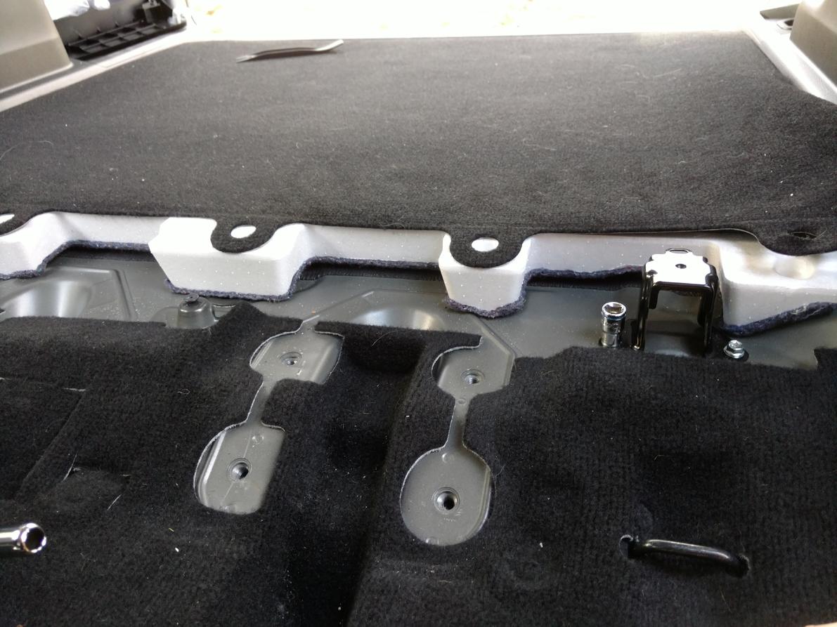

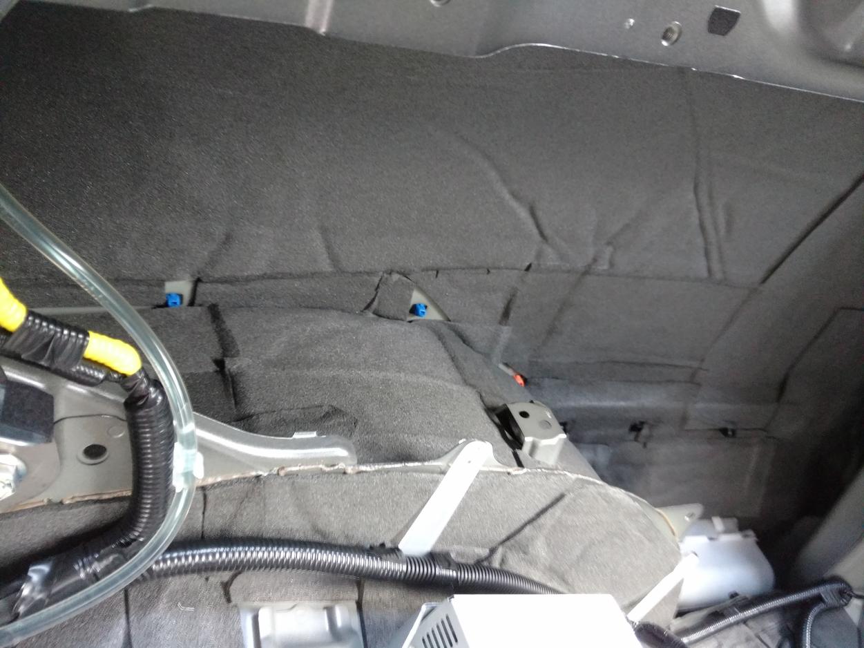

I know there is a thread about this on a 3rd gen, but haven't gotten a response over there. Plus, I have a 5th gen not a 3rd gen.
My question is, can I fit some sound dealing material and ensolite on top of that and still tuck my carpet back in. There is a lot of stuff under the carpet as is, another 1/2 inch or so might be pushing it.
Has anyone done a lot of sound deadening and have advice? This will be my first time.

Curious to see what you do and how it helps. I have the seat out of mine and it seems like all the noise is coming from the rear wheel wells. If I get bored I,m gonna take the trim off and stick some ice dam roofing material on the bare metal and put some sound matt type stuff in there.
I'm using the roofing stuff because I have a roll sitting around.
I did see some of the stuff that toyota has there, didn't impress me, and I plan on taking it off too.

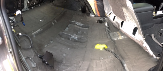

I did a little bit Sound Proofing
I ended up scraping off what was under the carpet for something higher quality.
WOW! I didn't click the link until just now, you did a ton. So let me ask you, did you just remove all the foam crap they put there and throw it out? Should I get some MLV and put it over my ensolite and between the roadkill, ensolite and mlv it would be better than what was there originally? Or do I put it under the factory stuff, then put all the factory stuff back on?
Brian ( [MENTION=120209]tigger[/MENTION] and I both did a lot of soundproofing (Brian, much more than I did!), and it made a huge difference in noise reduction.
I left the foam plate there, and did a bunch of fatmat XXL (80 mil) under it, as well as sound insulation (the metal-backed stuff like THIS), vehicle is super-quiet now, but we both did the doors, rear quarters, tailgate, floor under the seats, etc.
Doing just the rear part will not make a huge difference, as a lot of the noise comes from the door panels from what we've seen.
If you do the same areas as Brian, and follow along with his soundproofing thread, you'll have a pretty quiet 4runner! Like I said, I didn't do nearly as much as he did, and my 4runner shows 55db @ 65mph on the highway, that's pretty darned silent if ya ask me!

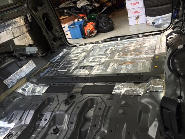

Okay, I think I should be good with the roadkill and ensolite, maybe do a couple layers of ensolite. I already have the metal stuff in my doors and hatch, I am going to be doing everything behind the driver's seat to start and then maybe the drivers seat after depending on how it goes. Maybe I will apply some ensolite over the door roadkill stuff

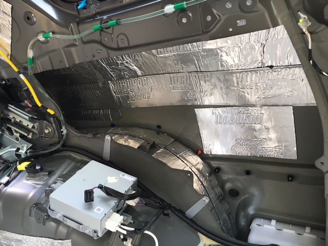

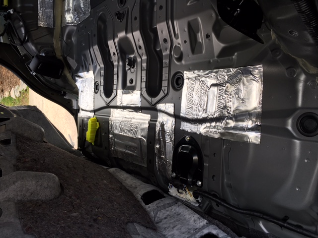

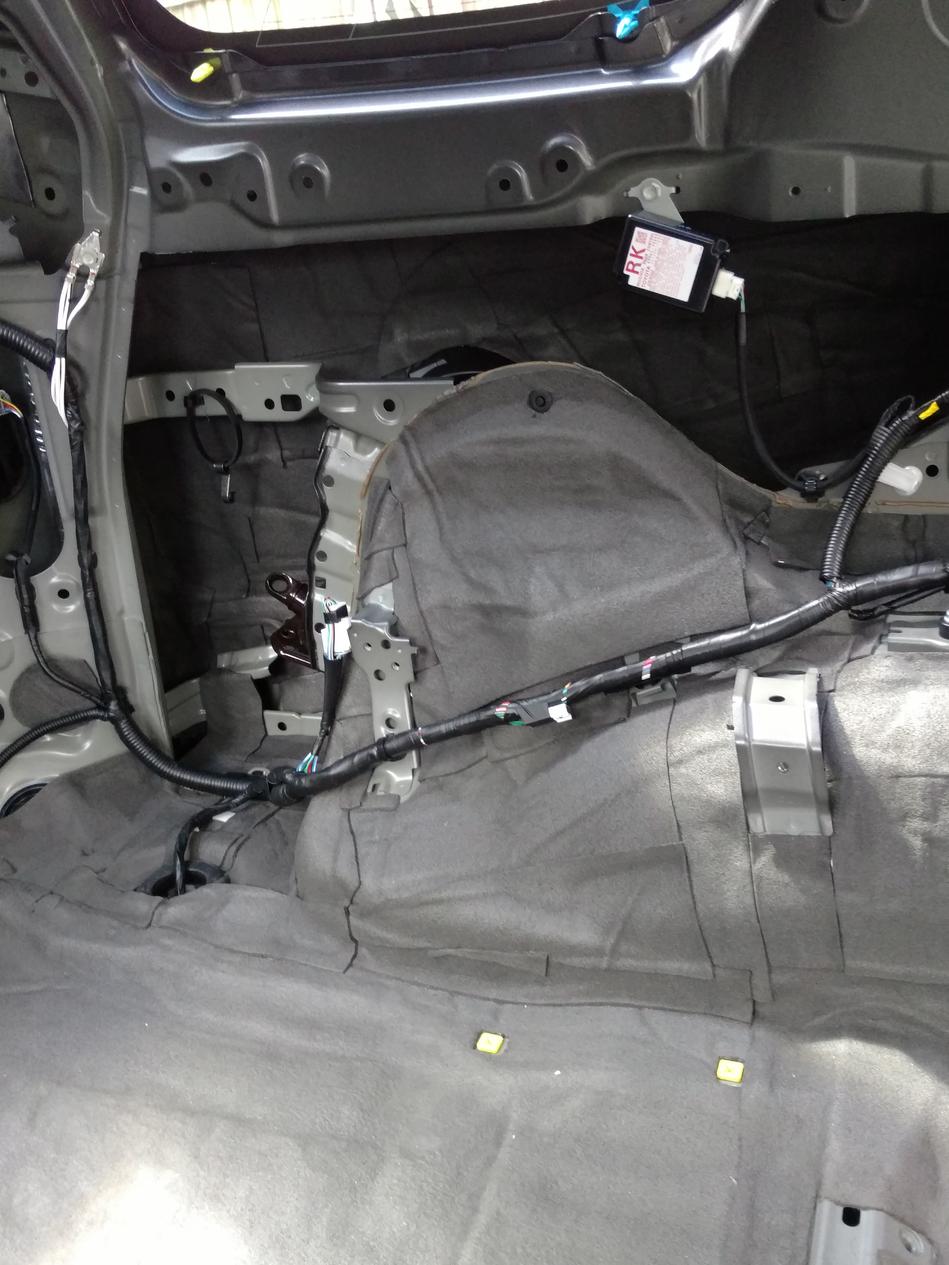

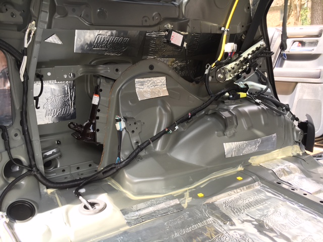

Here's where I am at right now. Any places we should add more? Besides doors, they already have some,but maybe add more down the road.
Comments welcome!

Keep in mind, what you have added so far is more for vibration dampening than noise reduction, although it will still help a lot. You definitely need to add something else over the wheel wells. Radiant barrier, Closed Cell Foam, MLV, something. You will get more noise from the wheel wells than the rear bed.
I did leave the foam panel under the rear carpet, just scraped everything off the back of the carpet because the Radiant Barrier is so thick I couldn't put everything back together.

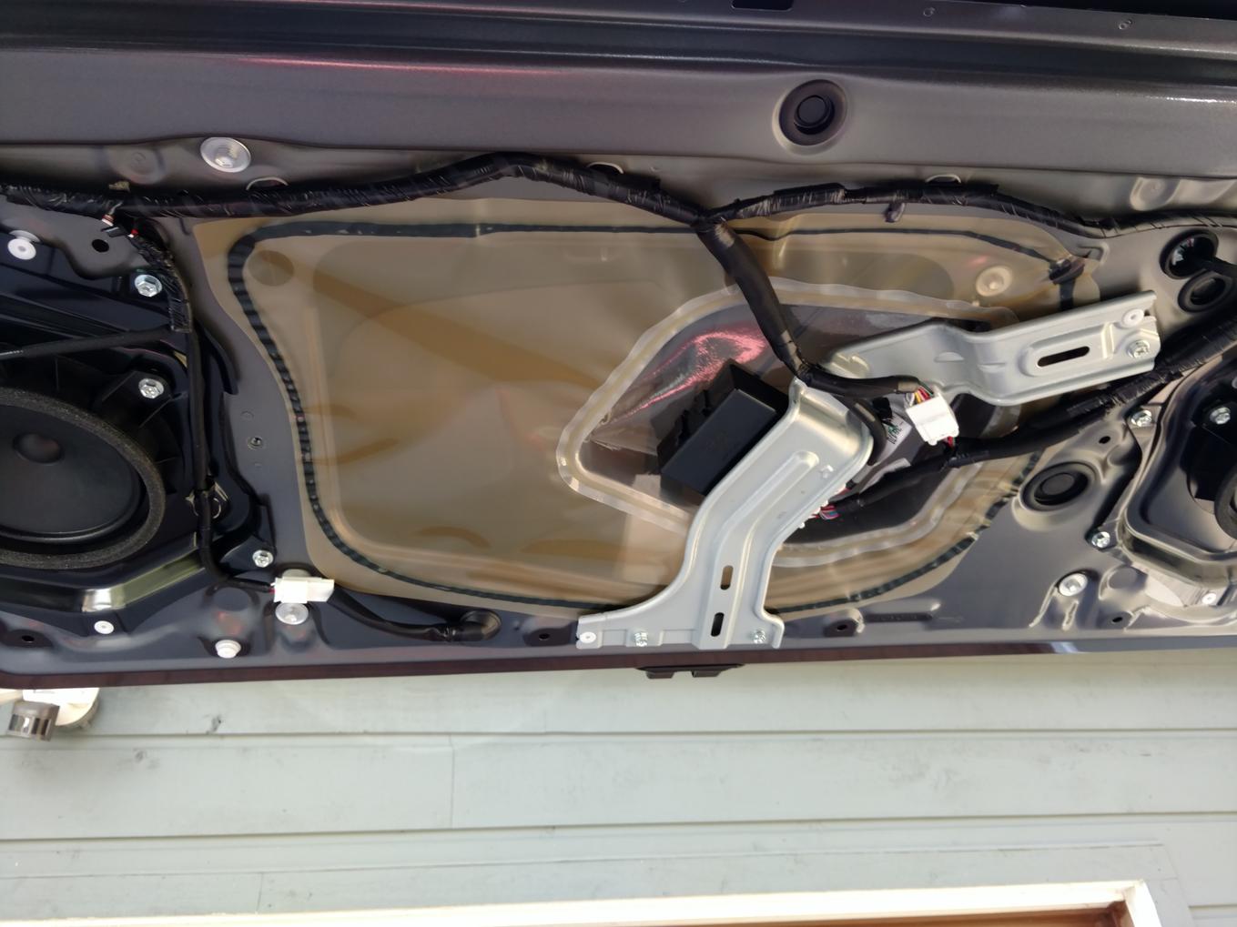

THANKS for answering everyone so far! Right now the only other question I have is can I peel this plastic off and put a bunch of stuff in there and all around?EDIT: I went back to your build pics and saw you did, do I have to re cover it with something? Or can I leave it.
It's a vapor barrier. It keeps the moisture that collects in the door during rain and car washes from entering into the interior. I covered mine back up with vinyl then put some CLD over it. (just to make it easier to access the inner section if I need to. (but yes, you should replace it with something)

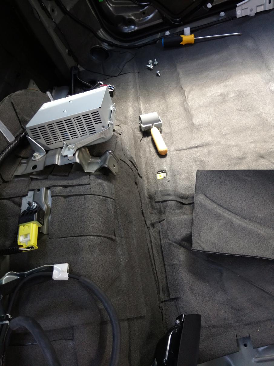

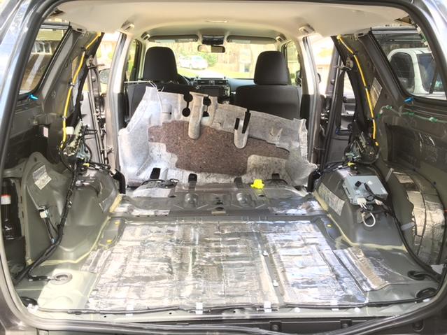

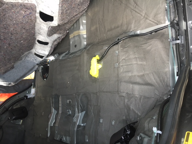

ask and you shall receive...we did a little bit more and covered a couple little spots that are bare in the photos. Also went all the way to the front of the passenger side, but only up to the driver side. Wanted to make sure we could get everything back together before we took the driver seat out. Will be finishing up tomorrow with the MLV and put everything together, already put it down and reinstalled the passenger seat.
The ensolite is really flexible and sticks well, I was happy with it. I haven't used anything else ever, but it was easy to work with..but it is way stickier than the tiles, and like someone said somewhere that I read, if you stick it to itself you have wasted the piece, go slow and you will be fine.
