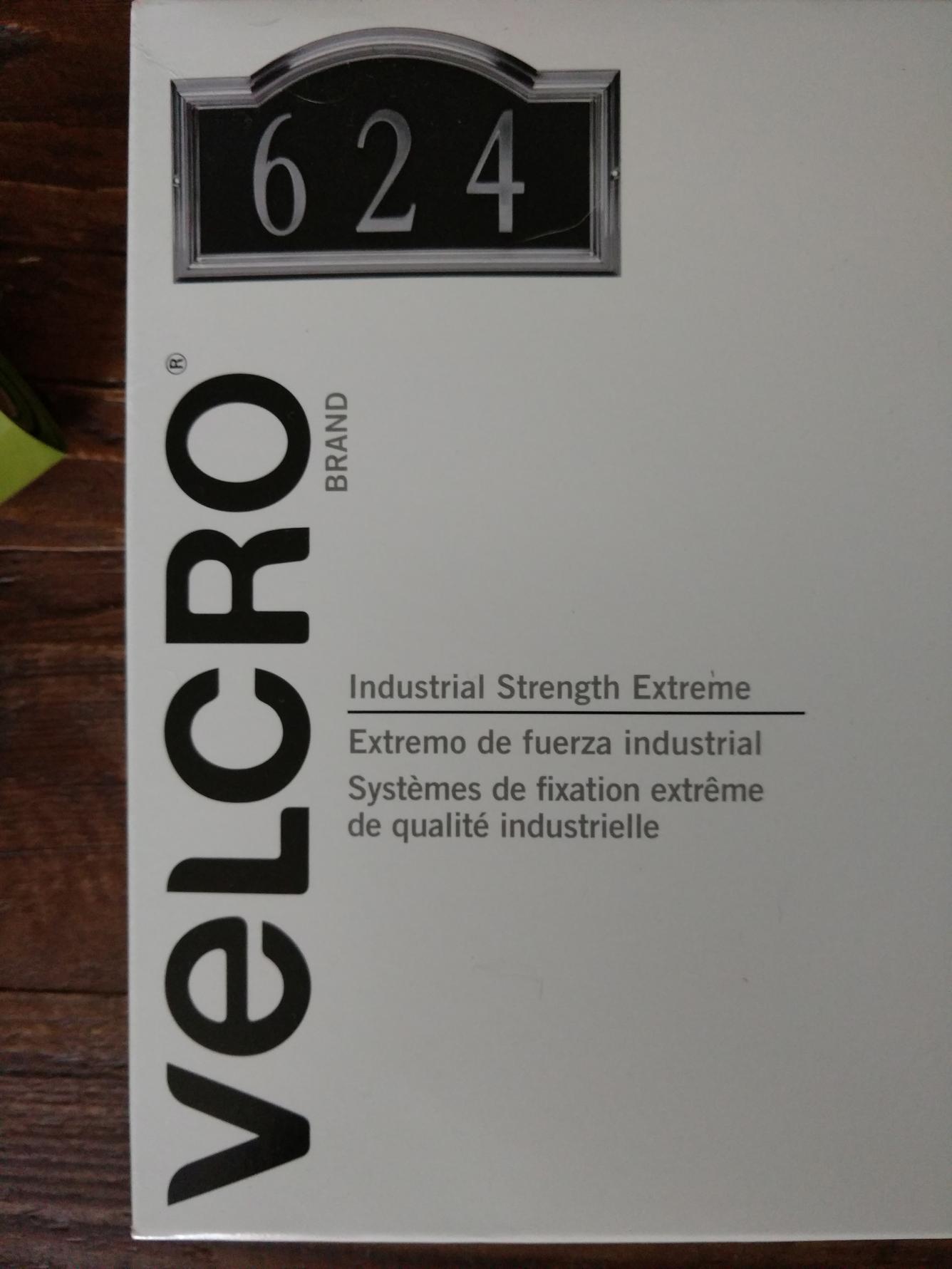

For the floors, just left it on top, it's heavy and won't move. For the wheel wells and doors Velcro. some people recommend glue but I didn't want to worry about getting some that would melt or smell. Industrial strength is what I've been using.
