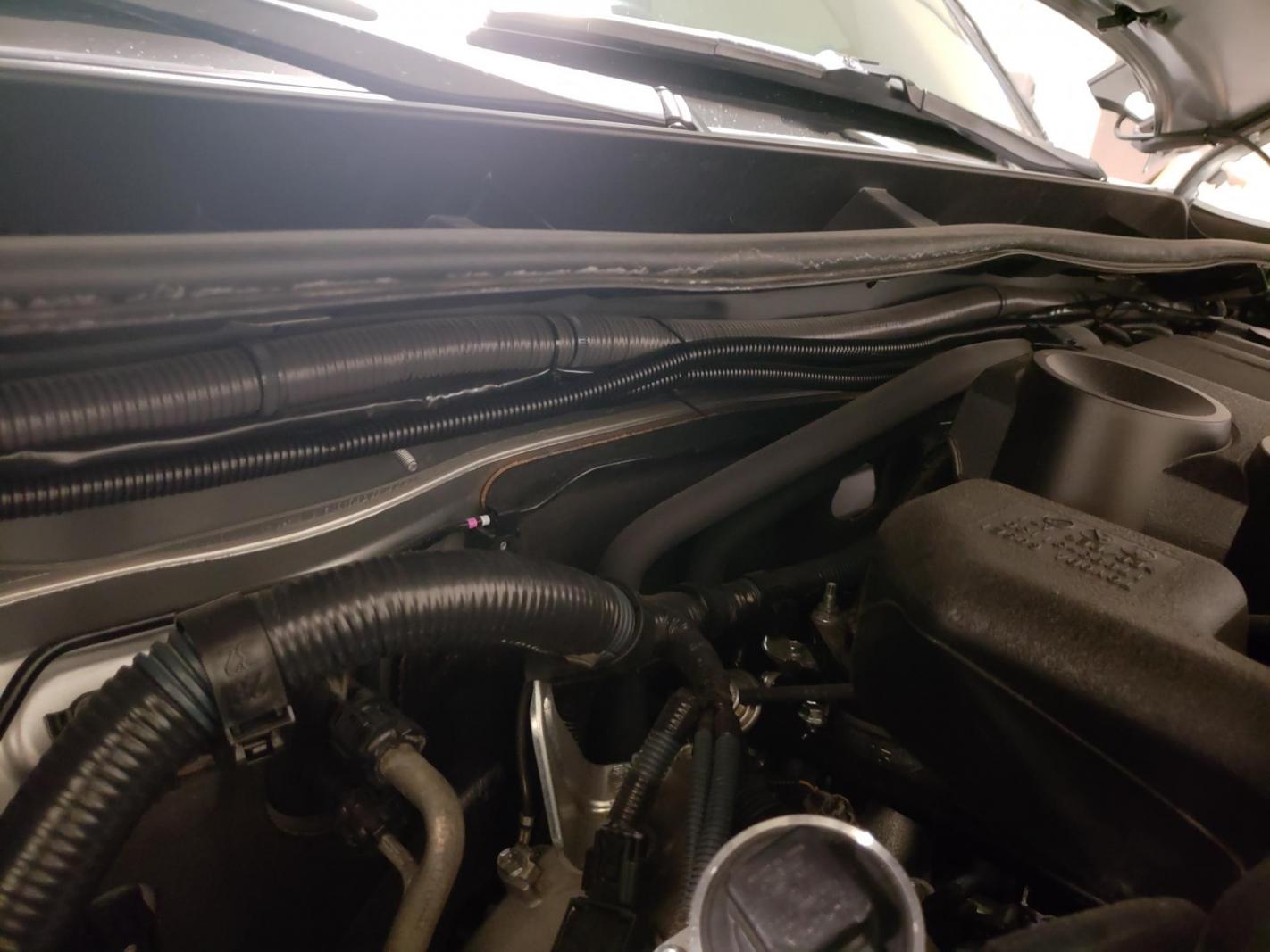

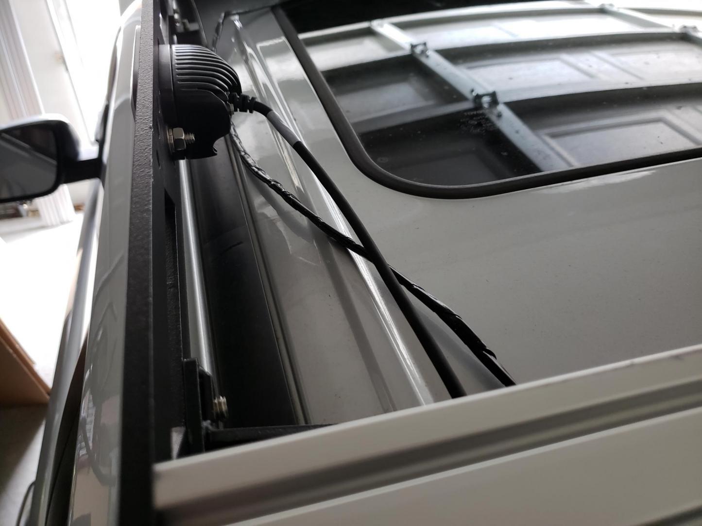

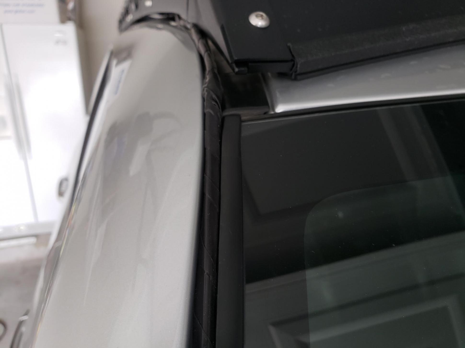

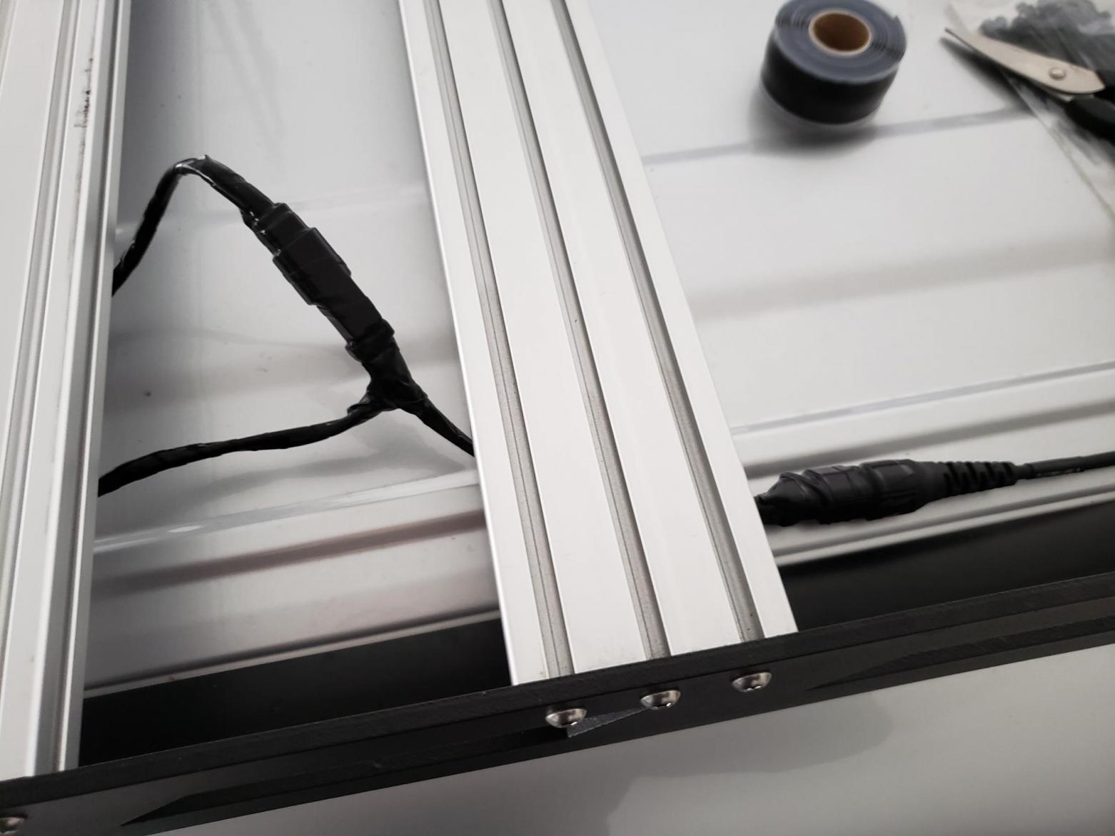

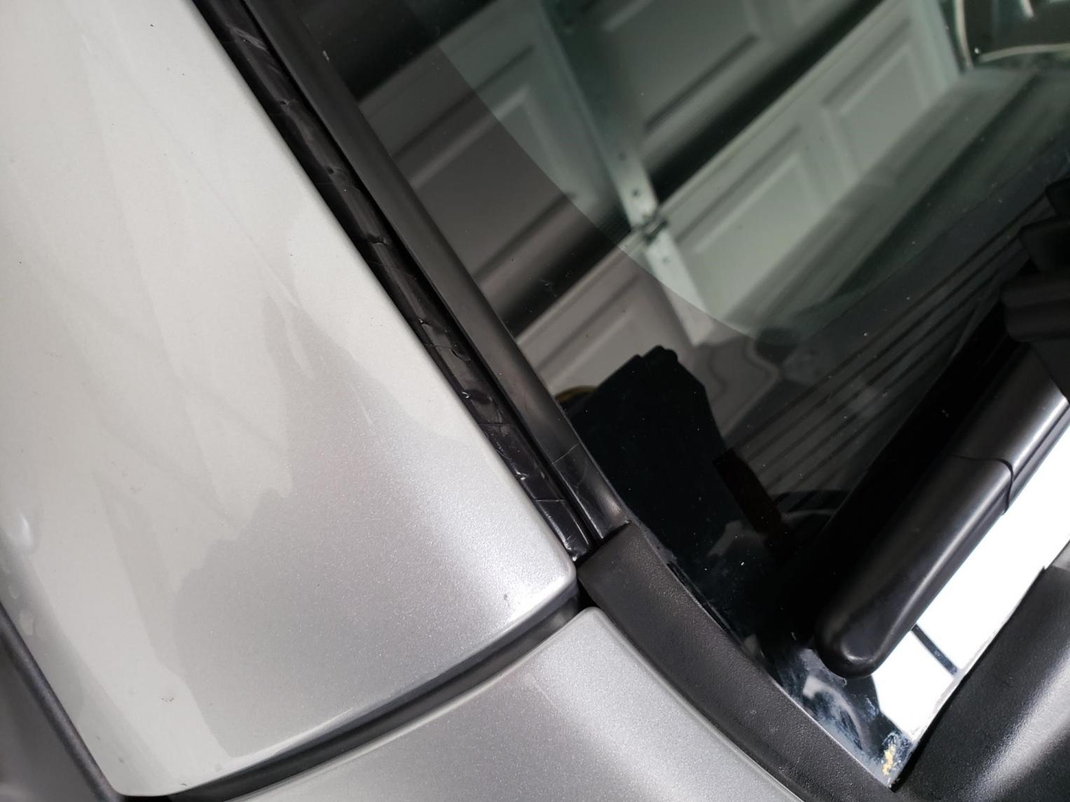

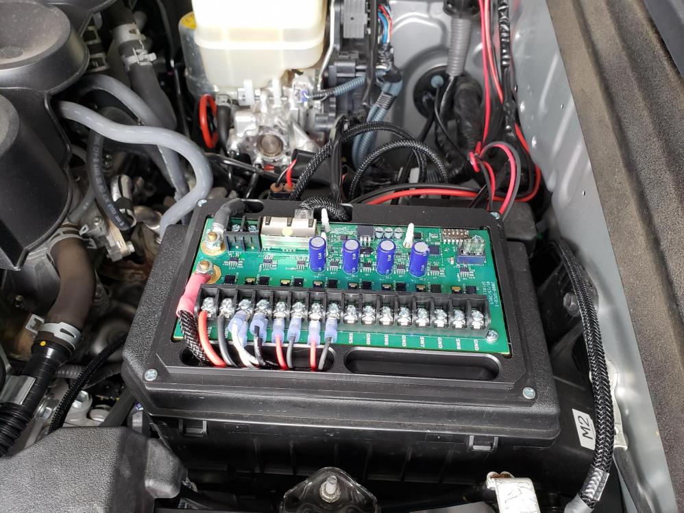

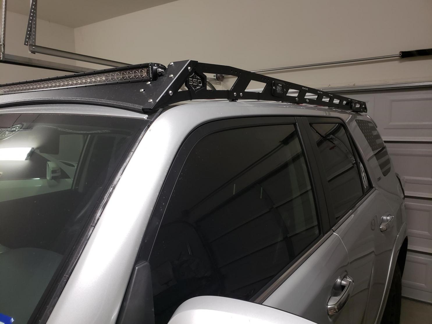

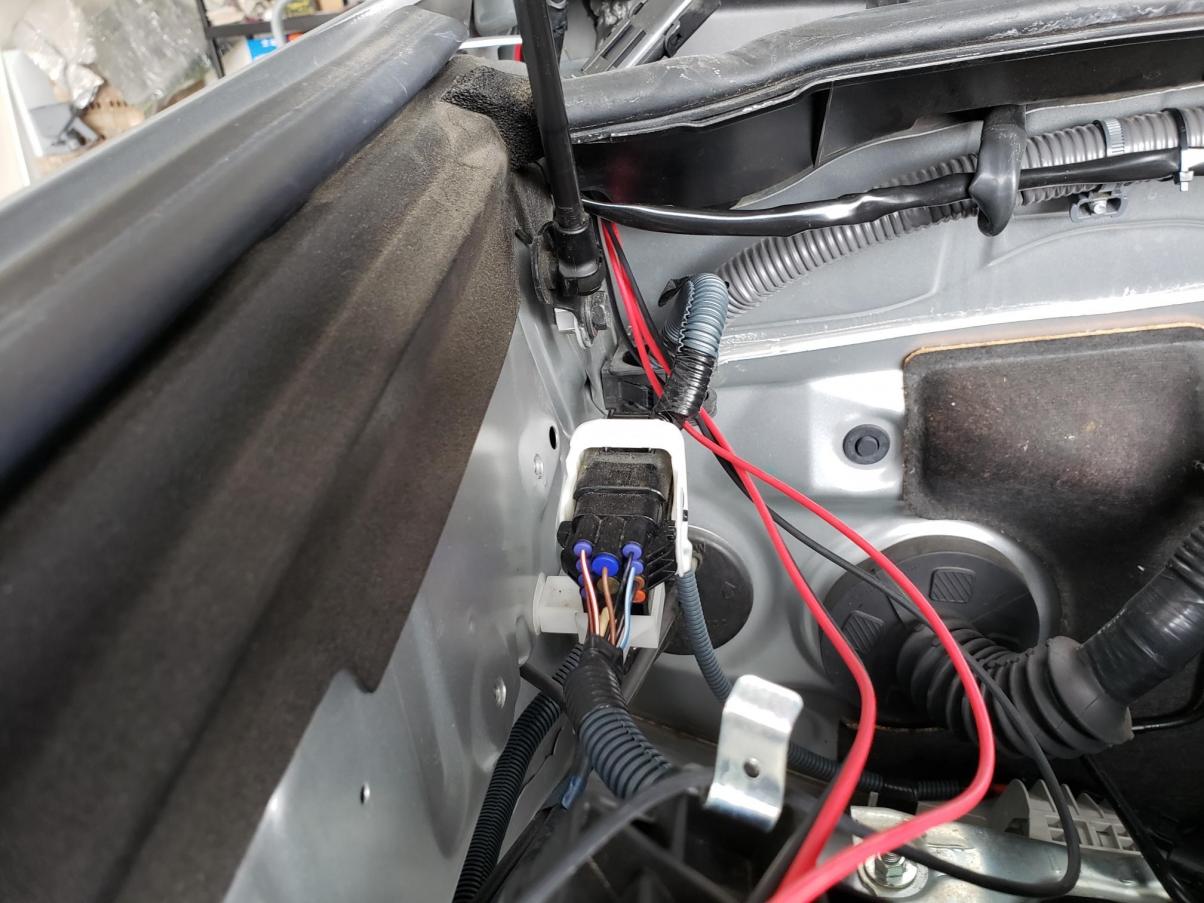

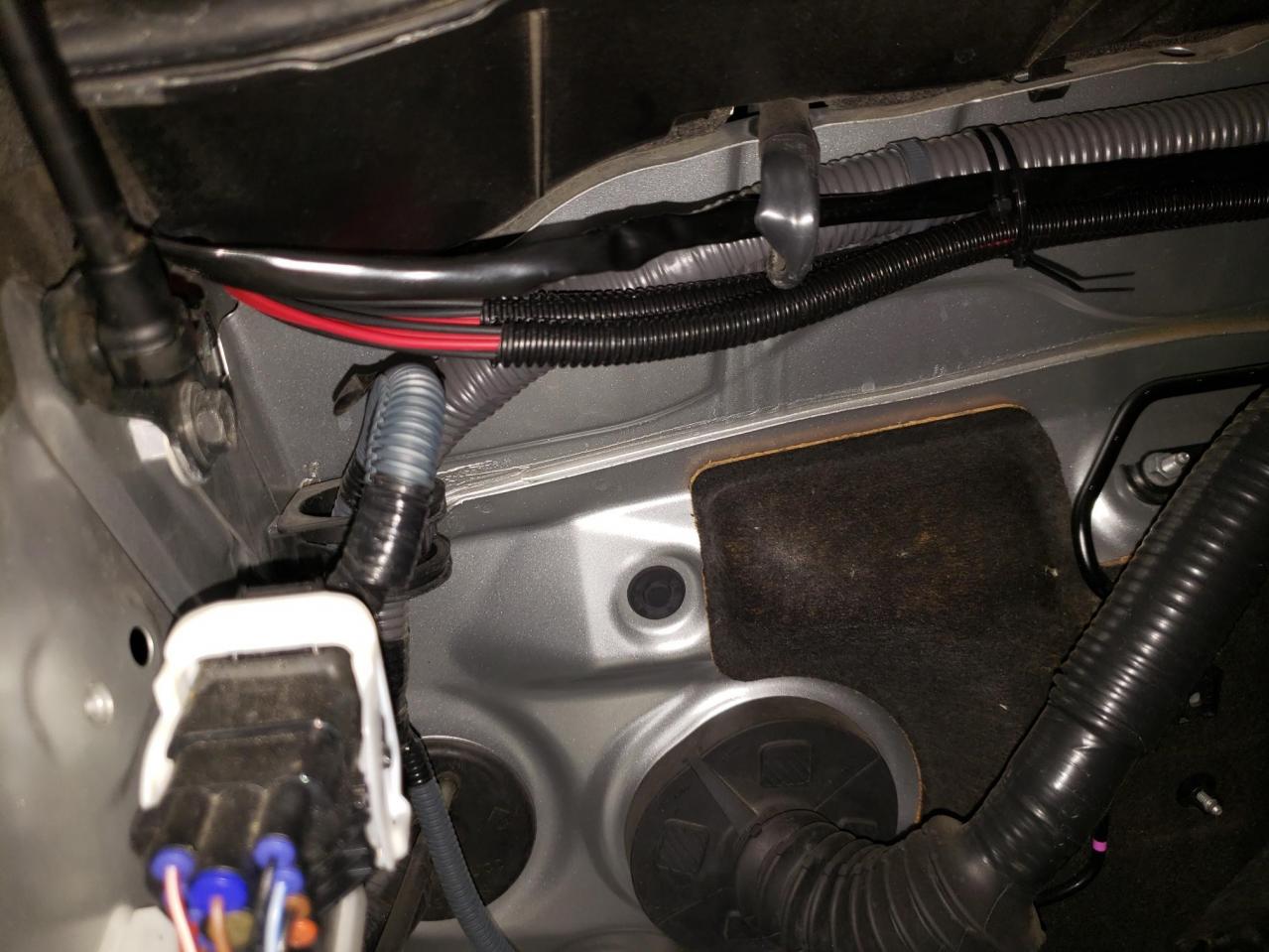

So I don't know how to attach pictures other than separately so I'll just describe what I did and upload pictures. I bought two pairs of the Rigid flush mount lights. I purchased Y-Shape Dual Outputs Deutsch DT DTP Adapters Connectors Splitters from Amazon to connect the two left lights together and the two right lights together. I ran the left side wires to the front, wrapped it in silicone tape and zip tied everything snug against the side of the rack. Then I ran the left side to the passenger side. I wrapped the passenger side wires with silicone tape and ran it to the front passenger side and married the left scene light wires and the right scene light wires together by silicone taping them together. The wires were then run down along the rubber gasket on the windshield and under the trim at the top of the hood and into the engine bay. The wires were then wrapped in a loom tubing and run along the firewall at the back and zip tied. The wires were then hooked up to my sPod.
The wiring came out pretty clean. Let me know if anyone has any input or comments on how I ran my wires. If there's a better way or if you foresee any issues by doing it this way, let me know. Thanks.

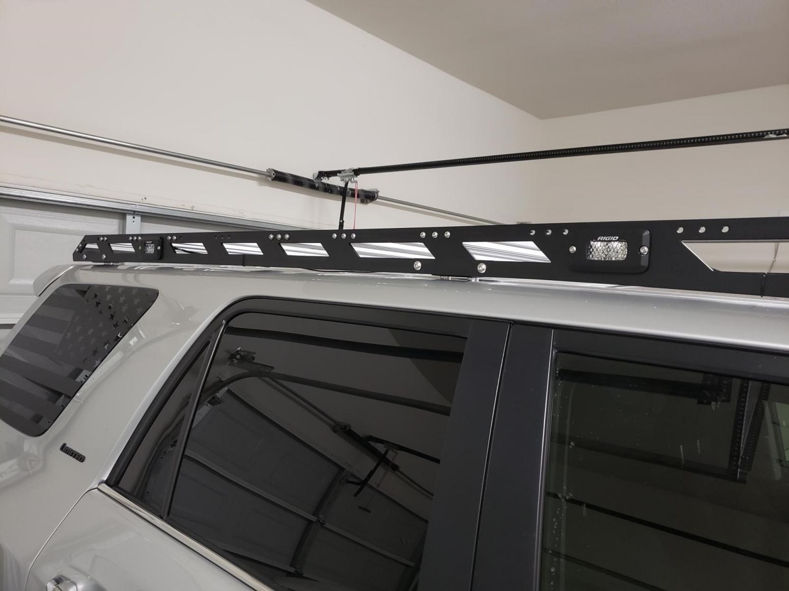

And attached are pictures of the finished product.

As for wiring, I was concerned about the number of wires and pending on the gauge used, worried it be too thick to run down the space along the windshield. So what I did was run only the hot down to the engine into the sPod, fusing it before connecting (even though the sPod says it has current-sensing MOSFETs for protection). For the wire that ran along the windshield, I used a roll of shrink tubing to hide the color of the wire and to further protect from elements.
After checking for continuity, I grounded the light bar to the front mounting bolts. I did place a short length of wiring from sPod to a bolt on the frame which is also connected to the negative side of the battery. So far so good.
On your setup, you can further protect the connection/wiring by adding shrink tubing where it connects to the sPod.
[MENTION=273299]dktxt4r[/MENTION] - Nice. I'm still waiting on the Rigid lights from SSO. Apparently they are on back order and was to be shipped direct from manufacturer. I've only installed the light bar. After seeing yours, can't wait to install mine.
On your setup, you can further protect the connection/wiring by adding heat to the connectors (U shape) where it connects to the sPod. Those are heat shrink connectors.
I was going to heat shrink the wires but it was a lot easier to wrap it with silicone tape. The only reason I didn't heat shrink the connectors at the sPod was because I forgot to add the heat shrink prior to crimping the connectors. I didn't feel like cutting it off and re-doing it...i may just wrap it with silicone tape as well.
