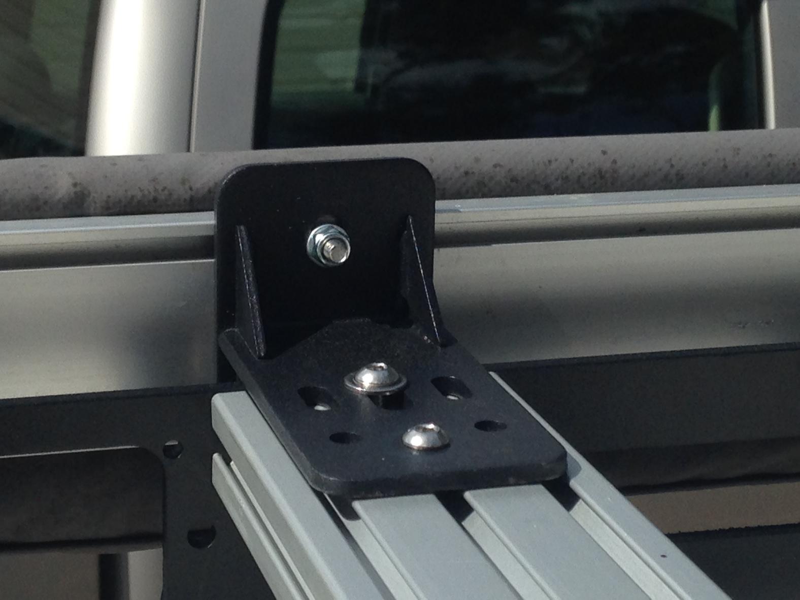

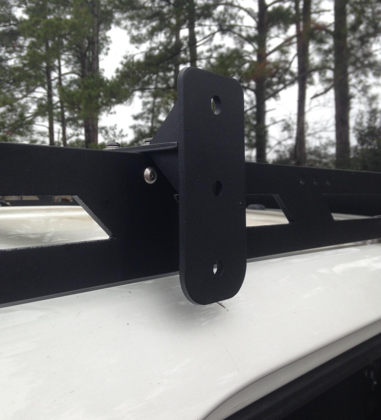

Looks good. Are those the ARB mounts? And do you feel that two are enough for the 2500 or would you recommend three?
Rhino Rack awning mounts. They are sold in pairs (~$55 a pair) so I used 4. The mounts themselves are very sturdy, so I wouldn't have had a concern with only 2. But with only 1/2" long anchor bolts (restricted by depth of slots) I wanted a minimum of 3 and since I had 4 I used all of them. Longer bolts would have required drilling and I'm not ready to drill on the crossbars just yet.
Thanks!
