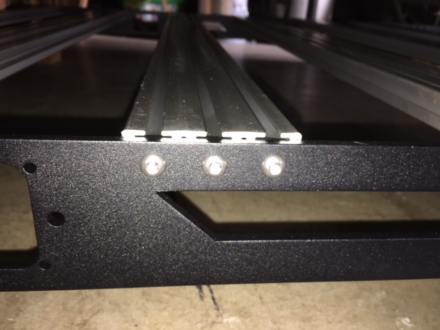

Do all of your cross bars sit flush with the top of the side rails? Drivers side on mine is 'mostly flush', but most of them on the passenger side all stand proud of the side rail until I get to the two front bars (they're flush).

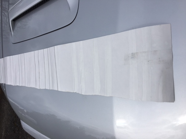

Can you post a pic of the tape? I want to buy it from somewhere as I didn’t get it.
As for cross bars fitting, the holes in side rails are ~1-2mm bigger in diameter for a reason; just lift the bar to your liking while mounting the screws and it will be flushed.

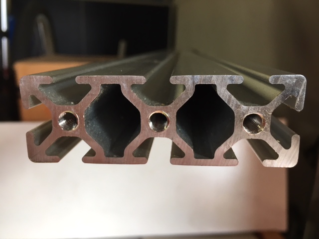

Here's a couple bad pictures. One of the tape and one of the cross bars. The cross bars sit above the side rail when pushed down as far as they will go.
That’s a defect!!!!! Call them; you need new side rails
Yeah I guess I'll see what they have to say tomorrow...

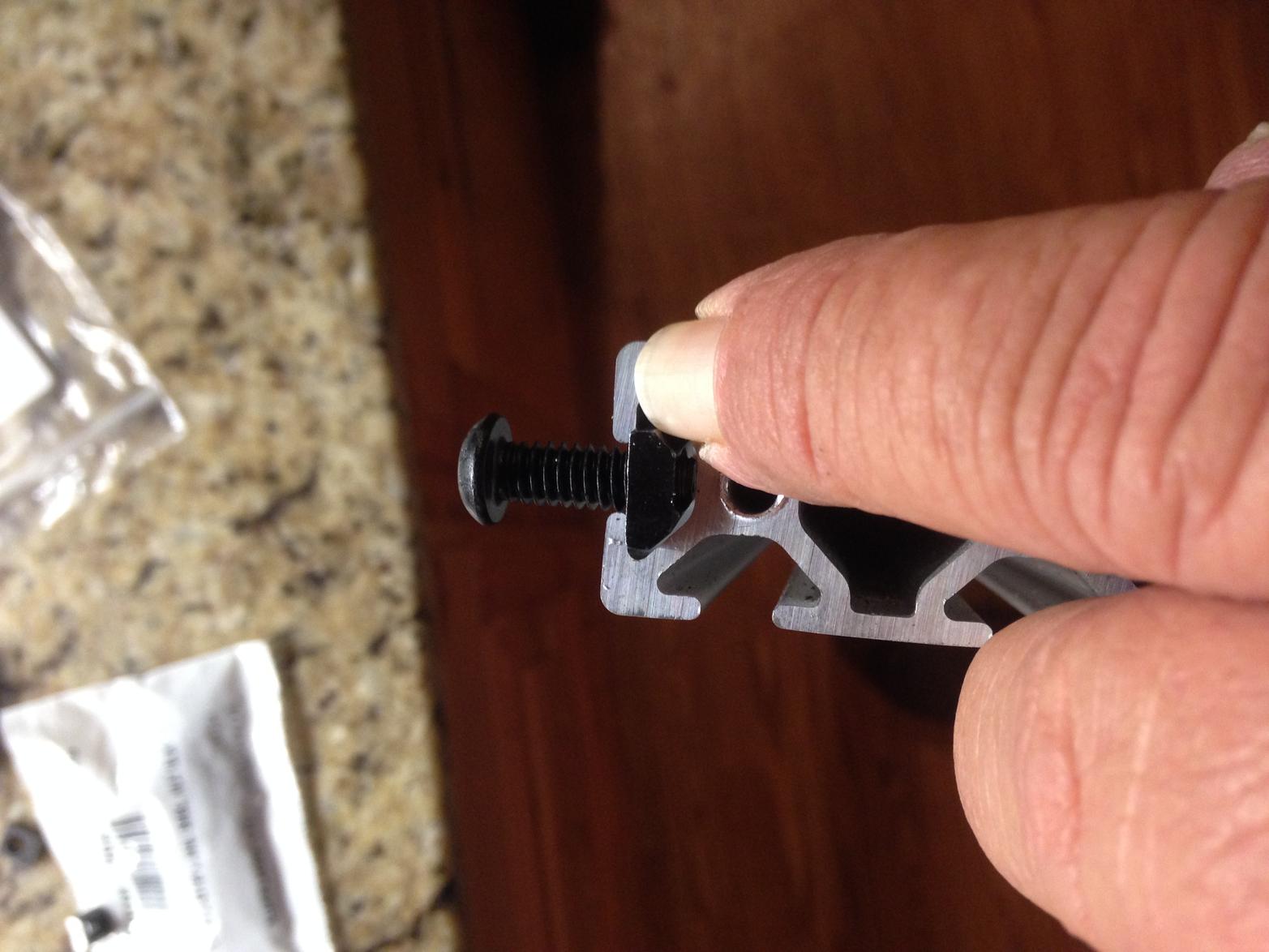

Far be it for me to second guess someone who is actually on the ground there, but those pictures look to me like you may have the screws in the lower slots and not in the threaded holes. But your crossbars have a different extrusion profile from what I got also, so I very well could be wrong. But the bolt position on the side rail looks correct in comparison to mine.
As much as I'd like for it to be that simple, they are definitely in the threaded holes. Interesting that your bars have a different profile. I don't thing that has anything to do with it though since some of them are flush. The rear 1x2 bar and the two bars at the front of the rack are flush.
Edit: Just saw your picture come through. My bars appear to have the same profile as yours.
Sorry to say this man but DAMN ! You have too many pixels on your camera ! That finger looks like a worm from DUNE ! Long live the Spice ! :) that picture hit me like a truck !
My mistake. A closer look at your picture showed me I was seeing the reflection from the top of the side rail, and it looked like a very narrow T profile. But something is still odd because your bolt holes appear to be centered on that upper "rail" similar to the way mine are.
Lol. Sorry. I'm using a laptop and I like to see details. :nerd:
It's just a bad picture. Here's a better picture of the cross bar, it appears to be identical to yours.
