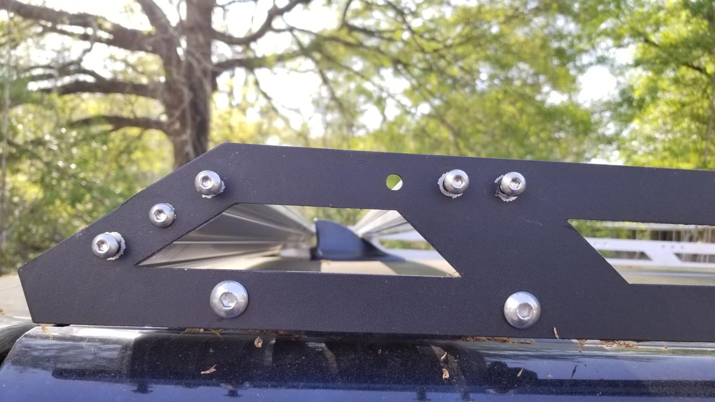

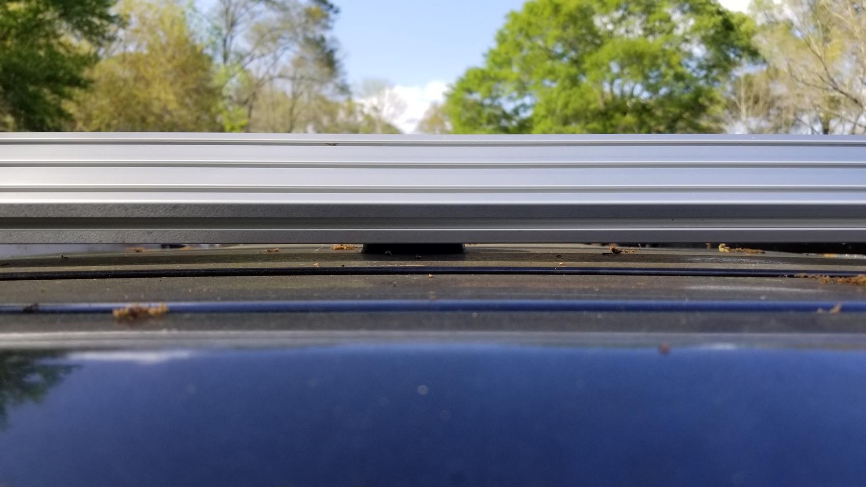

Here's a couple bad pictures. One of the tape and one of the cross bars. The cross bars sit above the side rail when pushed down as far as they will go.
Just wanted to let you know we got your email and it does look like the material shifted during the laser cut. We're going to get another side rail sent out to you as that appears to be the only fix. Check your email tonight or tomorrow with the full resolution.

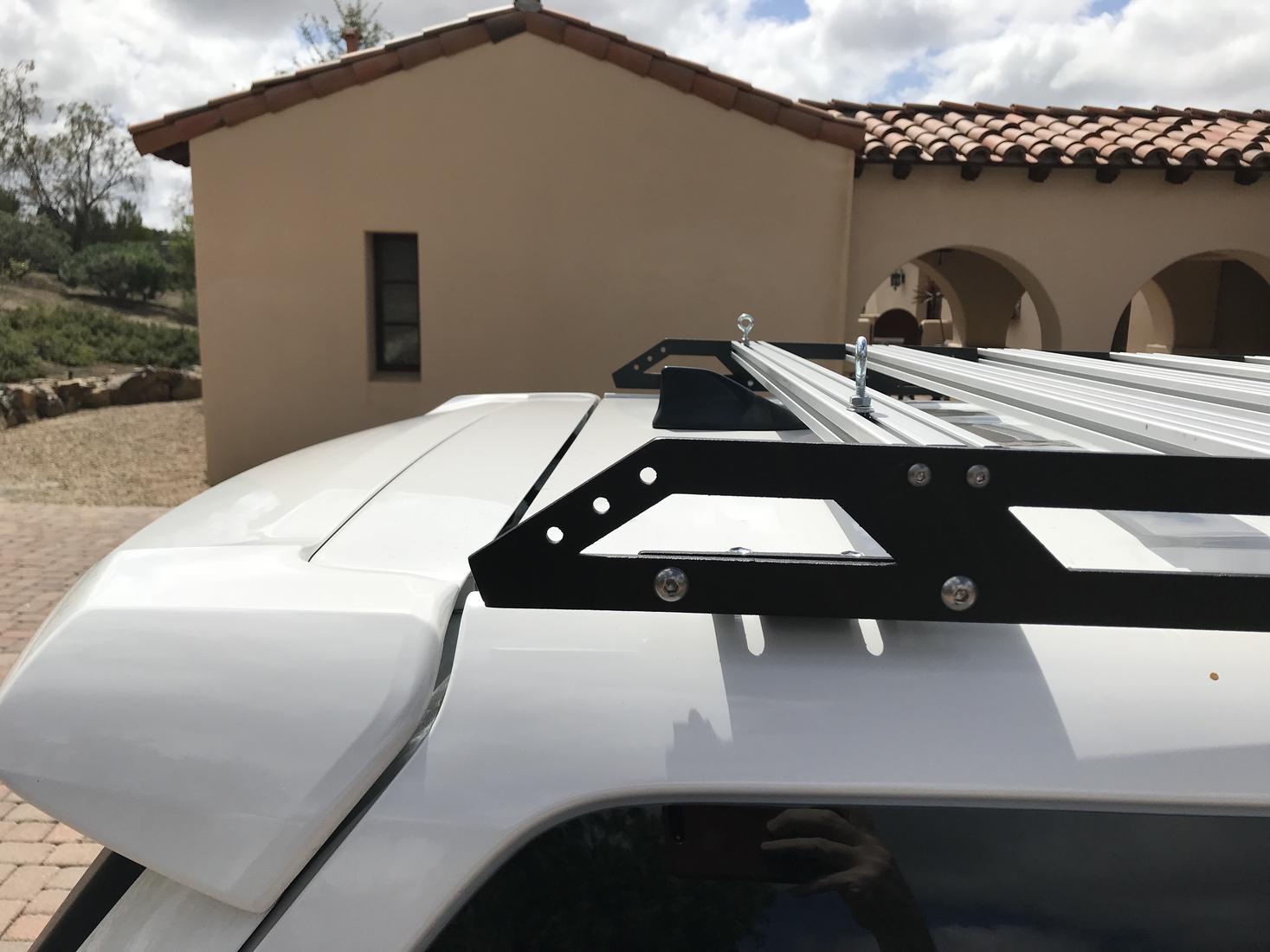

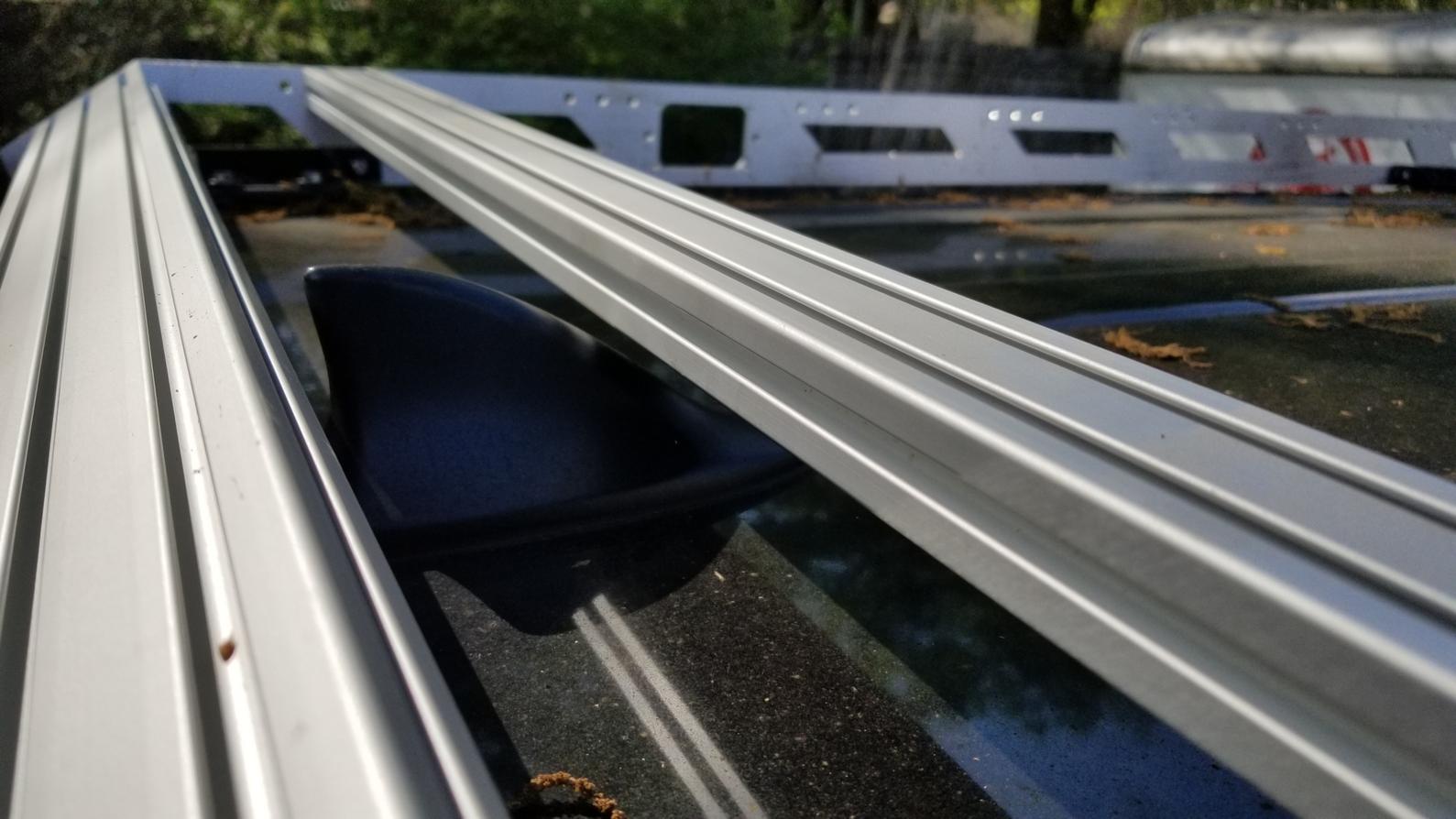

I have a different problem that I try to solve. The last rear cross bar mounting holes are offset
The shark fin antenna is in the way

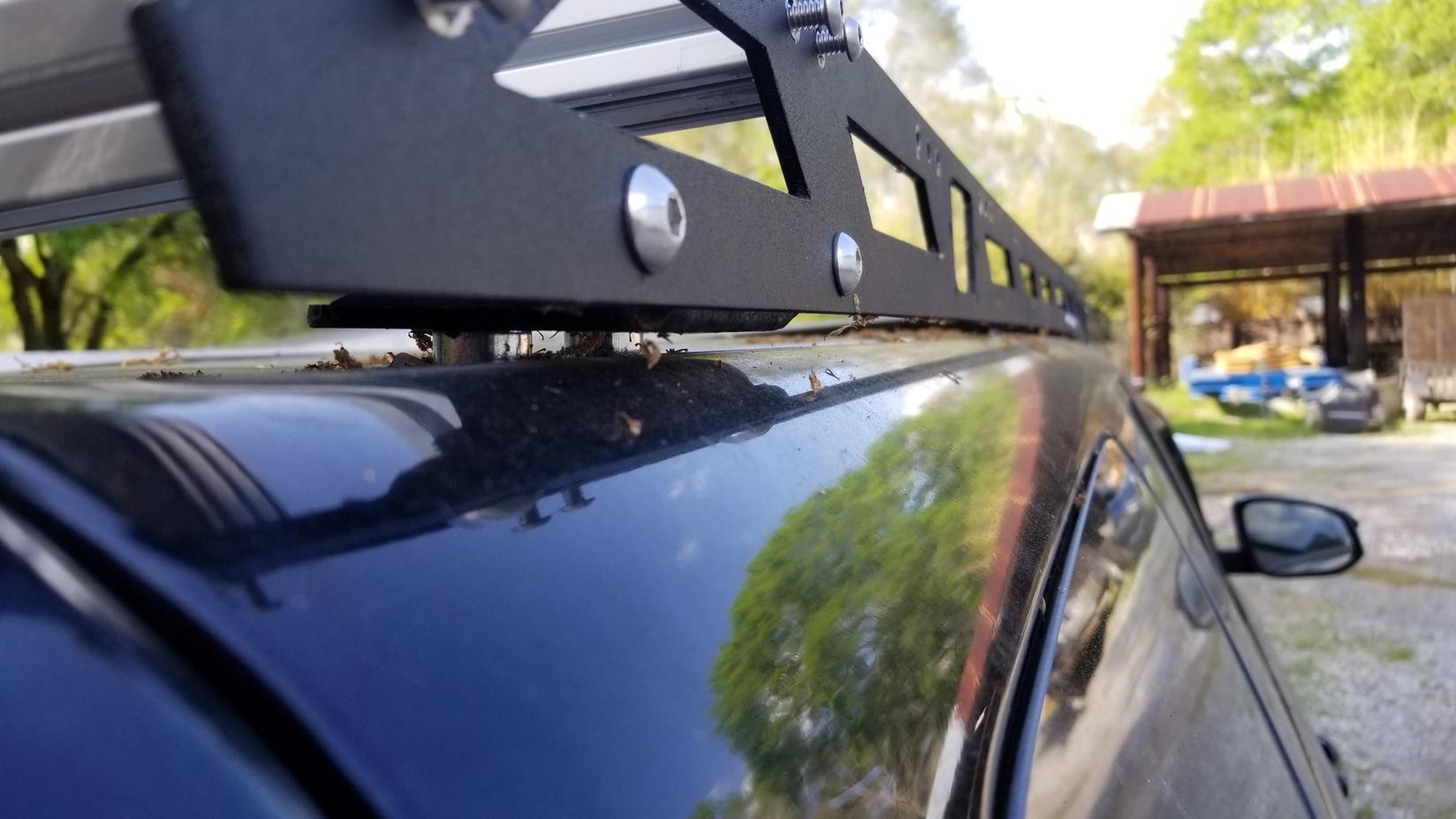

Ok, so i went out and installed some cross bars on our 4runner mule and I believe you just need to simply loosen the bolts for the entire roof rack and scoot it back a tad. There should be enough wiggle room to do this. I included some pics to show you what kind of distances you should be seeing.
I did lose all the mounting bolts trying to pull back the rack, not enough clearance. Maybe your shark fin antenna is smaller. I made it work at the end

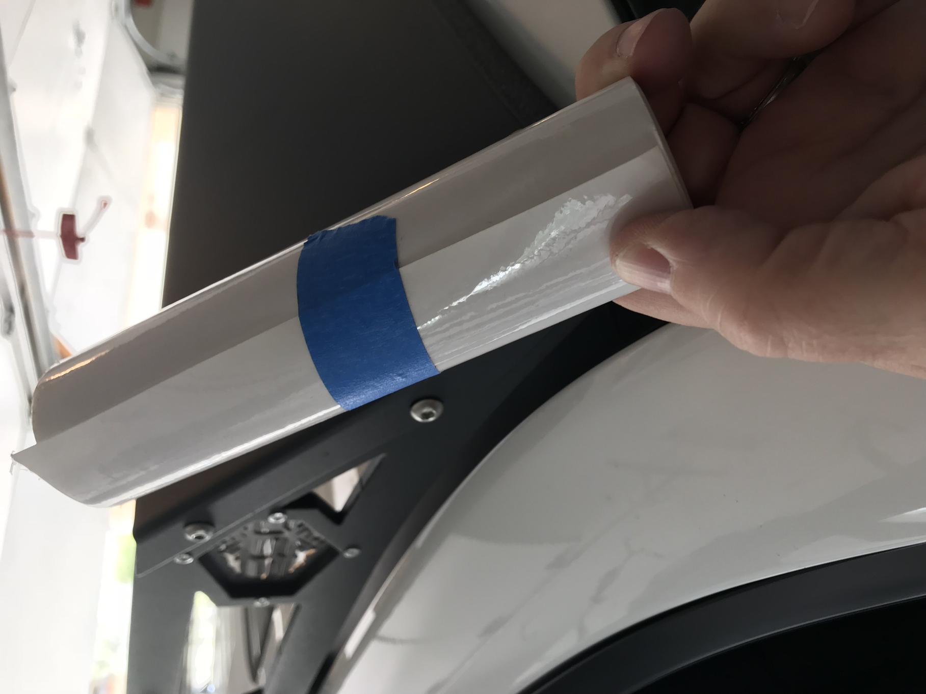

Clear vinyl? I was thinking that it should have been included as the windscreen's rubber that touches the roof rubs against the paint.
Can you post pic of the vinyl?
You should be able to take off the wind fairing by removing the 2 screws from each side rail, install the vinyl and reinstall the wind fairing.
Sorry for the delayed response TodiN. Darn job got in the way of my off-roading fun. But it looks like Tundra555 beat me to the picture. The vinyl just comes in a roll with a white backing paper. I’m hoping to get it installed this weekend. If so, I’ll take some pics along the way to post.

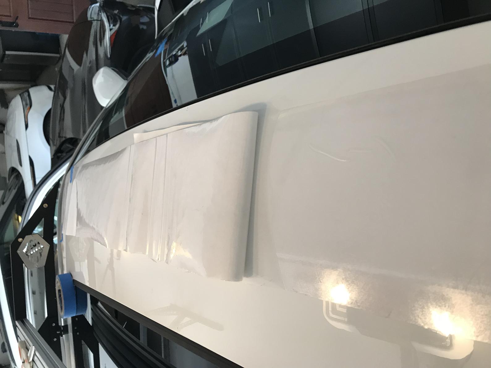

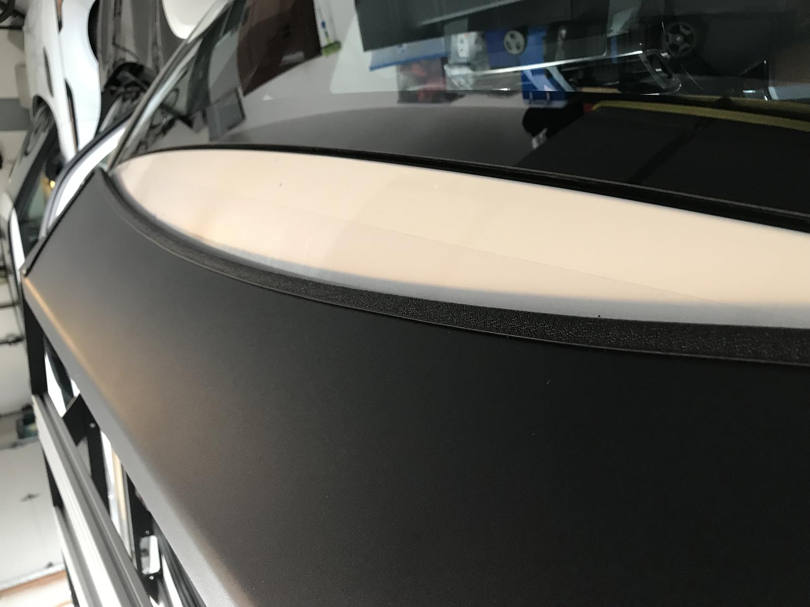

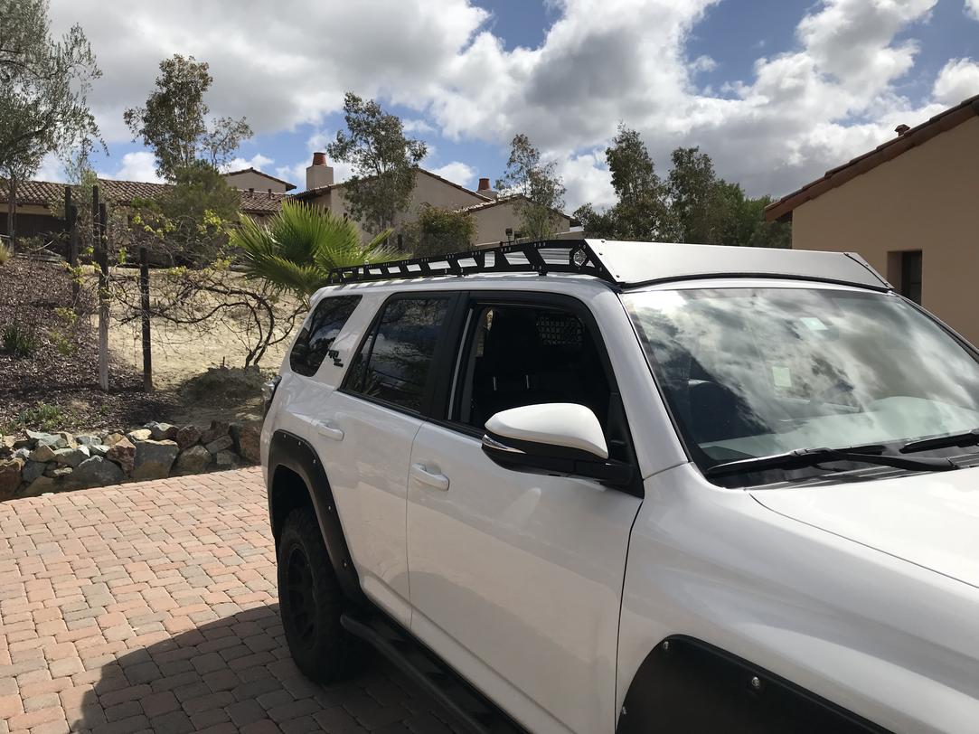

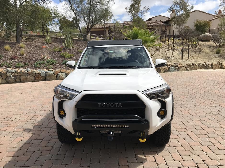

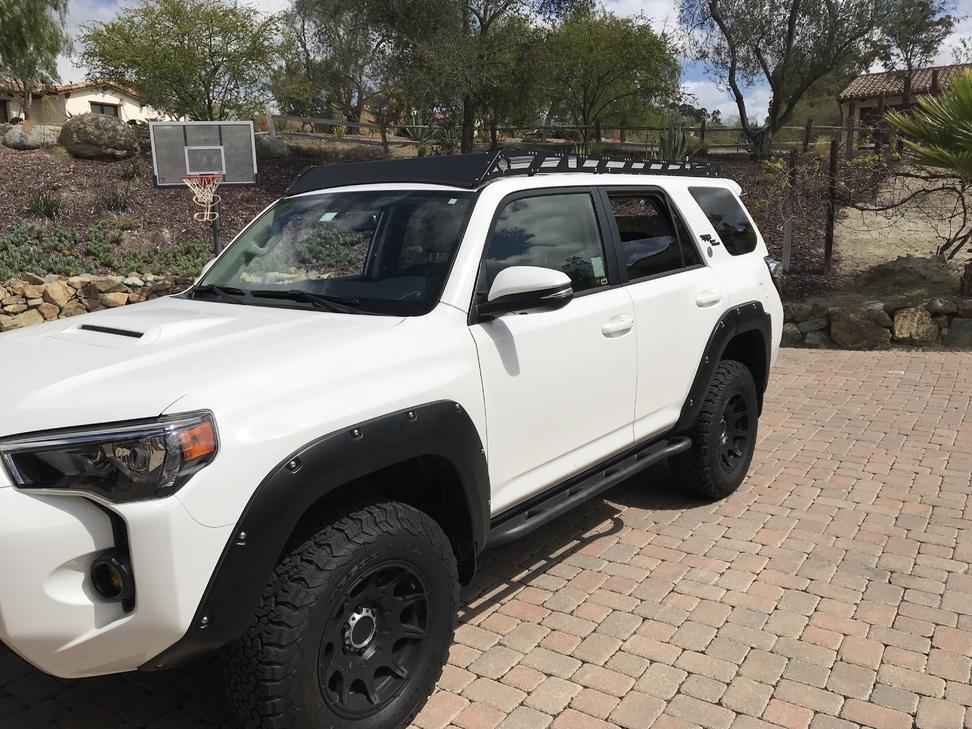

Here are a few pics from the install of the vinyl. As you can see it comes in a rather unremarkable roll. It needs a bit of trimming but no big deal; took 10 seconds and a pair of scissors. I taped it on to get placement and trimming right then just peeled and rolled.
I’ve also included a few pics of the full roof rack . . . because who doesn’t like posting pictures of their rig.
Thanks, I thought is Mylar but it does not look like.
Nice install
