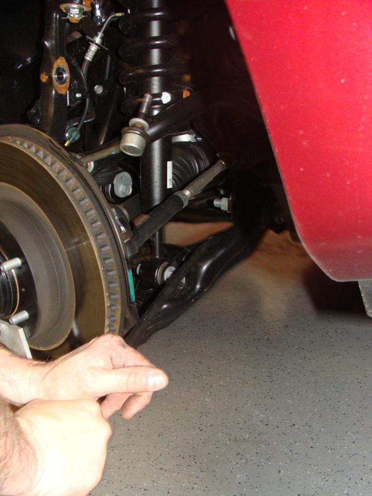

You mention that a "fall" could "ruin" the CV. Any chance you could explain a bit more? Do mean the CV''s natural lowering once disconnected from the LCA, or the shock it might receive after a "free fall?" Just curious to know how careful I have to be with the CV while attempting this install. Really don't want to walk away with broken parts! Thanks in advance!

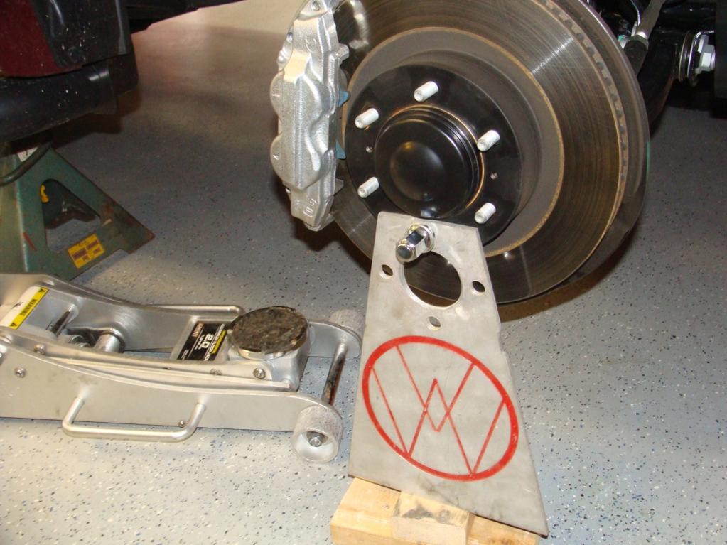

Step ten: Prop up the rotor so it doesn’t fall and ruin your CV joint.

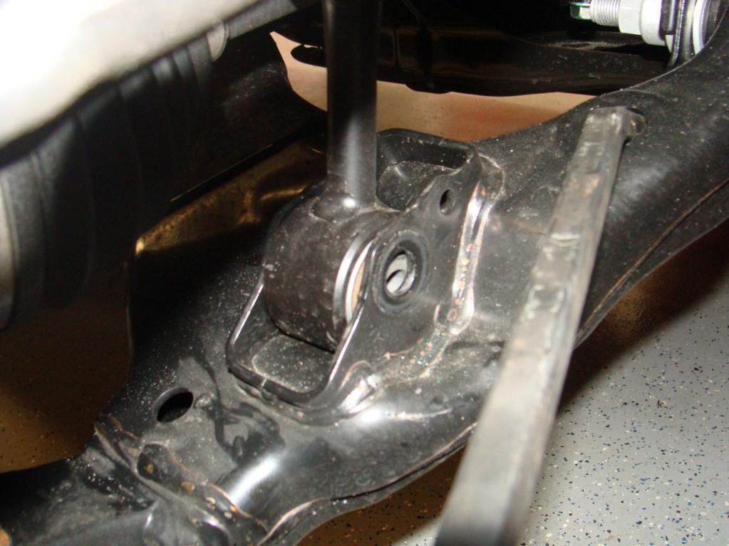

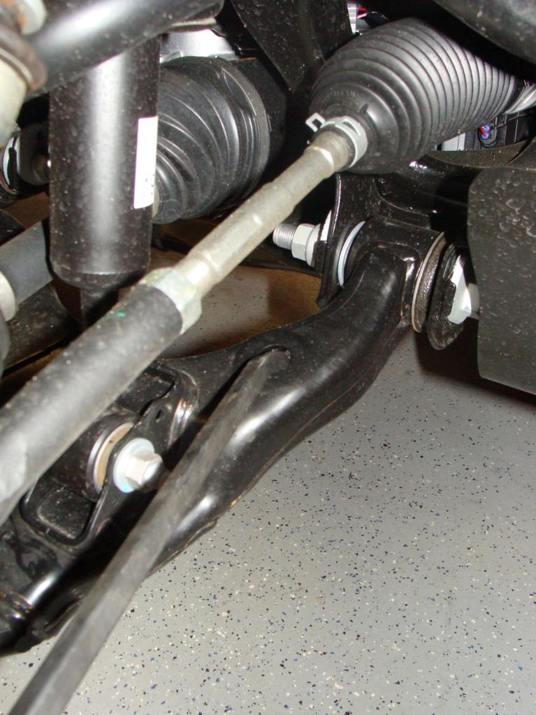

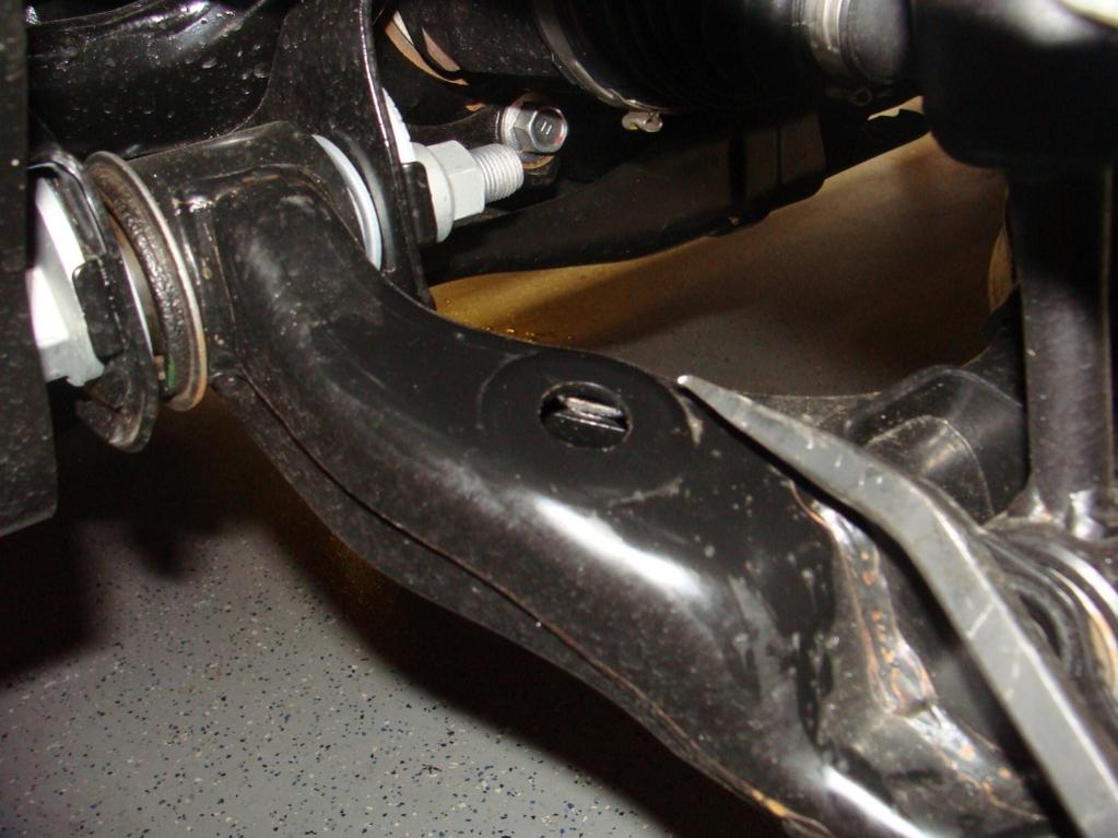

Step eleven: Insert a pry bar into one of the holes in the arm where the bottom of the shock absorber is mounted and push down on it to relieve the pressure on the bolt at the bottom of the shock.
(note, these pry bar openings are on both legs of the suspension system...you can use either side)
Step twelve: Remove bolt, nut, and washer from bottom of shock absorber.
Step thirteen: Apply downward pressure to pry bar again, and work the shock and springs out of the top support.

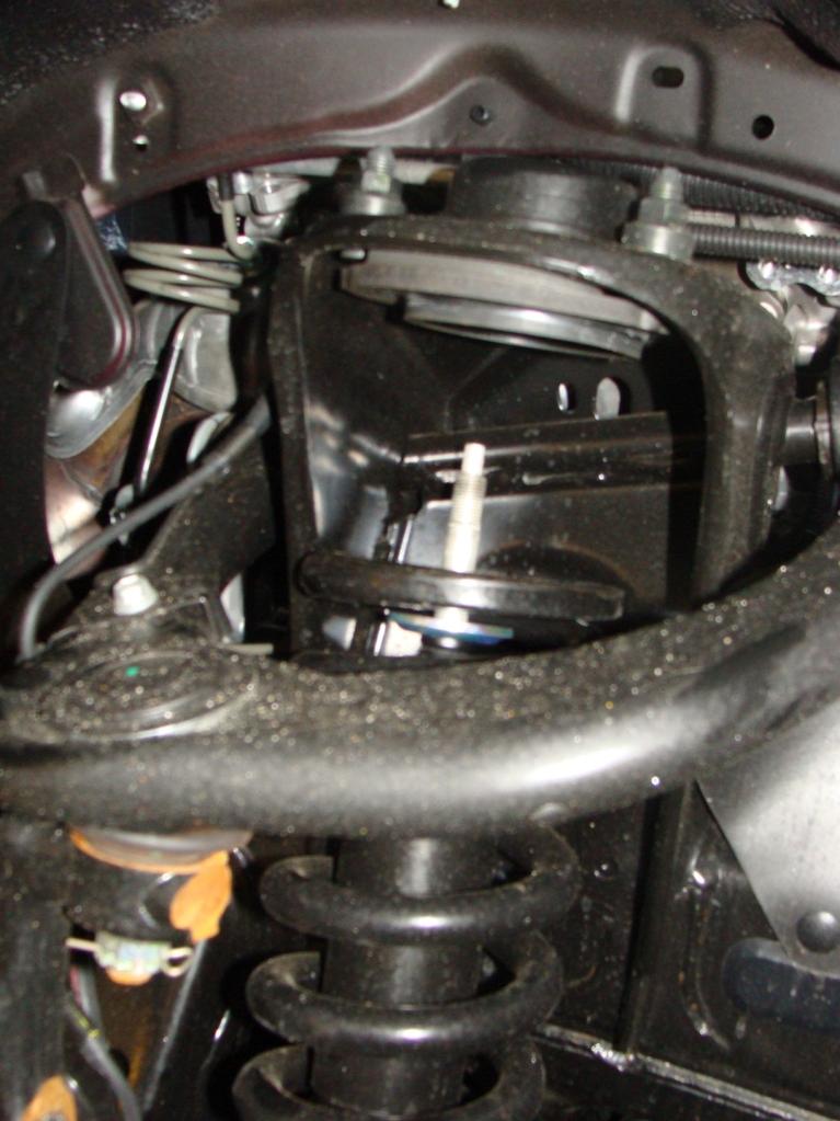

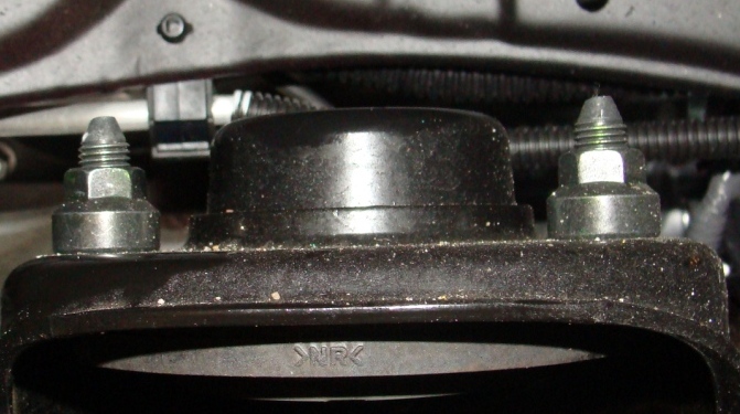

Step fourteen: This leaves three nuts that you have to remove from the three studs holding the top cushion in place. Here are two of the three studs in question (third is in the back):
Step fifteen: Loosen nuts from studs…but DON’T take it apart yet.

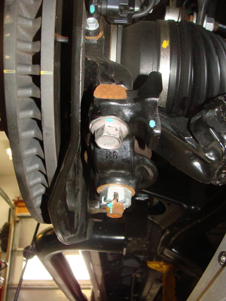

Torque specs correction?
Step twenty-eight: Put red loctite on the two bolts that go into the lower control arm. Re-install two bolts from just behind rotor. (165 ft-lbs of torque)
My torque wrench has an upper range of 150 ft-lbs, so I was concerned about the 165 ft-lbs number. Based on information I've found elsewhere this bolt requires 160 N m, which translates to 118 ft-lbs.
Did the units get mixed up or is 165 ft-lbs the correct torque spec?

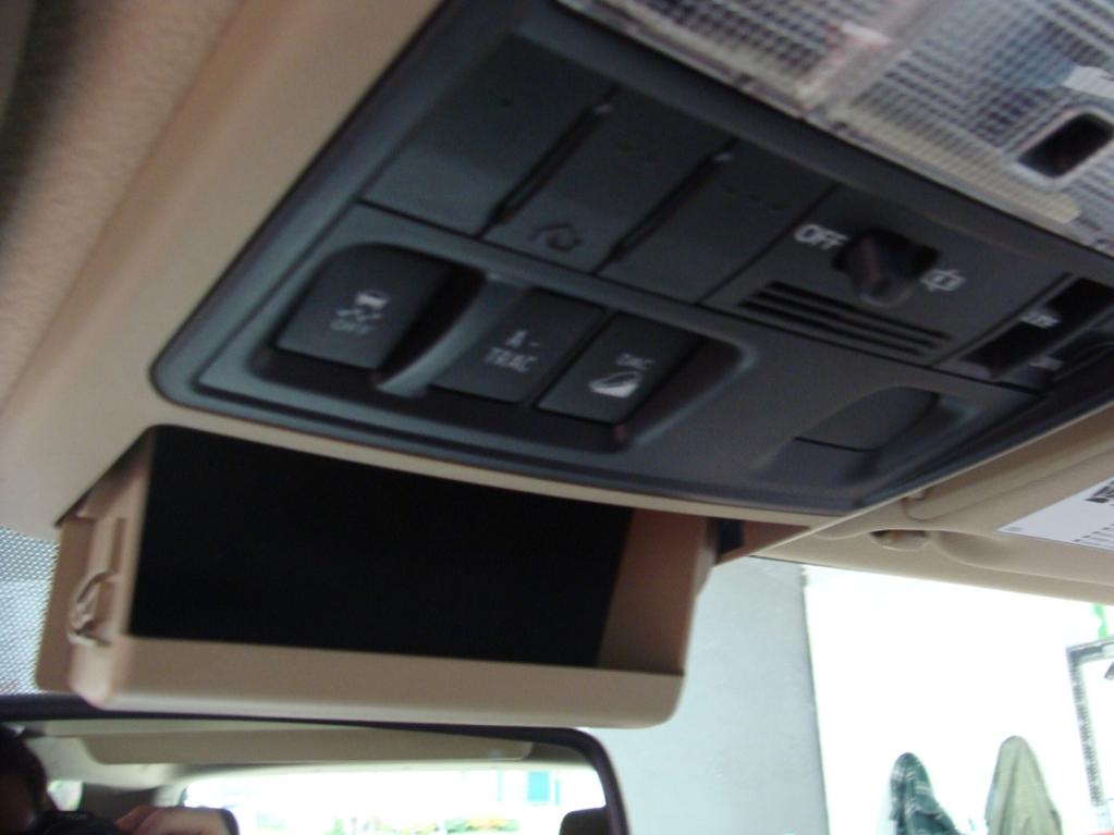

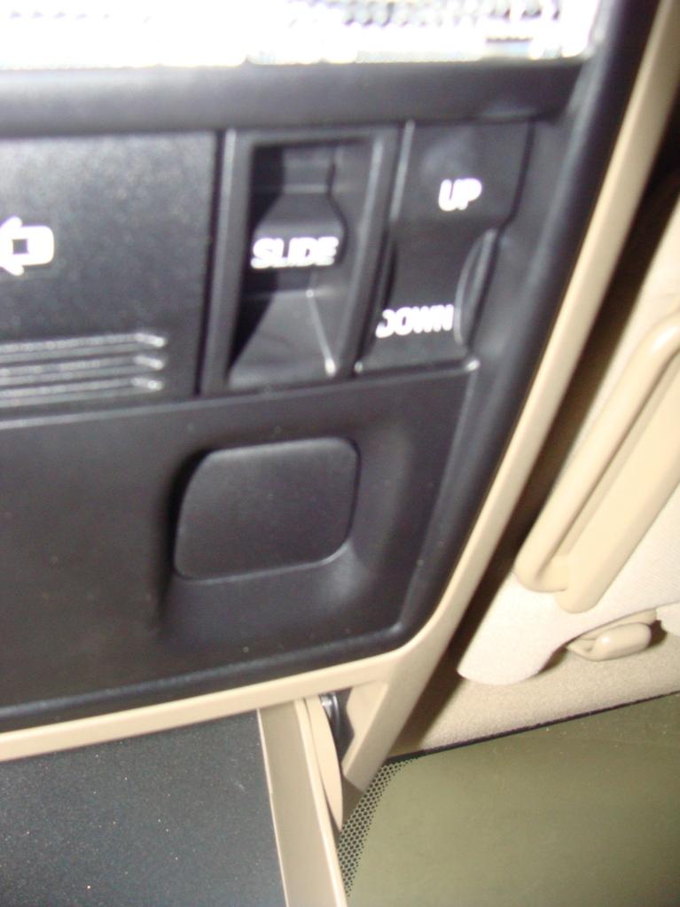

Identify your overhead console. It looks like this if you have an SR5 (Trails and Limiteds may have different buttons and whatnot):
If you have an SR5 like mine (and Antman’s), you have a “blank” on the passenger side of the overhead console. That’s where we mounted our switch.

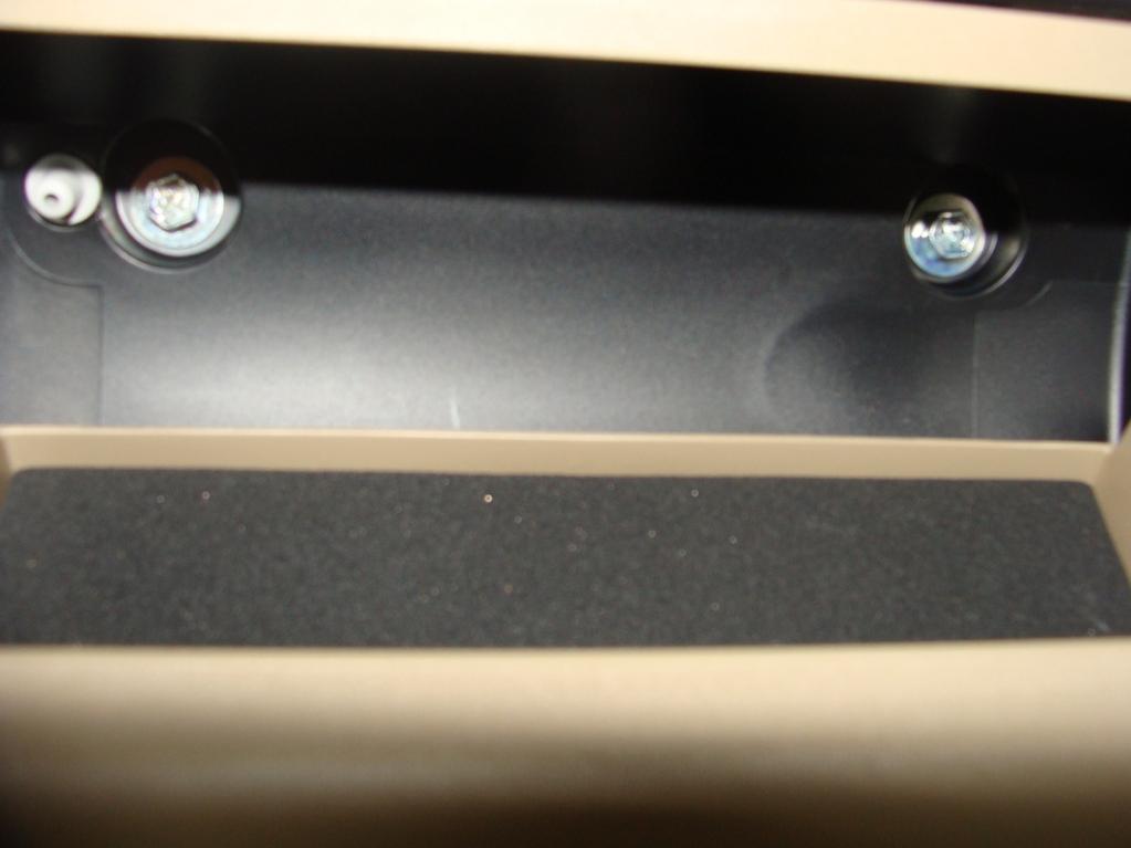

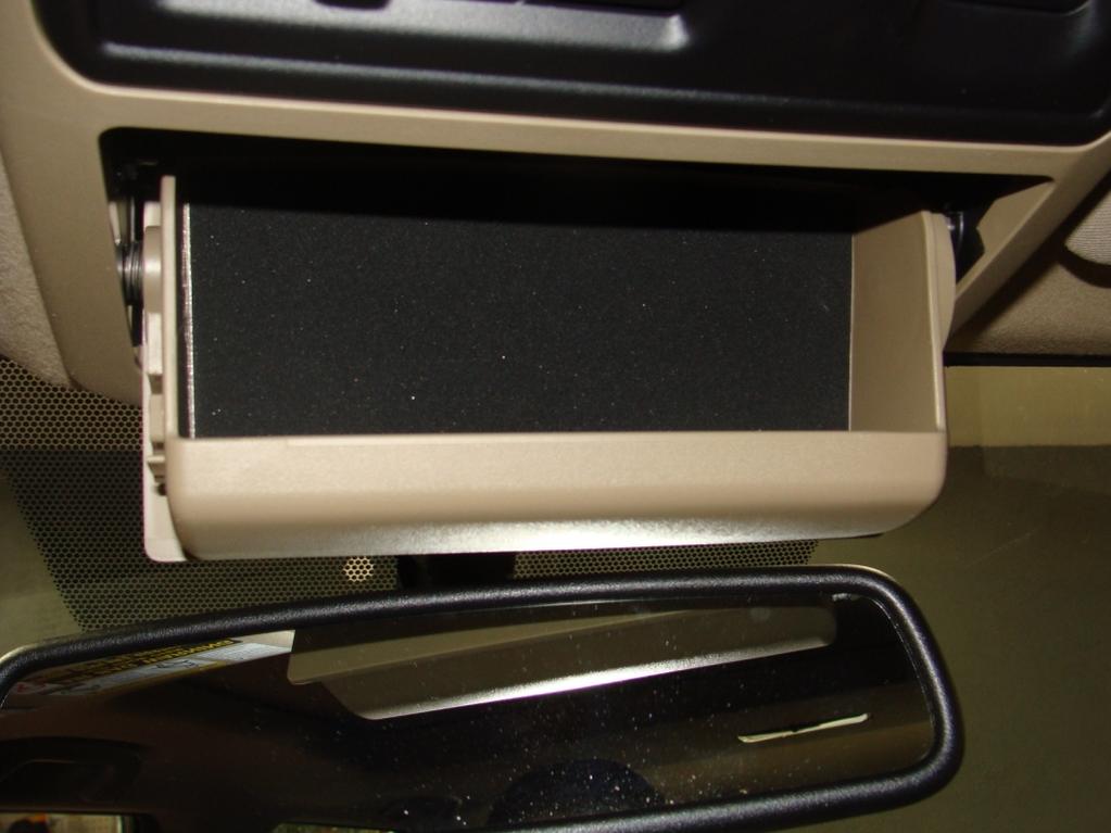

Lower the sunglass holder compartment thingy. There will be two screws in there that hold the console to the roof.

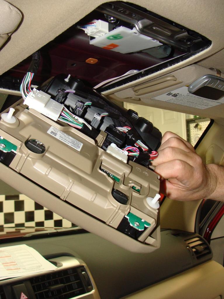

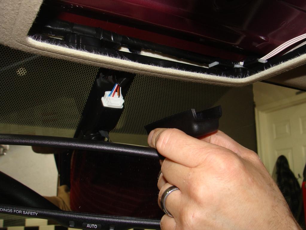

Once those screws are removed, you can just pull down on the console and it will pop out. See that white wiring harness on the driver’s side? You have to disconnect that to completely remove the console.

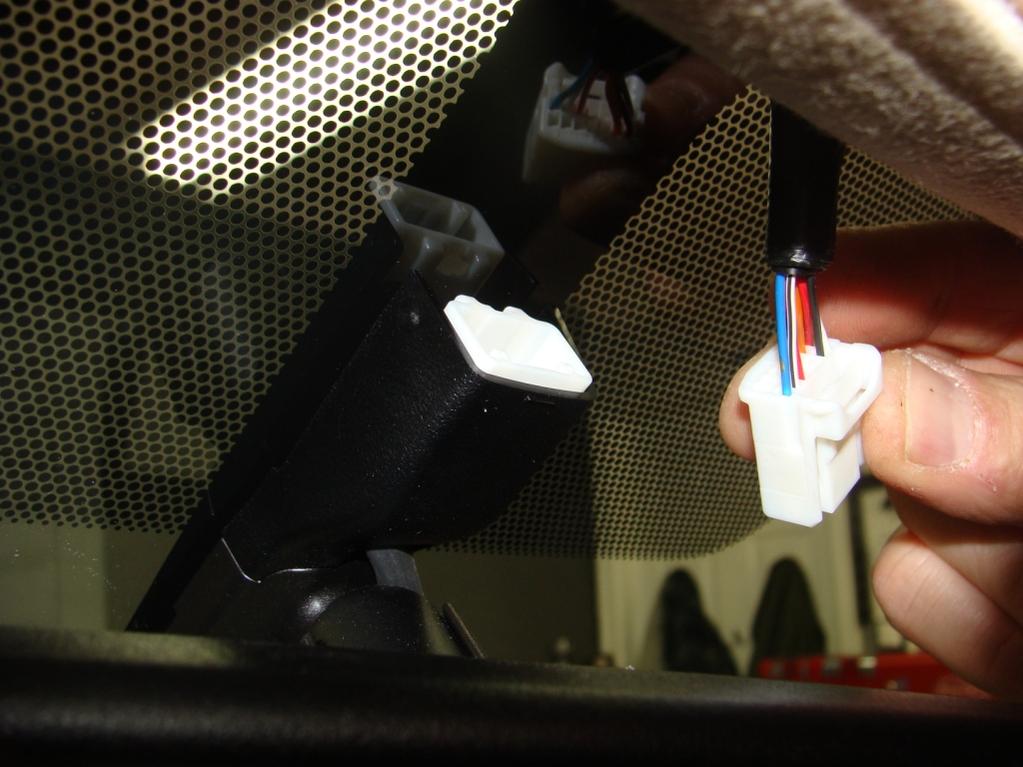

Pop off this plastic cover between your rearview mirror and headliner/console.
Disconnect the white connector that runs between the mirror and the overhead console.
