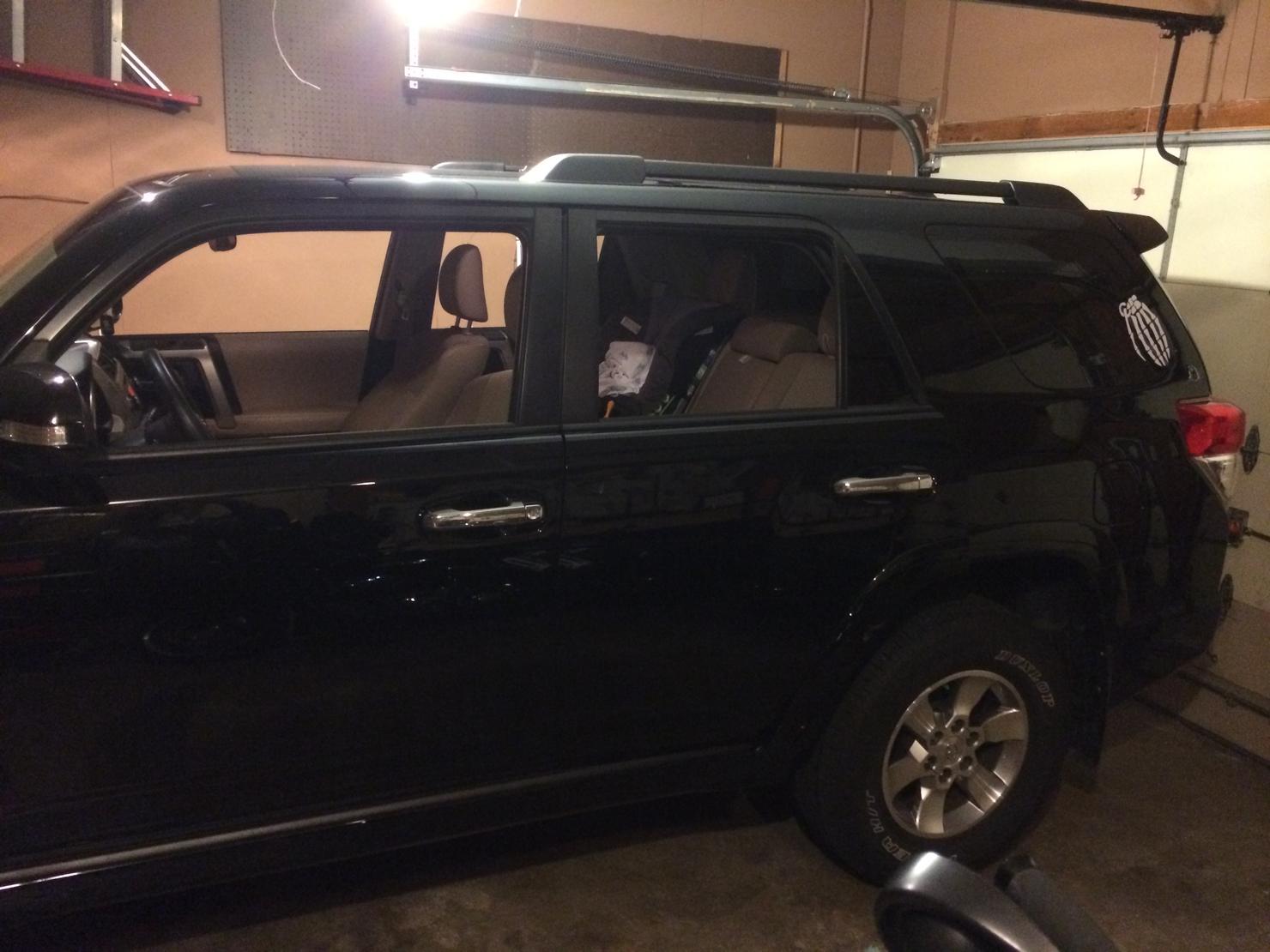

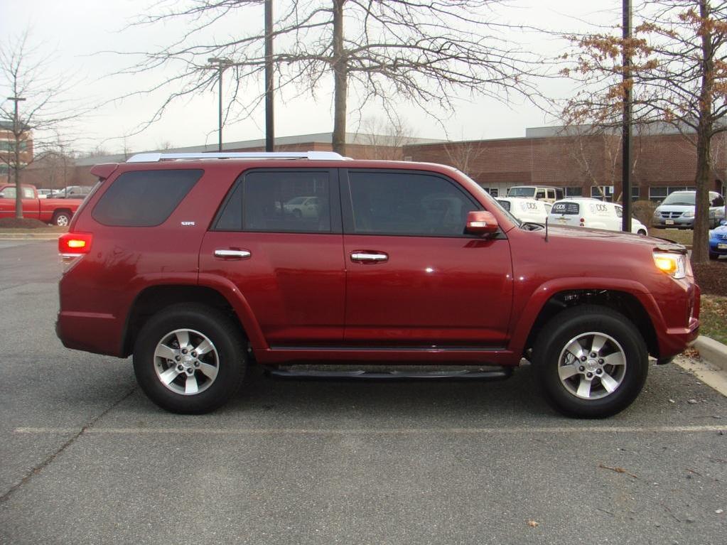

[MENTION=48991]sp8ball[/MENTION] [MENTION=65614]Antman[/MENTION], killer write up on the door handle swap you guys made it easy for me!
Little before and after action

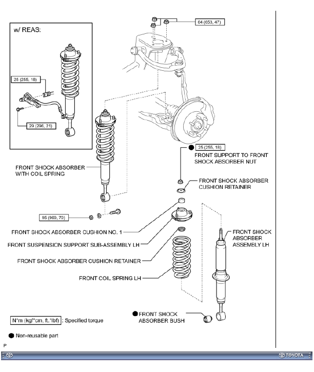

Step twenty-five: Secure rubber shock absorber cushion, retainer, and nut to top of shock absorber at 18 ft-lbs
Just want to confirm 18 ft lbs is correct for coilover top nut torque? I'm using this write up to do 5100 install without spring compressor. Since I'm doing 5100s I won't have to remove the 3 top nuts Right?
18 is correct, and also yes you will not have to remove the "front suspension support sub-assembly" as they call it below to install 5100s

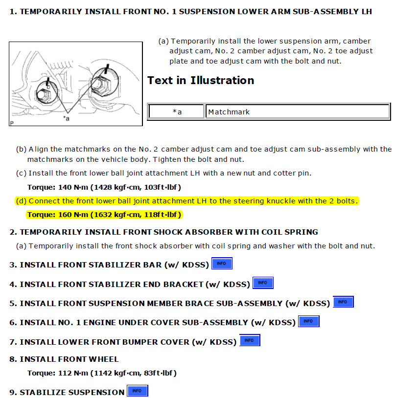

i guess i'll note 2 minor things i noticed in the writeup:
1) on step #26 on post #85: the manual say to "temporarily" install the lower shock bolt, then after finishing the remaining install to "stabilize the suspension" (lower vehicle, bounce vehicle up and down several times to stabilize), then torque the lower shock bolt to spec at 70ft-lbf. (not sure how much that matters - I went ahead checked the torques on everything after it was back on the ground anyway tho)
2) on step #28 on post #85: Sp8ball references the torque for the LCA bolts at 165 ft-lbf. the manual indicates this torque spec is actually 160N*m or 118 ft-lbf

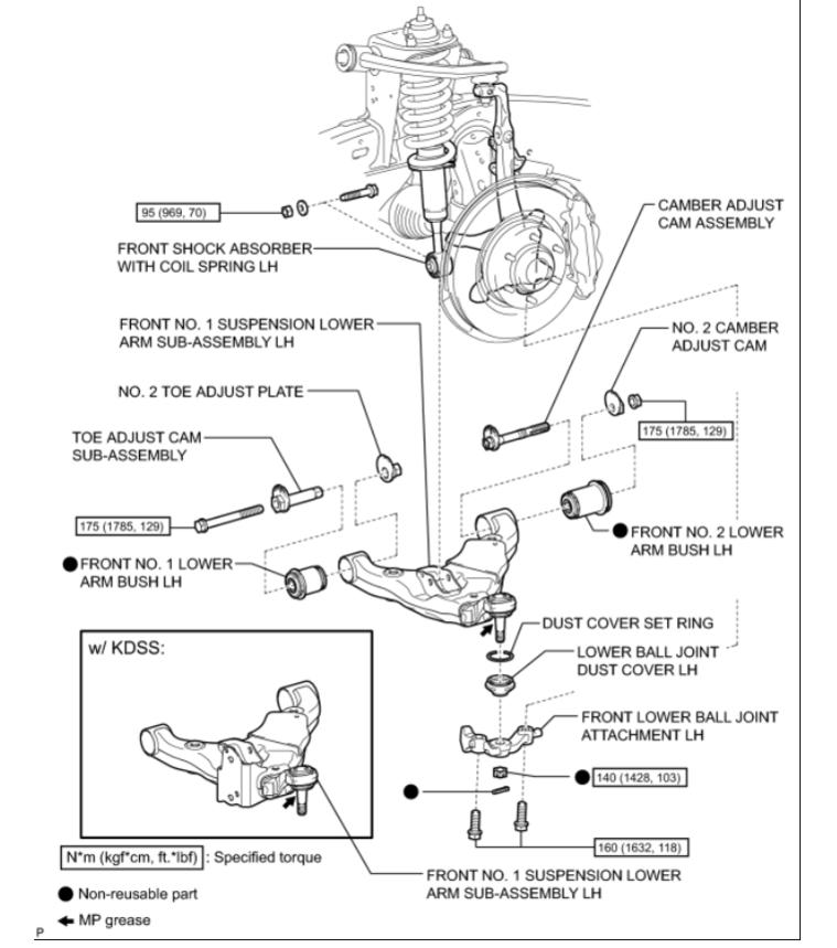

Thank you for the reply. That is a big difference on the LCA bolt torque. I'm guessing most have torqued to 165? Wonder if anyone has seen issues from overtorqing? Does the FSM mention anything about using red loctite?
it actually does not mention to reapply red loctite when installing the lower ball joint attachment to the steering knuckle, however, when disassembling you will notice red loctite was previously applied on these 2 bolts when it was built. interesting that the manual doesn't state to do so, but i would definitely apply it.

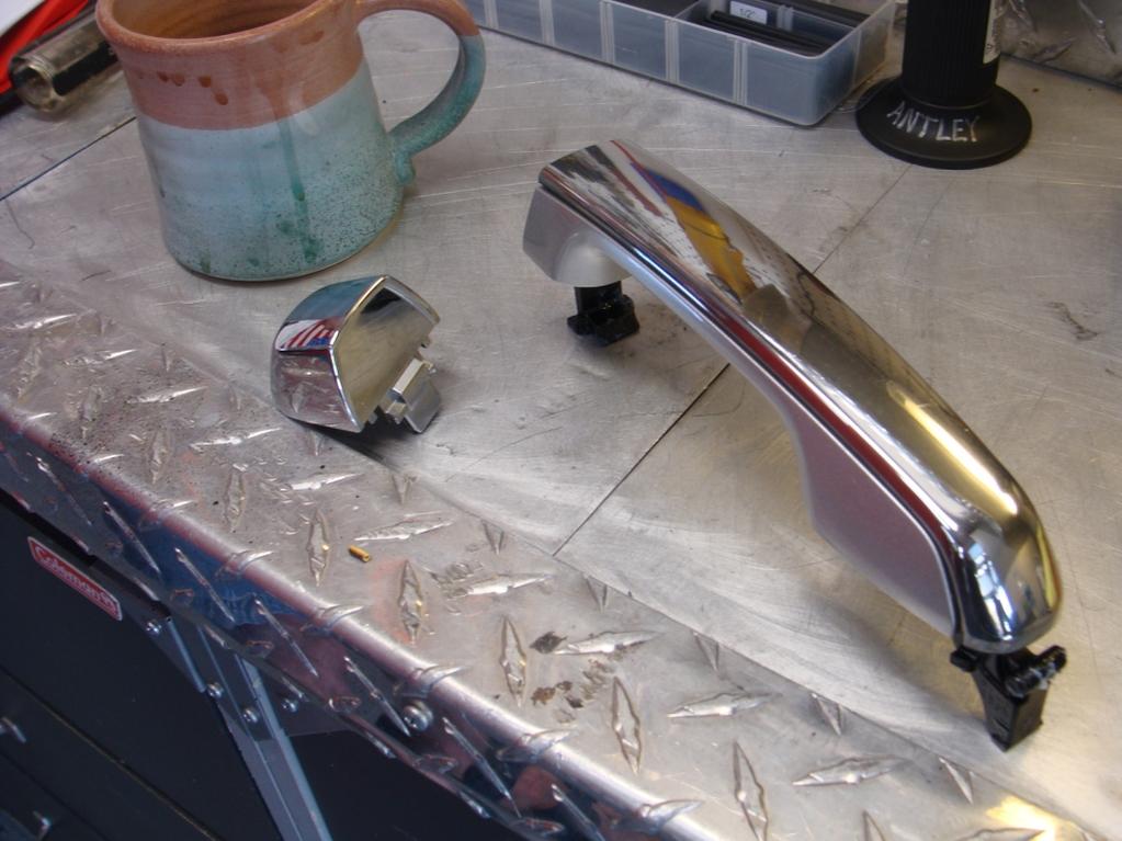

Modification: Door Handle Changeout
Body-color Front Door Handles
Main Handle (both sides): P/N 69211-60070-D1 $55.96 for both
Handle Cover, Right Side: P/N 69250-60030-D1 $17.22 for one
Handle Cover, Left Side: P/N 69217-60150-D1 $9.28 for one
Body-color Rear Door Handles
Main Handle (both sides): P/N 69211-60090-D1 $55.96 for both
Handle Cover (both sides): P/N 69250-60010-D1 $29.68 for both
Great write up thanks. Where did you order your door handles from? I bought some from CarID that said they fit but the side of the actual handle that sits against the vehicle isnt hollowed out so the clips can reach as far as they need to. I'm going to try drilling for the room I need but in the event that it doesnt work, Id like to know where I can get the correct part.
