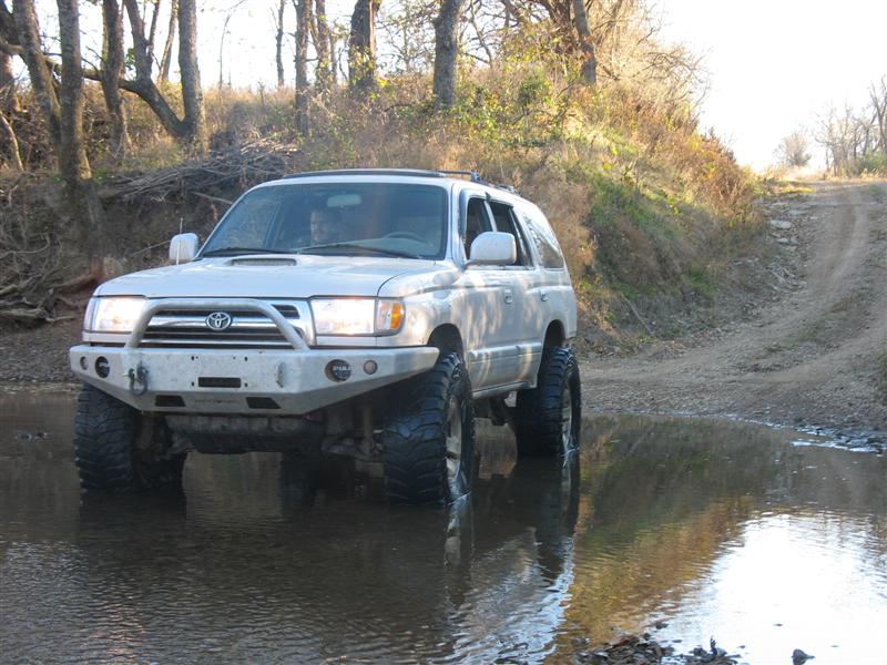

My 4Runner is an '02 SR5 4WD. I'm installing a 3" lift with front/rear OME coils plus a 2" body lift, and the supporting parts (diff drop, steering extension, etc). Was planning on running 33x10.5's, but would love to run 35x12.5's. What size spacers would I need to run these on the stock 15's? A little rubbing is ok, but it needs to be driveable. Love the look of the one in the pic below (user allison). Sig says he's running 35's with a 1.5 spacer, but that's all the details I can find on it. Is it safe to run a tire that wide on the stock 15? Any issues with doing this? Thanks for all your help!

Ok, gearing was my other concern. They aren't in the immediate budget, but I could swap them out in a few months. If I were to run the 35's for now, would it actually hurt anything? I don't care if it's a bit sluggish, I'm not a speed demon. But I don't want to cause any damage. Can I safely get away with 35's on stock gearing for a little while until I can switch them out, or am I going to cause harm?
Secondly, is a 12.5 wide tire safe to put on the stock SR5 15's, which I believe are 7 wide? Looks like stockers in the pic I posted, but that's a limited, not sure if they are wider to begin with?

As for fitting that tire size on a 7" rim, that's where the wheel spacer would come in. The tire will be bulging on the side, which will cause it to come awfully close to the UCA, if not touching. And I read that some places won't mount a tire that big on a 7" wide wheel.

i would not mount 35x12.50's on stock wheels yes it will work its not dangerous, but like i said you will rub the upper control arm unless you get wheel spacers, another issue would be you wouldn't want to air them down off road they will fall right off the bead not being proper width wheel for a 12.50, iv done it before but the cost of wheel spacers and all that you can almost find a set of wheels for that tire. im running 33s on stock gears right now because I am going sas and waiting until i get the straight axle in to regear, with a/c on its not horrible but it has a ton less power than stock, i also went from 23mpg to about 14mpg average. good luck let me know if you need any more info
