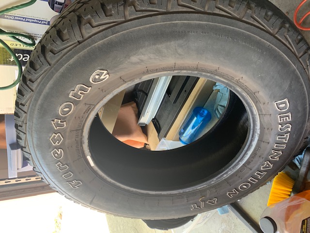

So I’ve got this spare with no wheel/rim and I was wondering if I need a specific rim for it to go back into the holder or if anyone had any recommendations for one that’d be great.

My spare is an OEM sport style wheel. So yours should be a match with the other 4 you have. You can just get a steel wheel for your vehicle... Or better yet get a used alloy from a forum member, salvage yard, or ebay.
Check what the tire size is, should be on the sidewall. probably in the format 265/65/r17 or something of that nature. The first number is the width in mm, second is the aspect ratio of the sidewall, and last is the wheel size in inches. If its anything from 255-275, should be okay with any 17in 6 lug toyota rim. Like previously mentioned, check craigslist, FB marketplace, junkyard, or local forum member for something that matches or is cheap.
