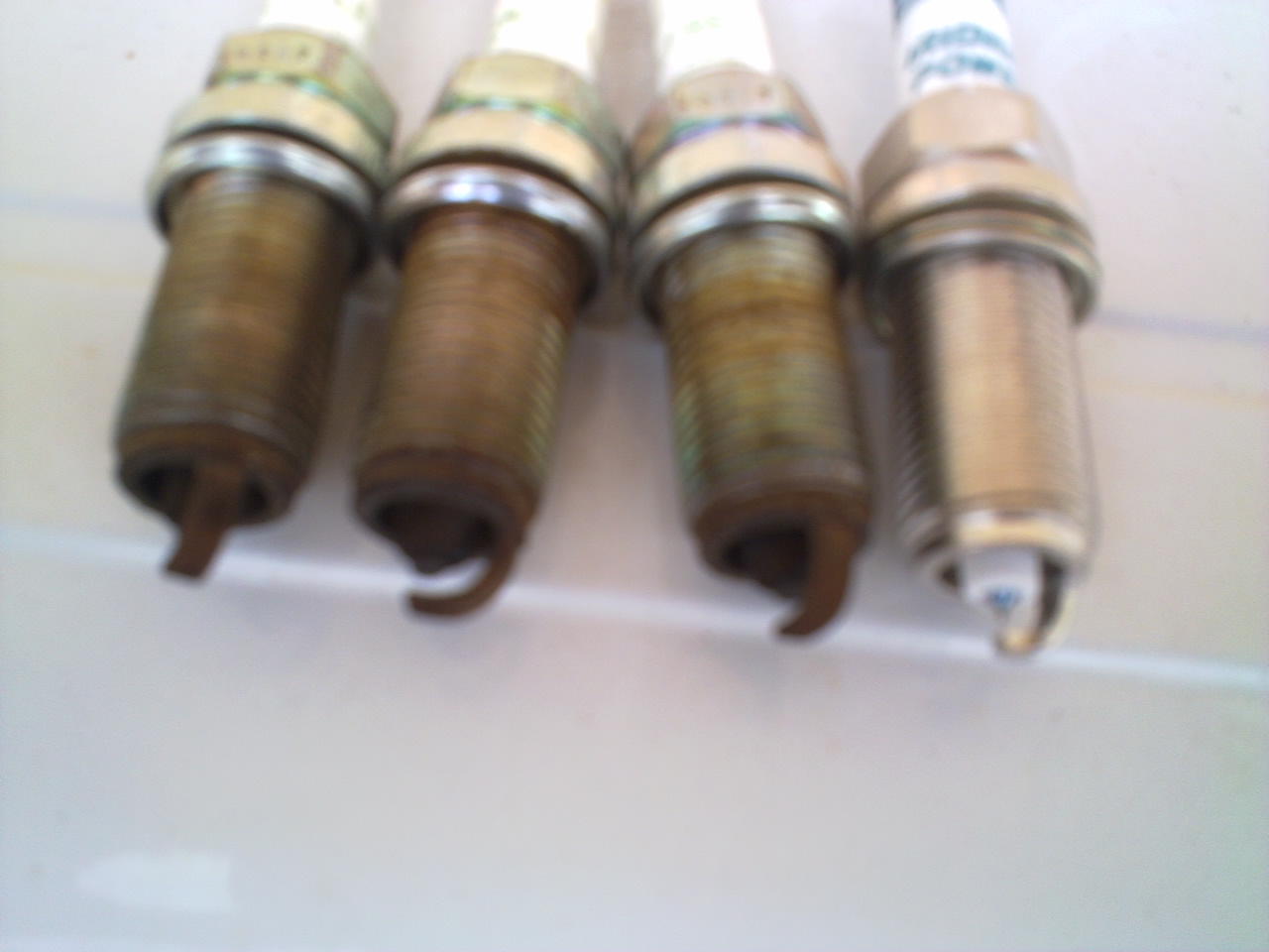

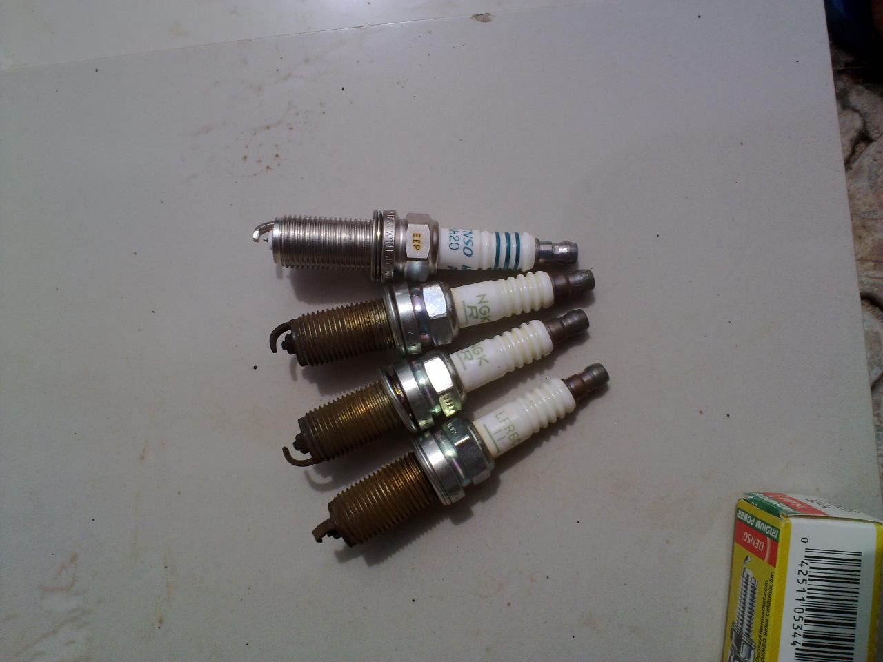

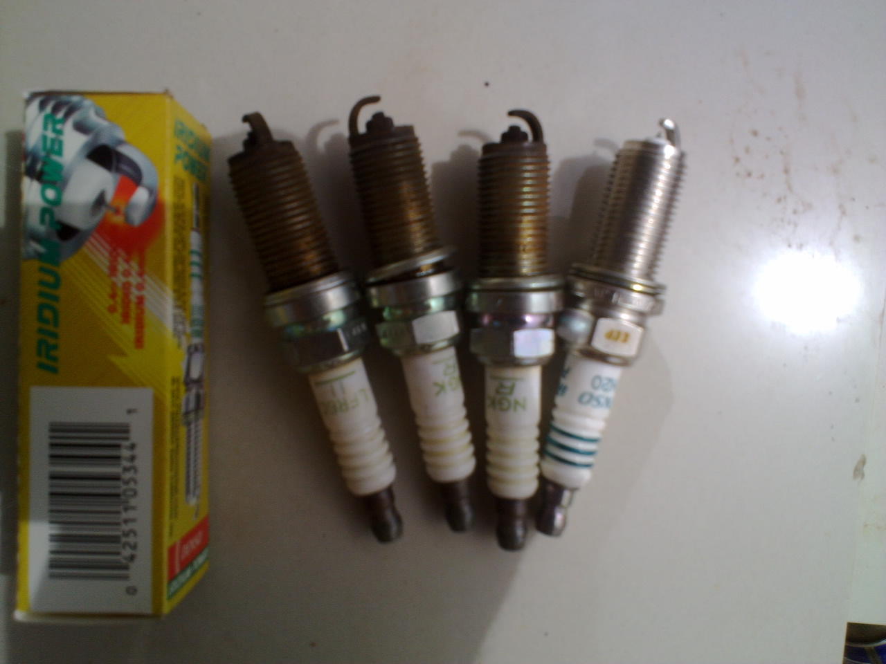

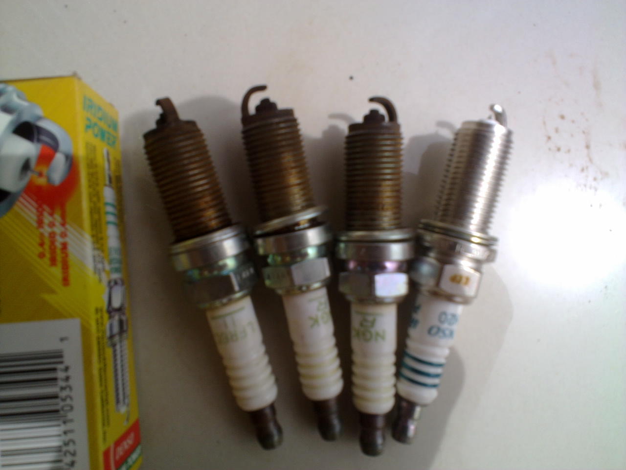

changed one side of my plugs today - the right side/passenger..was pretty easy, considering this is my first plug change on a car ever!...thanks t4r.org really an amazing site!..will change out the other side tomorrow or next wk. attached are the pics of the 3 i removed plus one brand new one...i bought the truck used july 2012 at 113k miles...now its abt 120k miles..no details on spark plug change in the maintaince history....mileage is fair abt 170 to 210 miles b4 the tank needle hits the mid mark on a full tank..trip computer says 327miles when tank is full.
when i change out the other side..will reset the ecm and see if there is any noticeable change in mpg.
nb from the pics..can some1 confirm if these are the factory plugs the truck with?

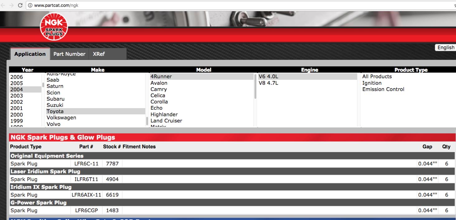

Ngk 7877
Ok, had to revisit this post cuz some of the guys on one of the Facebook groups had me scared thinking I put in the wrong plugs last week, even though I had the same NGK 7787's I'd put in 70K miles ago with no issues whatsoever! I've been going through multiple sites the past hour & finally decided I should check NGK directly. So yes, 7877's are fine direct OEM replacements. Whoo...that was exhausting!

So yes, 7787's are fine direct OEM replacements. Whoo...that was exhausting!
I went with Denso's .. but yeah, it pays to do your own research. Don't trust everything you see on FB. I rank research, forum knowledge, then FB knowledge.
