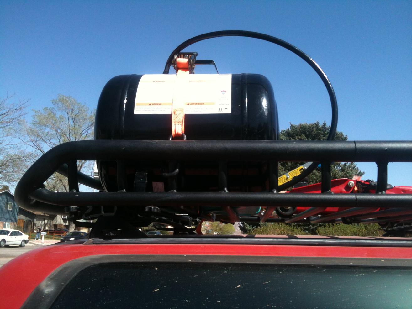

I found an old set of compressor tanks in a metal scrap pile missing the a/c compressor. Cleaned them up and threw them in the truck. I fill it to about 125 psi before going out. I still need to get a little compressor to fill them with on the trail.
P3160343.jpg~original
Here's the tank I have. I strapped it up on the roof rack. We'll see how it works up there.
