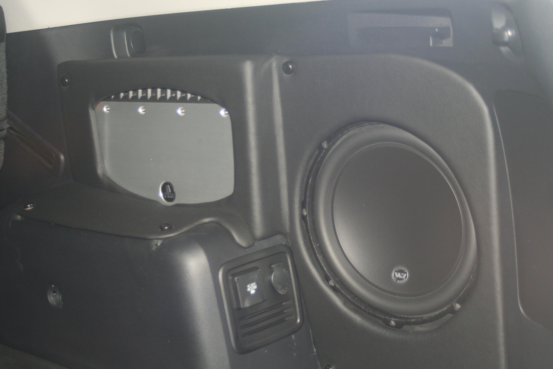

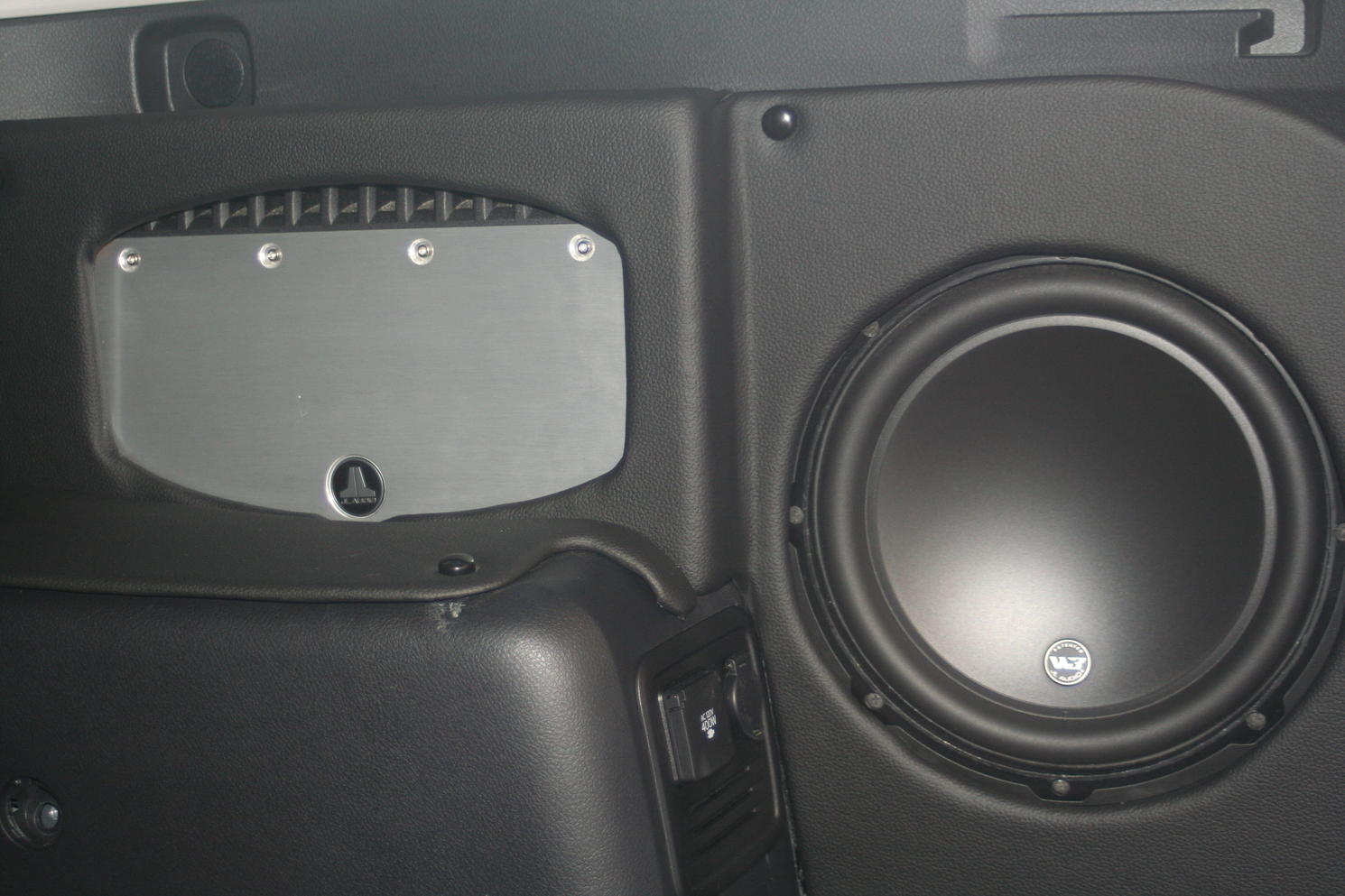

I just did Arc Audio 6x9s and a 10 inch sub in a custom enclosure on the right side rear panel. Sounds fantastic. Will take pics tomorrow
