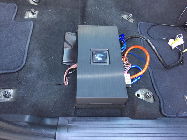

I have the same amp waiting for install! Since the front and dash are connected in Parallel (corrected! Thanks Rigtec) I'm going to just to leave them together(Channels 1&2). I've replaced the tweeters and 6x9s per rigtec and IMO they sound balanced already. The same goes for the rear doors and tailgate (Channels 3&4).
A few questions from me. Do you need a voltage adapter from the HU to the amp? What are you going to do for a sub box design?
"...Since the front and dash are connected "In-Series" I'm going to just to leave them together(Channels 1&2)..." I've replaced the tweeters and 6x9s per rigtec and IMO they sound balanced already..."

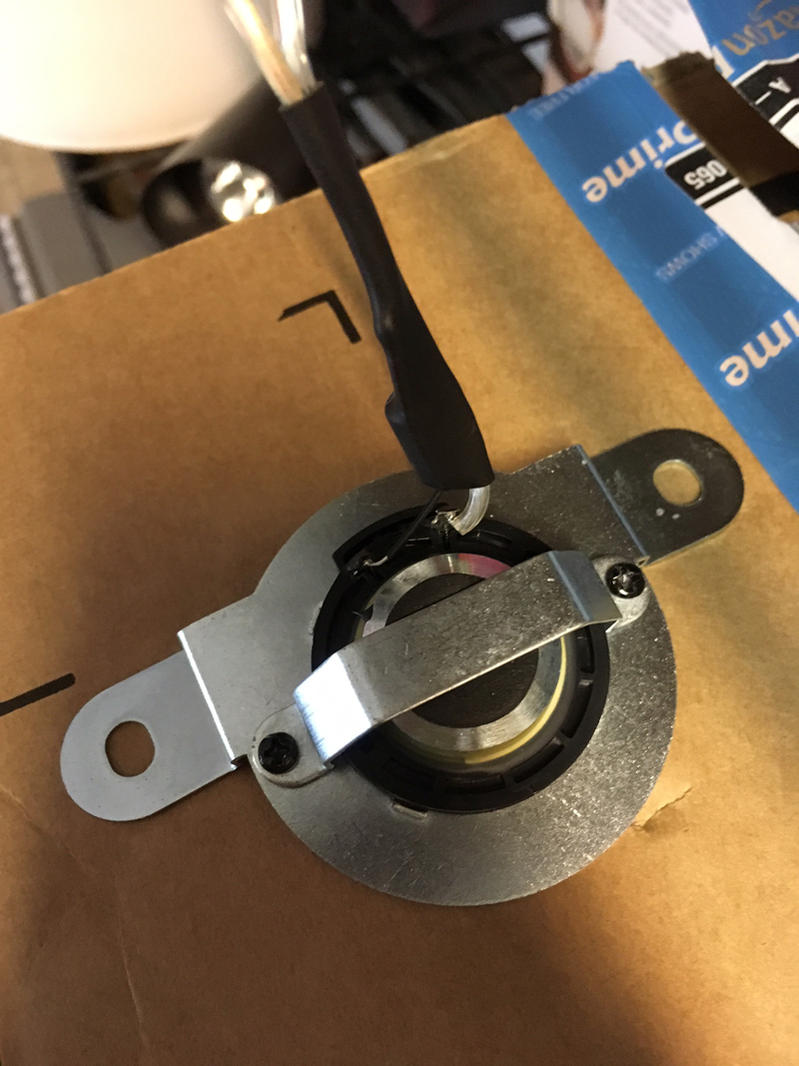

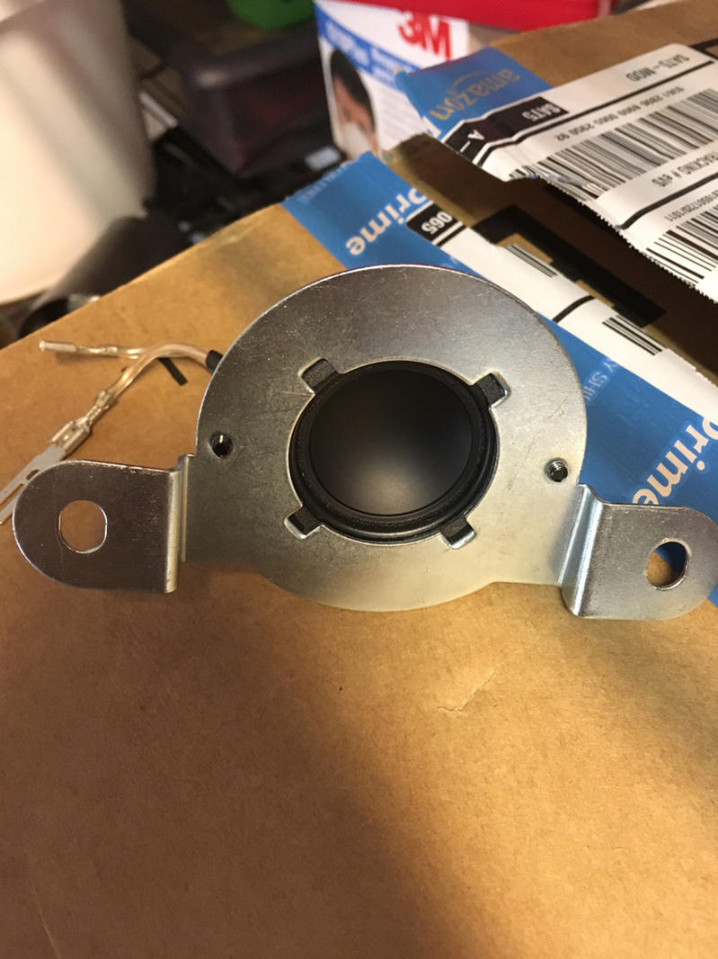

2016 sr5 premium entune.
I installed 3.5 sound ordinance speakers in the dash and kept factory wiring and factory bassblocker (little black resister in blue wiring cup.) Tweeters now sound better than stock.

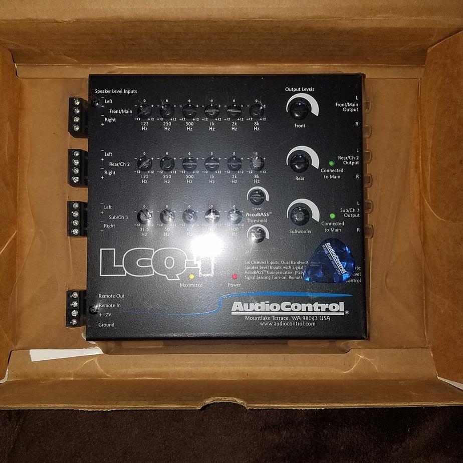

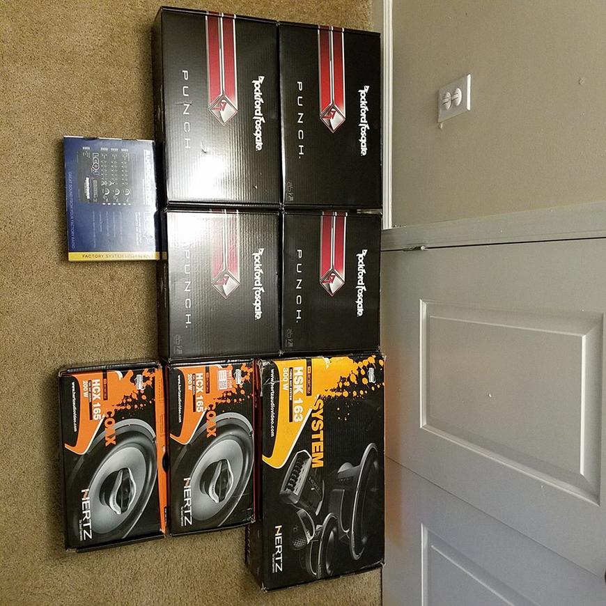

Anyone here interested in an LCQ-1? Used about a month, going a different direction with my build. $175 shipped to your door. Also have a bunch of amps and speakers if interested.
