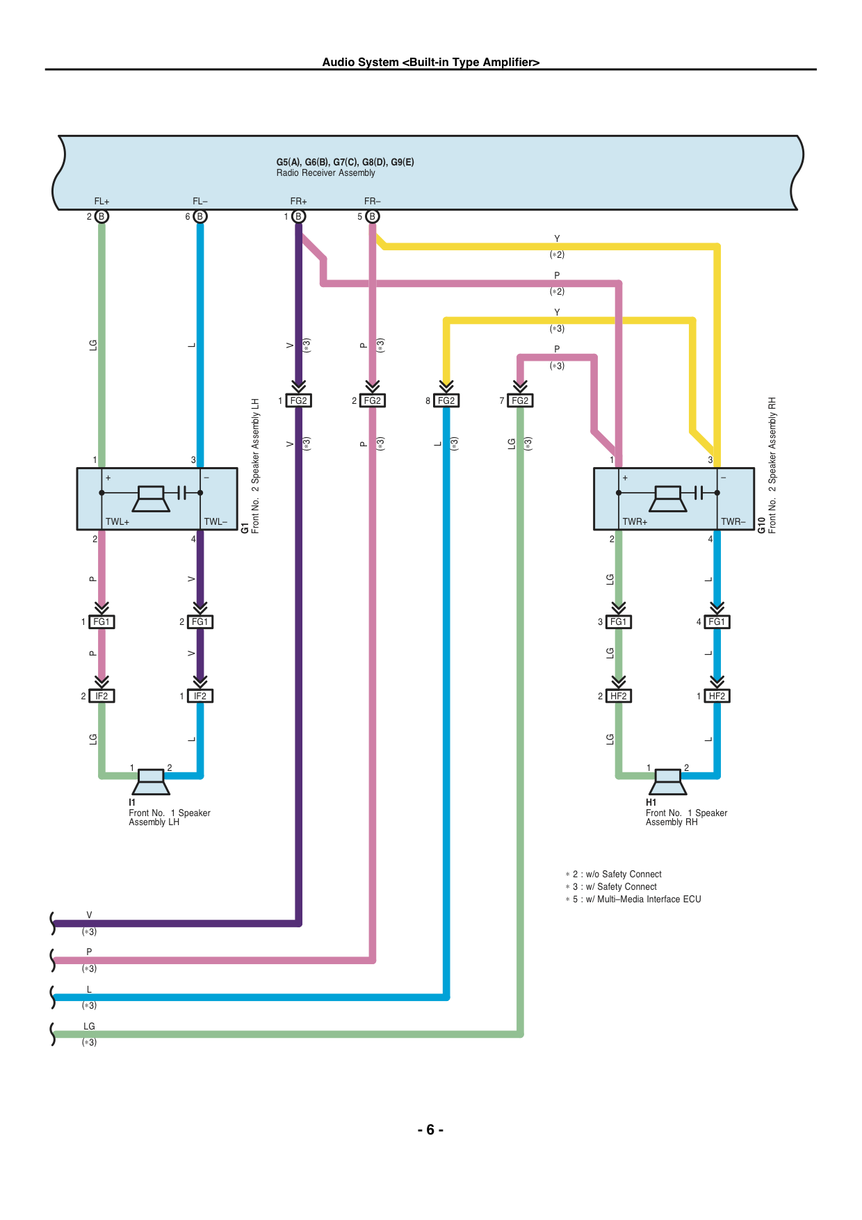

What are the + and - colors for the door speaker wires for the 2011 TE? Non-JBL. I can't find it anywhere.
As usual, a fountain of wiseassery! I also needed the rears too, thanks for the partial help. I figured it out. Everything sounds great now, those missing frequencies are back.

I put in two amps, a sub in a box, and new speakers in the front and rear doors. I tapped the pink,purple,light green and blue wires, added a high-level to RCA cable which I sent to the amp, then ran new wires from amp to crossovers, then from crossovers to front speakers.
I did the same with the high level to RCA for the rear speakers, but didn't run new wires. Just ran wires back up behind the HU and connected to original wires there.
I fed 2nd amp via the pass-through on the first amp, then ran a speaker wire to the trunk for the sub.
I have sound in the rear and in the sub but not in the front.
The light green and blue wires seemed thinner than the rest. I cut those and the pink and purple from the largest harness.
Any ideas what the problem is?
