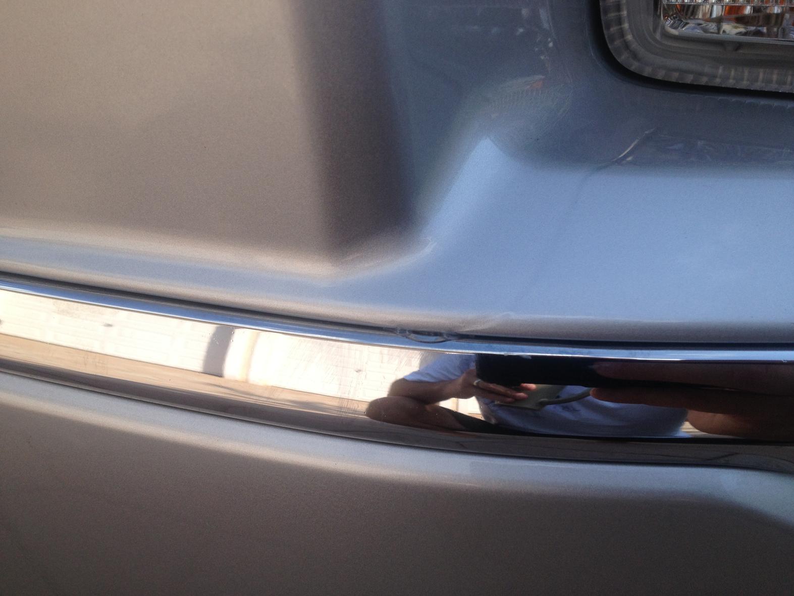

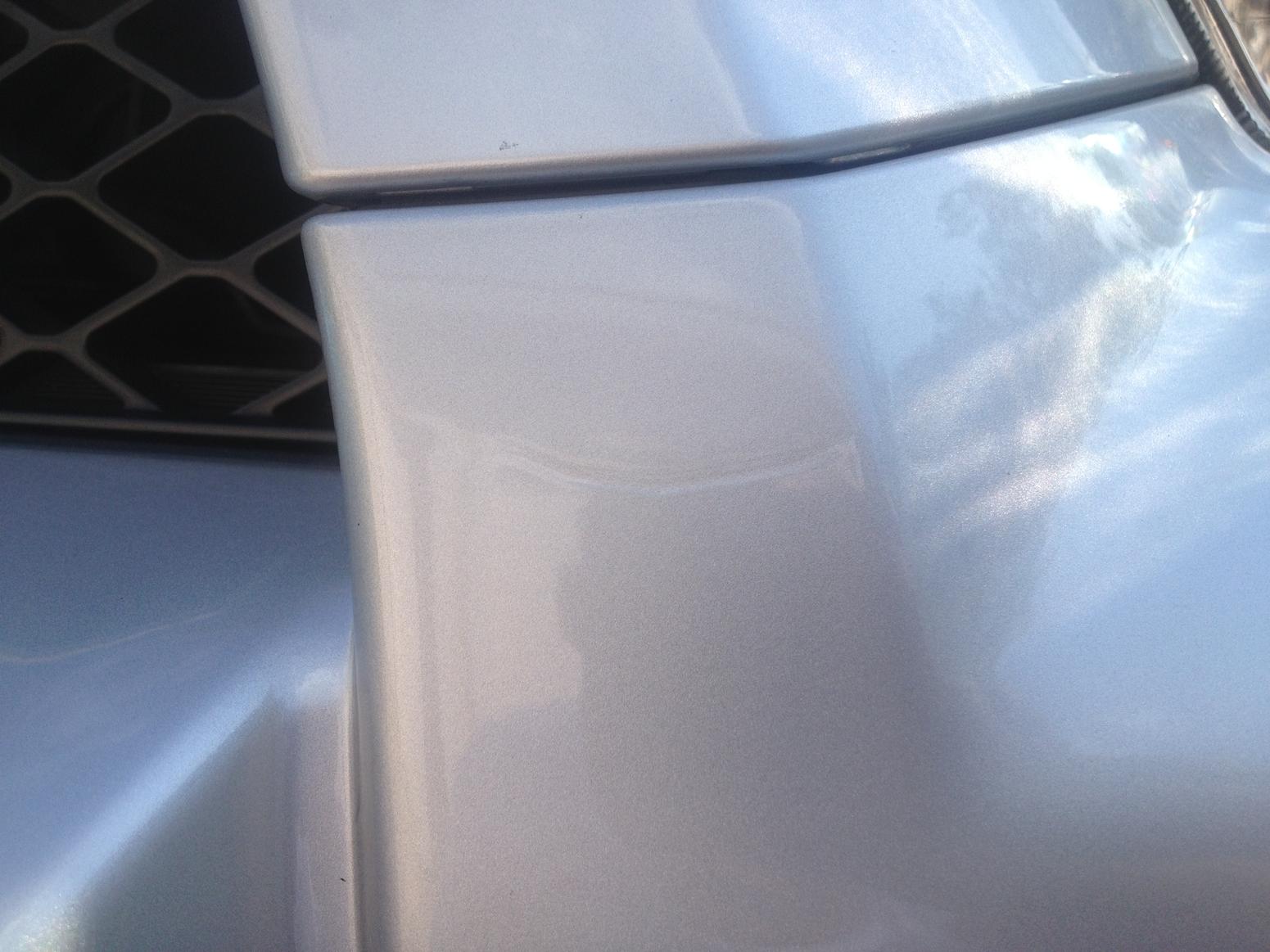

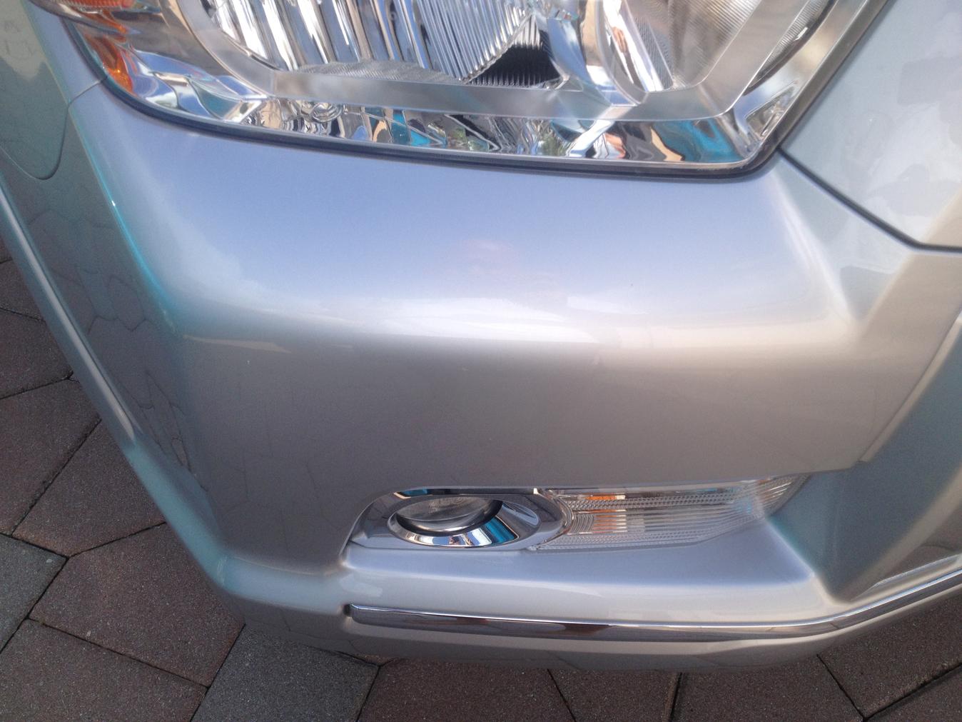

I think it works good for what it is. Prep work was and is always a PITA. I rushed the spraying part somewhat and made few mistakes but, I can always just peel it off. I don't think this product will protect from larger stones but it will definetely prevent road rash and bug damage. Few shots of my mistakes attached. 3rd photo is to show that it's completely clear, no mistakes in that area.
