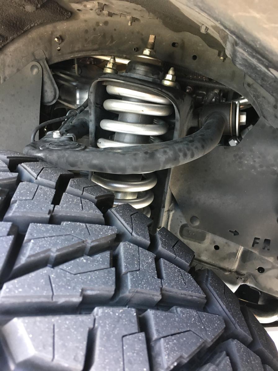

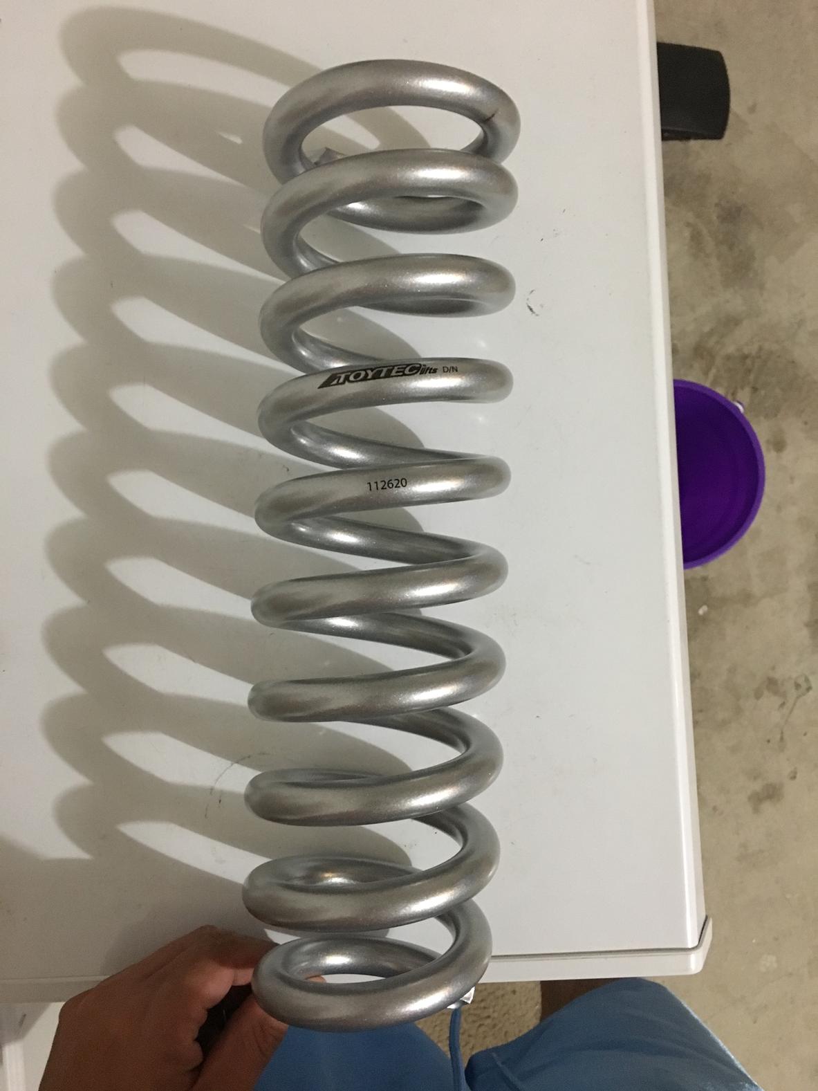

I have the same exact setup and plan to add a winch and bumper next week. Installed toytec/eibach 620lb front springs today. Set bilsteins on .85(second ring up) and the coils are 1.6" of lift. Gives you about the same lift you currently have and will support the added weight.

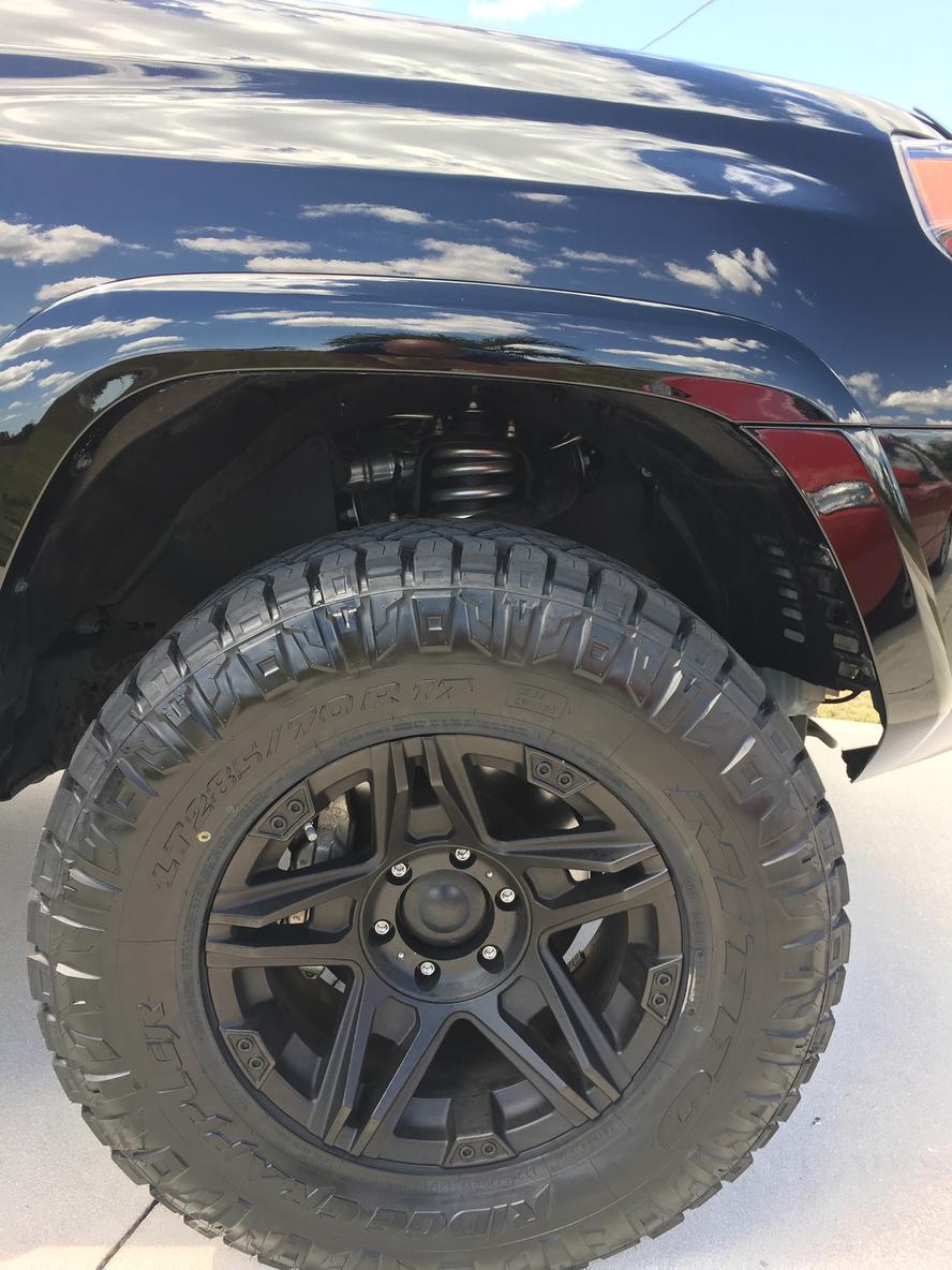

I had the coils powder coated to match the original TRD suspension although the stock rear coils were black. This is the 6112's pictured with the rear OME 2895's.
