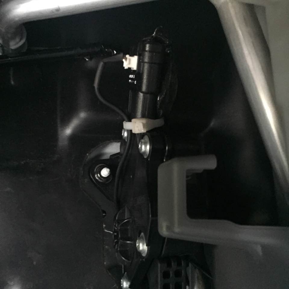

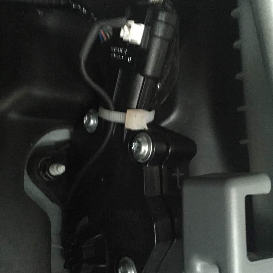

Looks like you removed your pedal. Looks much easier if you do that. Also which end plugs into the pedal, the lager end or smaller end? Thx
yes, much easier to remove pedal. It will be obvious which end plugs into what when the the pedal is unplugged. I can't remember now.

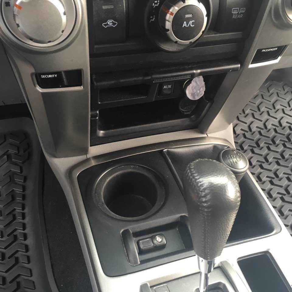

no, I drilled a small hole in rocker switch so wiring is behind dashboard. Here is better shot:
Did you pop out the center rocker and then drill it and run the wire through it and pop it back in? How do you remove it? I assume from behind under the dash. Just don't want to break it. Thx
yes, take a flathead screwdriver and pry from top or bottom and blank switch pops right out. Drilled hole in the switch cover, ran wire through it under dash to gas pedal, applied sprintbooster controller. with the double sided tape and voila.
Finally installed. Definitely easier taking the pedal off make it easier. The difference is obvious!!! Thanks for all the help.

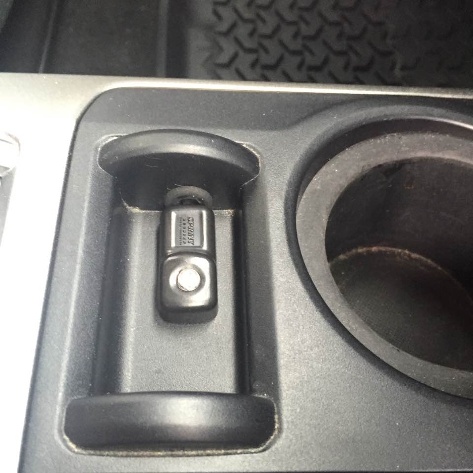

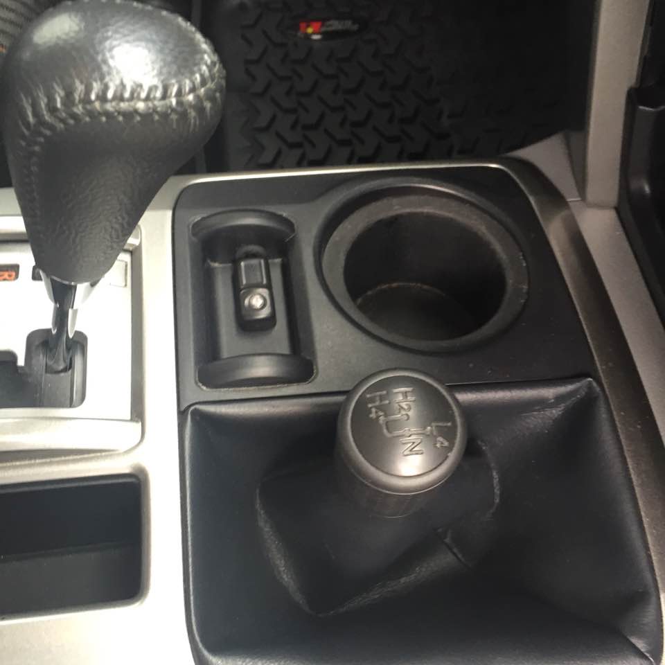

Any tips on how you ran the wire for the controller? Specifically how you opened up the console to run the wire.
Definitely take the pedal off. As you can see from the picture, I actually ran the controller wire behind the pedal because there is a bump out/ space behind the pedal and the wire is thin enough. Then I took the side panel off and ran the wire behind it and stuck it behind the carpet.
As for the console, as people have stated take the 4WD transfer case knob off and then yank the surround (silver trim) around the console and pull up. Then all you need to do is disconnect one harness and pull it off.
You can then pull the cup holder section off. I wanted the button near the shifter because if you recall the 3rd gens had the button right on the shifter. I then figured I would put it in that spot which really serves no purpose and drill a hole from the back side and got a rubber grommet and slid the wire through it.
